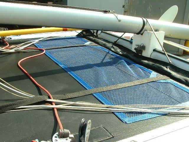

A fellow CA catsailor sent me this picture - I thought it was worthy of posting here for others to see too.

Hey! That's the one I built. Here's another:
