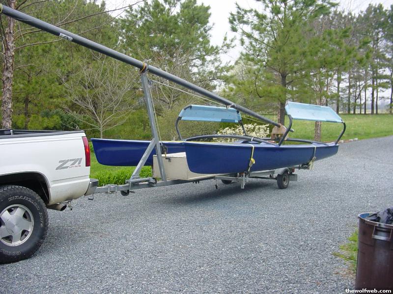

Hi, just refinishing my hulls and metalwork...looks OK. Nige, H17, Sea Duck 3, #6424

Hi, open the attachment above for a pic of the H17 in her full splendor. Nige

Nigel, Is that a windlass on your trailer? (the boat looks very fine)
