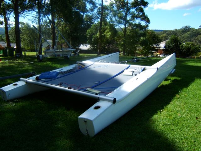

5.7 with 10ft beam and carbon rig:

The boat should hit the water next weekend (21 May) and we are expecting it to be quicker than a Tornado in nearly all conditions.
The carbon mast was made by an Aussie manufacturer who makes yacht masts and used to make A Class masts. It is the same section as the normal 5.7 alloy mast and weighs just on 15kgs rigged. The mast is really stiff compared to the std mast which suits our wide boat.
The kite Halyard attaches a little higher than a std 5.7 and we have the pole a lot lower, this gives us a kite luff length a little longer than a T, Kite area is 26 sq meters.
I would get Marstrom to make a mast but they are not cheap, another option is the Fibrefoam mast from Scott Anderson, he can make a mast to suit and they are pretty cheap. We are planning on doing the long distance races here in Australia, there are quite a few of these races spread through the season. We just wanted to make the 5.7 perform as it always should have from the start.
