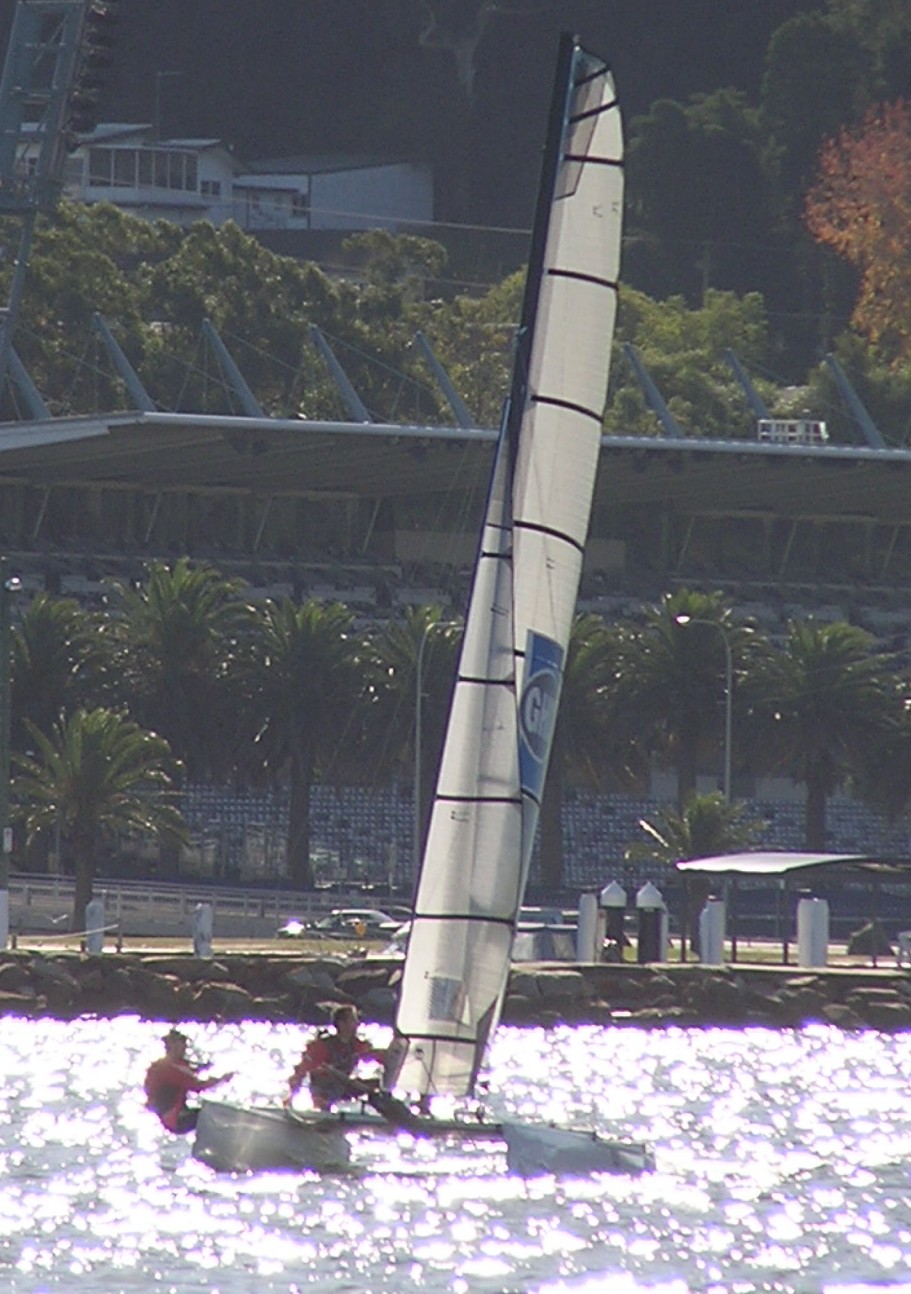

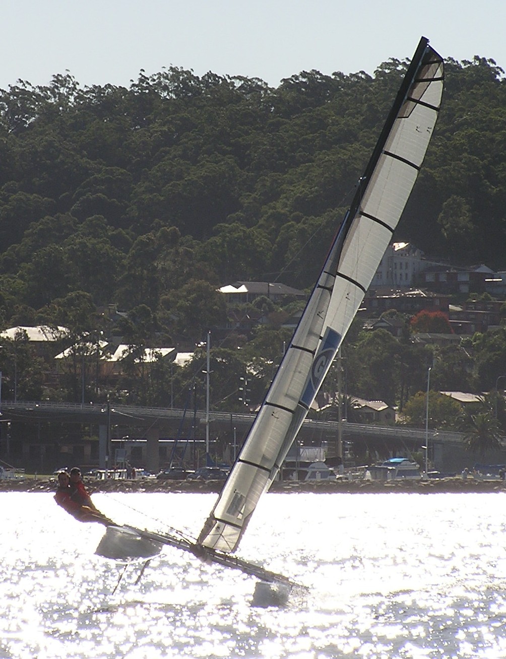

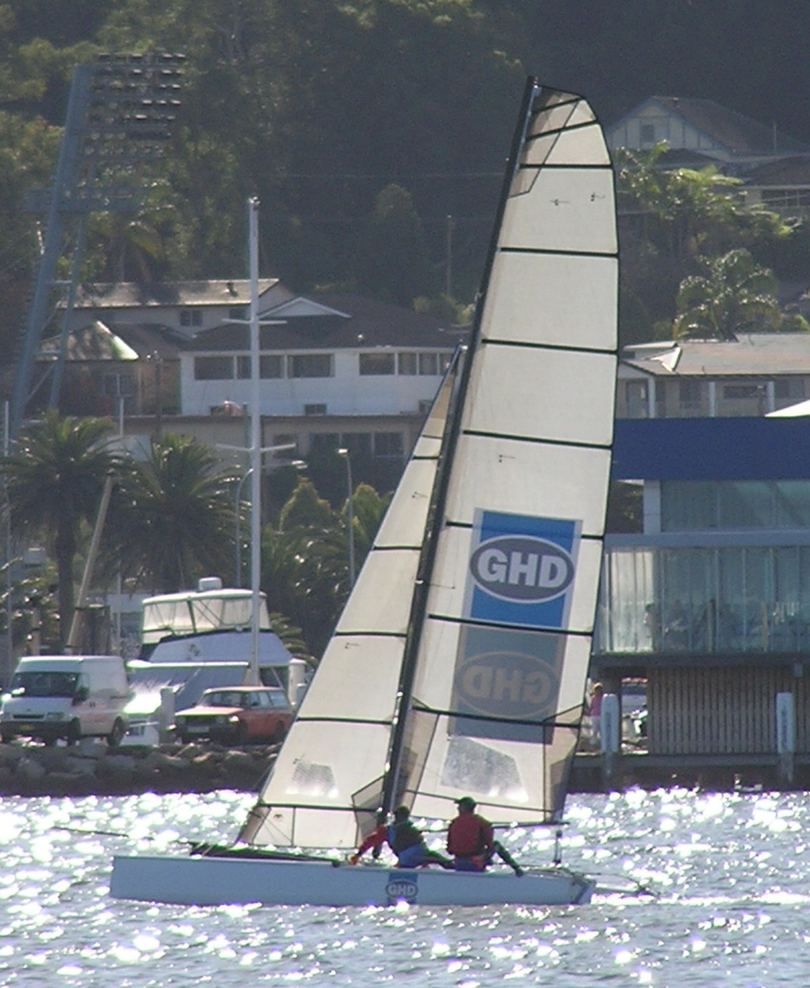

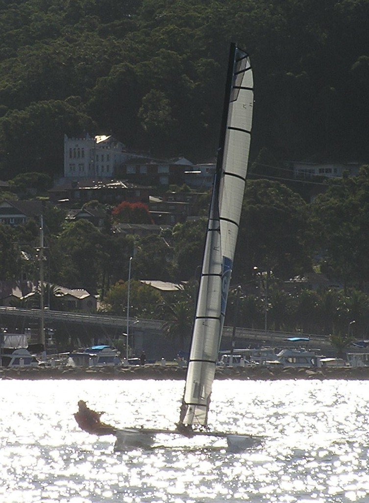

OK, here we go, pics now working

The boat looks great! What was she like to sail?

The wind was pretty light but some gusts up to 12kts so we were able to test the boat out pretty well. It is very powerful but easily transforms that into forward motion, we didn't use the downhaul all day which was interesting. All the systems worked perfectly which we were happy about considering we had spent so long working on them to make it all streamlined.
Upwind the boat is very well balanced and feels like a light Tornado, there is no noise at all (even less than a Tornado) and the acceleration out of gusts is a bit disconcerting at first, we took a few steps back each time until we got used to it..
Downwind we had a few lee helm issues which are bit shitty to steer with but we are working on that this weekend, I suspect that the rudders are not perfectly alligned which is creating the lee helm downwind (upwind there is no real load but no real feel which indicates that there is a small alignment issue). It is hard to butts the rudder alignment due to the canted hulls..
I am sailing again on Sunday so will have mor einfo next week.
