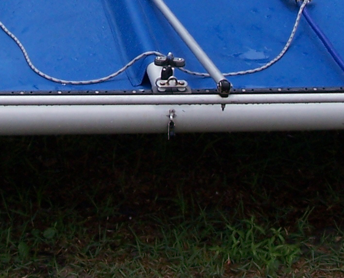

I have a single block attached to an eyestrap on the back of the rear beam too. I have no idea what it is for. I am going to change over to 1/4 like Catman uses. I do have some problems getting the traveller to play out in lighter winds. I'll try to dig up some old pictures to see if any have a shot of that block on the rear beam.

I know exactly the block you are talking about. Mine had one there too - it was riveted inside an eyestrap. I never did figure out what in the world that was for.

Here is a poor quality picture of it back when I was using a single line for the mainsheet and traveller. For those of you who don't know or can't make it out in the photo, there is a single block hanging on the eyestrap off the back center of the rear beam. Any ideas what this could be used for?

Its to create a 2:1 system on your traveler..
Your rope ties off to your traveler. The rope then goes through your pully in the center of your beam. Then through the twin roller in your traveller and into your cleat.
Posted By: Jake
Re: traveler - 03/29/07 12:10 PM
yeah, but it just doesn't work very well for that. It won't center and the block usually get's caught on the eyestrap when you tack or gybe.
3:1 actually
Posted By: Bandit
Re: traveler - 03/29/07 12:45 PM
I stand corrected
In reference to the pulley getting caught in a gybe I have never had that problem or any other problems with it so maybe your pulley is mounted differently?
