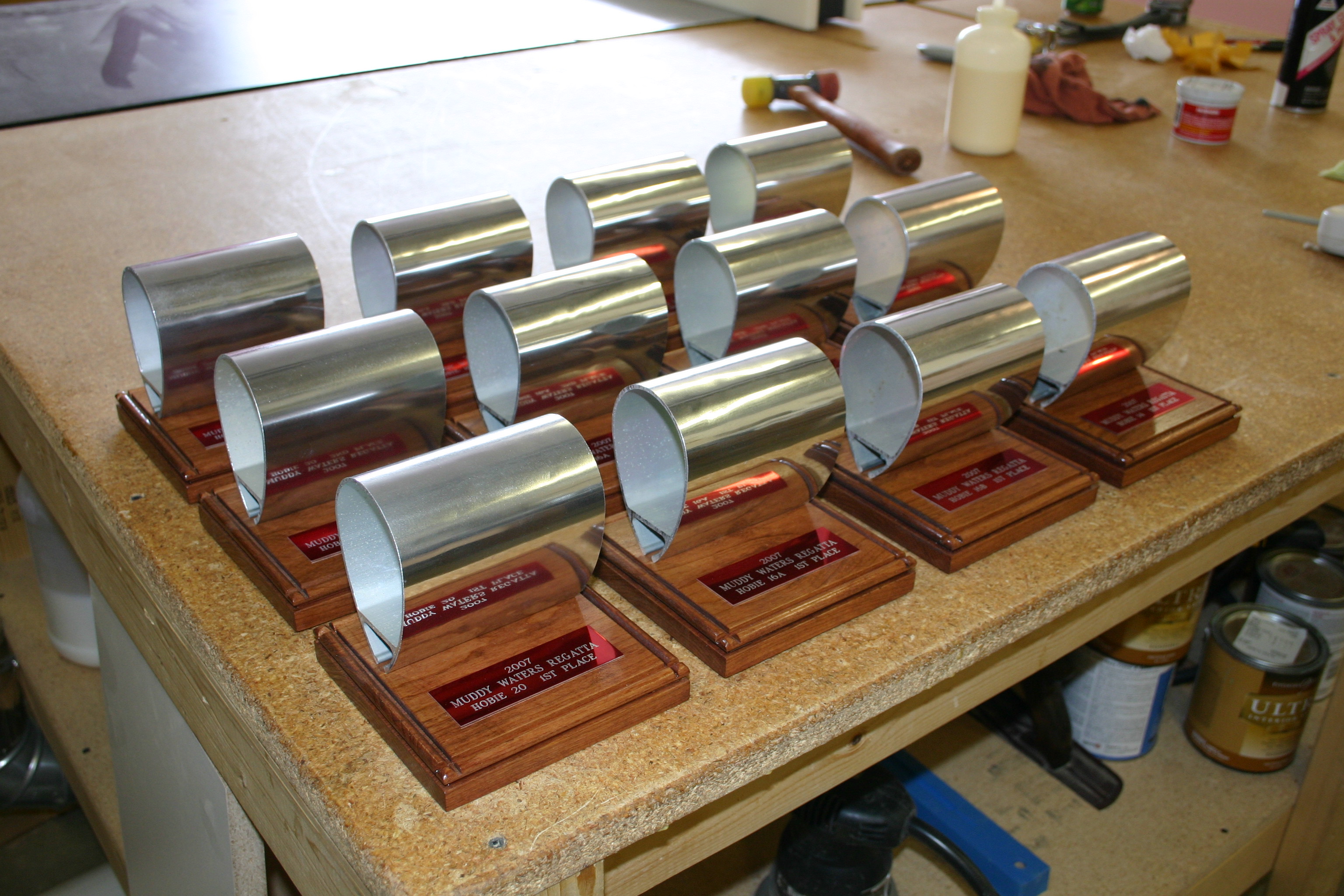

I made these last year for our regatta out of a comptip cutoff.

very cool - that was a bit of polishing!
Alot more than I thought it was going to be. It is alot of work to get the anodizing off. That was the bulk of the work.
So what did you use to remove the anodizing?

Angle grinder with a wire wheel head. Followed with 120g, 180g, 220g sandpaper with an air DA. Then a air powered die grinder with a buffing head. And lots of chrome polish. It took me and the kid who works for me about 12 hours all said and done. Way more work then I would've thought.
The crappy thing is I made trophies for skippers only. MASSIVE brain fart. A week or so before the regatta I figured this out. As a save I had some extra T-shirts made that said "I dragged my skipper into [1st, 2nd, 3rd]place and all I got was this lousy T-shirt". I thought it was a good save. Something different in any case.
This year I'm stealing an idea and making little cutting boards for cheese as trophies.
