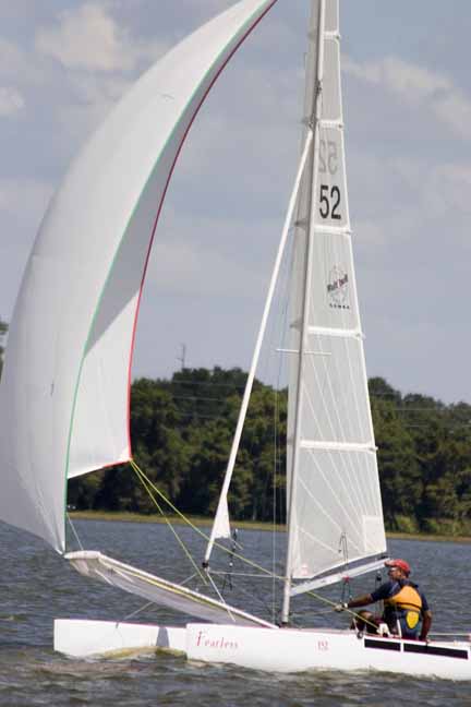

Posted By: Fearless_Rider
Re: Nacra 5.2 with spinnaker? Need help - 06/18/08 06:38 PM
something like this...

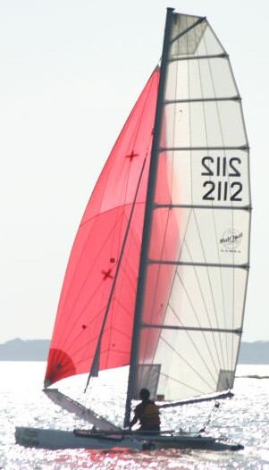

Re: Nacra 5.2 with spinnaker? Need help - 06/18/08 06:39 PM
or this...

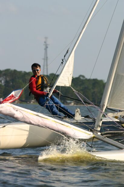

Re: Nacra 5.2 with spinnaker? Need help - 06/18/08 06:40 PM
or that...
