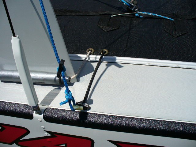

1. On the early 5.2's, how do the daggerboards get tensioned to stay up?
Congratulations on your new boat! Have you got a copy of the factory assembly manual? If not, you can download or view all the pages online here.
http://www.thebeachcats.com/index.php?module=pictures&g2_itemId=35217
Another 5.2 owner went through your same ordeal and was kind enough to help future owners by taking pictures of the details. Here's a link to the 5.2 rigging pictures.
http://www.thebeachcats.com/index.php?module=pictures&g2_itemId=35563
Attached is a pic showing the dagger support system.

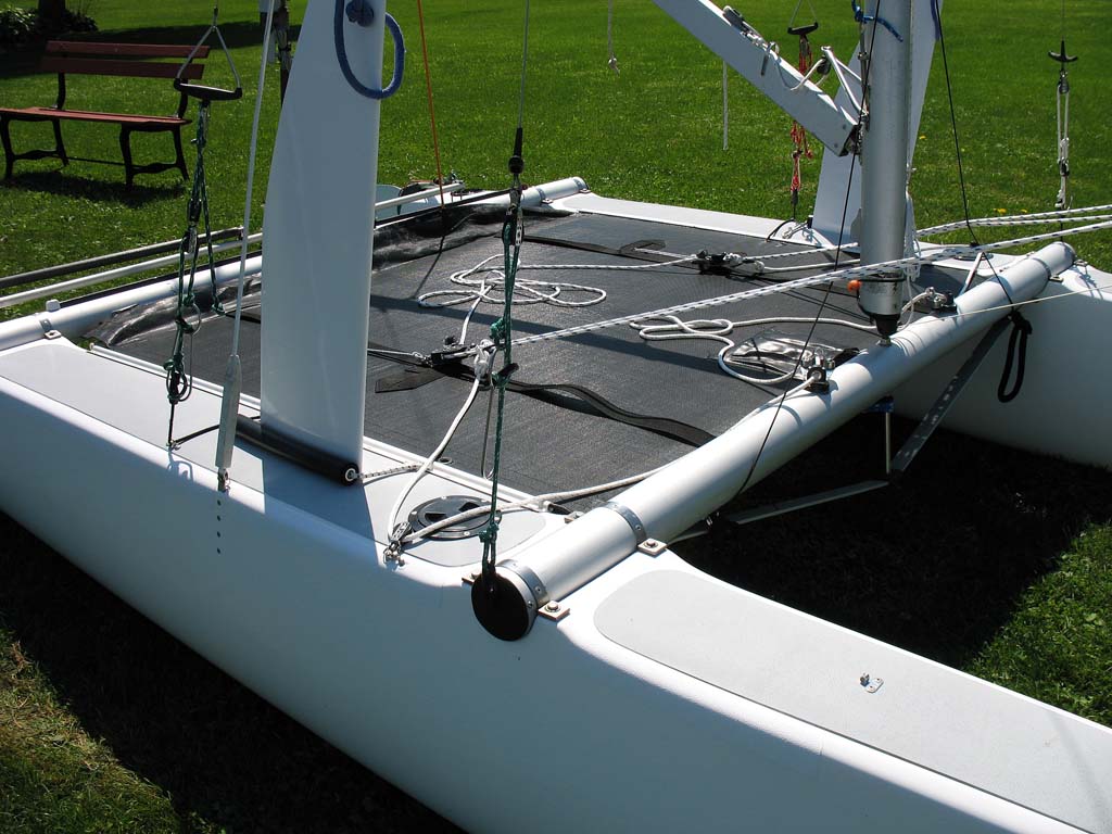

Posted By: erice
Re: Reviving old Nacra 5.2 - 10/02/08 07:41 AM
originally i think the 5.2 only came with 1 trap for the crew like the tornado
but then about the late 70's keen cat sailors started moding their boats to dual trap.
attached pic shows a 5.2 with old dagger hold up system
basically you need a small eye on the hulls and then eyelets on the tramp for the helm bungee to go through
Posted By: erice
Re: Reviving old Nacra 5.2 - 10/02/08 07:43 AM
here's another pic showing the helm trap bungee
all these pics taken off the web from nacra 5.2 searches

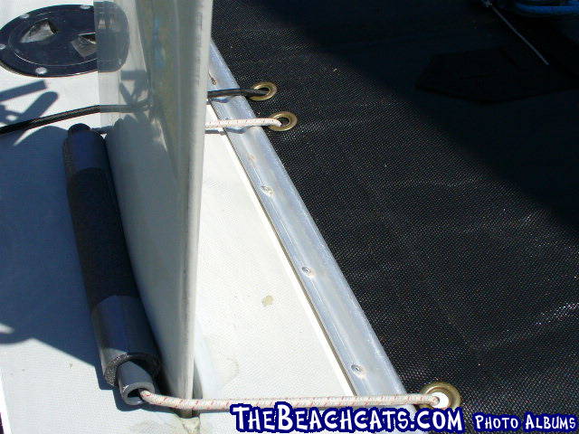

Re: Reviving old Nacra 5.2 - 10/08/08 06:37 AM
another of airborne's excellent pics attached, shows his answers to all the areas you are talking about
Posted By: tomthouse
Re: Reviving old Nacra 5.2 - 10/08/08 01:49 PM
Wow...!
Great set up for the trap line.
What is being used for the dagger board tensioners. It looks like some PVC with some padding.
Great plan.
What is it really?
Mine use only shock cord and pulling them up and down eventually saws through.

Posted By: David_West
Re: Reviving old Nacra 5.2 - 10/08/08 10:53 PM
Thanks Erice,
Dave
Posted By: airborne
Re: Reviving old Nacra 5.2 - 10/11/08 06:18 AM
Yes it is just a piece of pvc wraped in foam with some shock cord running through the groment and a stop ball on the end just under the tramp. <img src="http://www.catsailor.com/forums/images/graemlins/grin.gif" alt="" />
