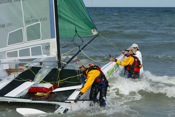

Posted By: Jake
Re: Midpole Snuffer problems with 6.0 foil? - 10/28/03 04:56 PM
The chute catches on the pelican striker as I'm trying to snuff it and literally gets wrapped around it. I've tried snuffing dead downwind, reaching, and upwind and it always blows back and catches. I'm considering moving the snuffer hoop out farther from the bridle but would be interested to hear if anyone else has tried a mid-pole snuffer on a 6.0NA. As you can see in this picture, there is quite a bit of stuff behind and above the ring.

Posted By: Jake
Re: DIY Snuffer hoop and bag - 10/28/03 06:36 PM
I've got another question too....why is it that most snuffer rigs are setup for a port tack takedown yet the hoops are on the port side (the side opposite the spinnaker on a port tack)?
After looking at photos like this, now I'm wondering why I had so much trouble to begin with. The relationship of these bridle wires to the hoop is worse than that of my pelican striker. I wonder what I'm doing wrong?

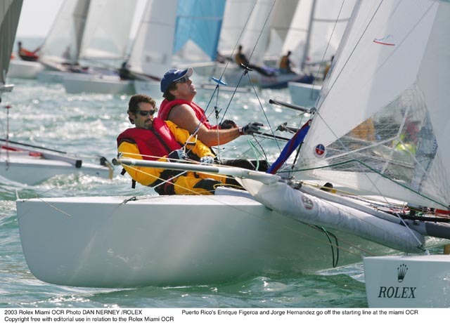

Posted By: vicatman
Re: Midpole Snuffer problems with 6.0 foil? - 10/28/03 08:22 PM
check this one out....
