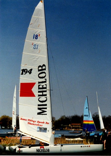

Plans are available (I think) through Gougeon Brothers plan service, but hull is really an "A" Boat design - and needs a bit more displacement to support wider beam and bigger rig. John Lindahl lives in Fennville Michigan and you can probably do a search and contact him directly. Denis Palin from Houston Texas is another who had recently build an 18 Square. Bobby Bergstedt in New Jersey might still have contact with Brad Johannson who was also a custom builder. NACRA ended 18 Square production in the late 1980's - early 1990's due to slow sales and an influx of "custom" boats. Originally they were SolCat hulls, then they moved to the 5.2 hulls at 10 feet of beam, and as the class grew, the Roland Brothers started building their own hulls called NACRA which eventually were bought out by Performance Catamarans (Frank Butler). Class sails were made by Skip Elliott, Henry Bossett and Randy Smyth - with a few home-growns ones included. Coyote molds were purchased and produced for a short period of time in Texas by Chris Kilbourn (last phone number I have for him is 214-224-8441 - work number). Not sure what he did with the molds. Gino Morelli and a few other west coast sailors did some one-off's back in the early 1980's - but never knew if they kept the molds or not.
The 18 Square IS NOT a 5.5 - or a 5.8 set of hulls.
They are specifically designed 18 foot long and the beams started at 10 feet and grew to 13 feet, then settled back at 11-12 feet. Masts were usually 30-32 feet and mainsail was 18 sq. meters or about 194 square feet. Weight of boats ran from ultra-light 260 lbs. up to about 400 for glass production boats. Class had Category 1 and 2 and raced together. Solid Wing sails were allowed and WILD TURKEY owned by Craig Riley of Calfornia was our class "poster boat". Lack of new builders also contributed to the decline of the class. Boats were either taken apart or tilted for trailering. Large fleets were located in the North East, Michigan, Virginia, Florida, Texas and California. A few others were scattered around the country - Tennessee, Carolinas, and even South Dakota ! There was also a bit of 18 Square activity in Australia and in Europe for a time. Germany, specifically, had a group of Squares as did the U.K.
As former Class Secretary I welcome any questions.

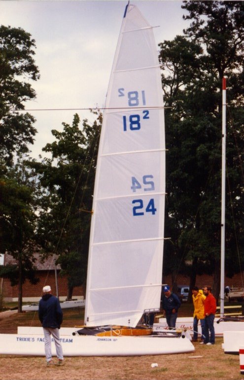

Might want to compare this attachment with the one form my earlier post. The one in above post is a "stock" NACRA 18 Square.
This attachment is one of the Category 1 boats built by Brad Johanson.
Identified in the photo -
At the bow = Fred Lemke (Then Michigan - Now Wisconsin)
At the stern left to right:
...Duane McDaniels (Pontiac Michigan)
...Chris Cordes (Jacksonville Florida)
...Bobby Bergsted (Toms River New Jersey - and the "pilot" of this square
I think I have a set of line drawings at home that I will post later. One is the NACRA and the other is the COYOTE.

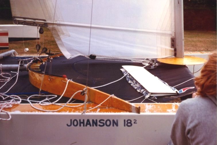

A look (attachment) of the deck of the Johanson boat. Note circular plywood plate for mast rotation, and also the steped, secondary tramp with curved traveller. Red & White stripe hulls peeking upper left is bow of Johns "old" 18 Square.

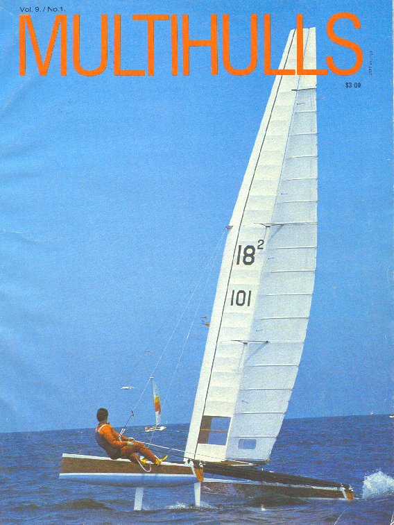

Re: 18 Sq plans - 01/23/04 09:57 PM
And of course, the 18 Square that became (more or less) our official class symbol -
Craig Riley's WILD TURKEY solid wing boat, that John finnaly managed to beat with his softsail LCD boats.

Re: 18 Sq plans - 01/23/04 10:10 PM
Hi D
looks like the pic was taken on Lk Fenton ,
Thanks again for all the interesting posts
and pics .

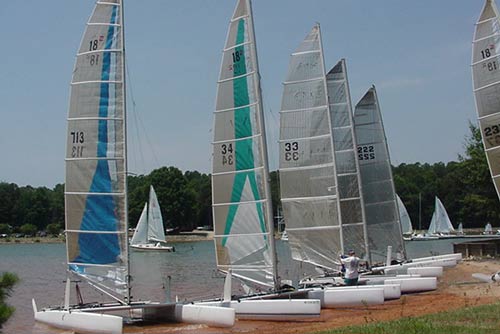

There is an 18sq Fleet at the Lake Norman Yacht Club near Charlotte, NC.
They have 10-15 boats. They usually only have 4-6 racing.
They used to travel to Regattas, but they quit several years ago. That is why I got rid of my 18sq.
The boats are all Nacras. They have all three different 5.5 hull constructions represented(stringer hulls, foam hulls, long tramp hulls).
Nacra made 18sqs from their standard 5.5 uni hulls, or vice-versa(their website says so).
The uni hulls have the bridle tangs on the outside of the bows.
I have never heard of a third category. The portsmouth only has 2 listed.
You could build a Category 1(light) 18sq with A Class hulls.
An F18HT could be converted to an 18sq.
This is another Class with no Class Association and unknown, missing Class rules.
It is a great sailing boat. When you are on the wire the visibility is terrific. The width makes it very resistant to flipping when hit by puffs.
I trailered mine disassembled. I could assemble it alone, and be in the water, in less than an hour.

Re: 18 Sq Fleet - 01/24/04 03:14 AM
I have always wondered how they managed the wing sails. I would surely be afraid that a capsize would damage the wing.
Also, if it was parked on the beach with the wing up, did the owner get any sleep at all ? I would be very afraid that a gust would hit the boat and capzise/damage it. Raising/lowering the wing every time like the C class ?

Re: 18 Sq Fleet - 01/25/04 07:19 PM
The "wing boat" never (to anyone's memory) came close to tipping over. While the softsail boat masts ranged in the 30-32 foot length, the wing was right around 28 feet. Also with the controls, Craig could "power up or down" simply by changing the camber in the wing. Given the platform weighed less than 300 lbs. the wind forces simply were translated in forward speed.
Between races at regatta the wing was allowed to swing free. Since it is symetrical, equal pressure on both sides, so no violent thrashing about like a soft sail. Remember, the thrashing on your softsail takes place because the wind is on one side, then the other causing camber to flop back and forth!
In the evenings, the boat was simply laid on it's side with sail tip on an old (ugly green vinyl) kitchen chair. If weather report indicated bad weather or rain, the sail was just detached from the platform and stored in the covered trailer used to haul wing, hulls, etc.
The Square - both wing and softsail "loves" to park between races. Travel out, sheet in and push tiller away. The boat just sits there. When ready to bail out to start, simply pull tiller towards yoou, the bows swing away from the wind, and sheet traveller in. While parked, it was an enjoyable platform to sit on between races. No banging around on the waves, no flapping jib or main, and no bouncing around with the hulls. Until you have sat on a wide platform, it is hard to describe.

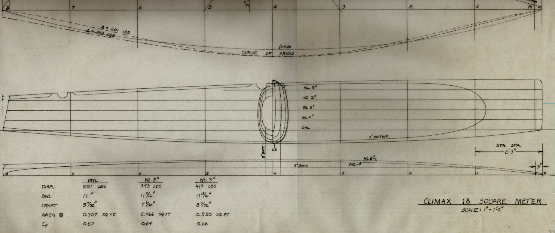

Here is a set of line drawings for the CLIMAX 18 Square. Also will post similar of the NACRA.
Sorry - no info on how I got these or who needs to be credited for drawings.

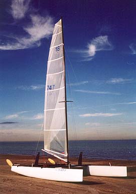

Steve,
As Tami suggested it could very well be worth your while to talk to Dennis Palin.
He did design his own square.
He built it from 3mm okume ply sheathed in 4.7 oz carbon. I suppose you could call it a carbon hull , with a ply core instead of foam. Carbon beam and even a carbon striker.
I think the hulls came out at 52lbs each and very strong.
Dennis was good enought to allow me to post some construction pics and of course a couple of shots of the finished craft on my web site.
There is a pic of Dennis's creation in the attachment.

Posted By: eidietis
Re: 18 Sq plans - 01/26/04 06:53 PM
I have one of the few 18 square Coyote catamarans. Recent posts about the squares motived me to try to chase down Chris Kilbourn who was the last person known to build one. I finally found him and he indicated that he has one and it is questionable if any more that exist other than his and mine. Contrary to earlier posts, the tooling still exists in Traverse City, Michigan and additional hulls could be built. I have yet to have mine long enough to assemble it but when I do I will post pictures.
Bruno
Posted By: eidietis
Re: 18 Sq plans - 01/26/04 06:58 PM
Nice picture of boat but construction pictures did not come through. Would you please attempt to repost.

Re: help 18 lines drawing - 02/11/04 12:21 AM
http://www.catsailor.com/bb_files/28263-smnacra2.jpg
Hi John hi Steve
There is the post that Dick L provided earlier on the N 18 SQ basic lines . hope that helps
