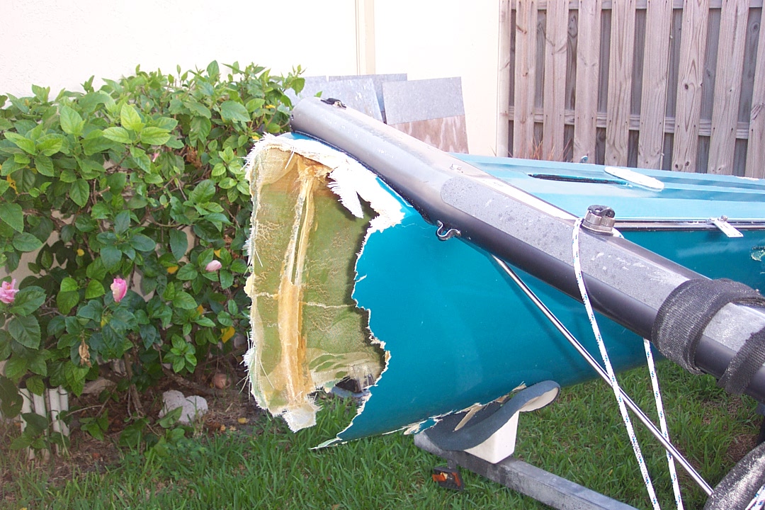

Or, you could gently place it IN THE PATH OF A SPEEDING POWER BOAT! That will get things going in the right direction for ya....

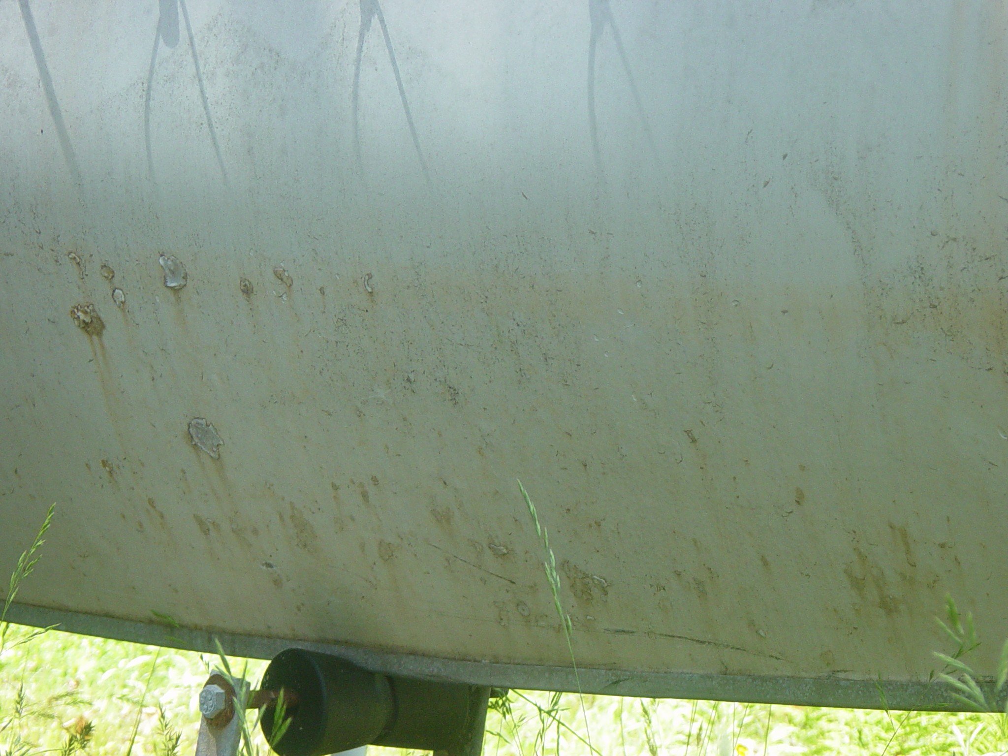

This is what im talking about with the hull.

Is it really soft in that spot? It doesn't look like much of a problem to me. Mine has some crazing and nicks/dings too but still works great.
But hey... if you're getting rid of the boat I'd be interested in some parts and stuff from it. Especially the cross-beams

syco,
the soft spot is on the top.
