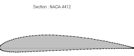

I'm thinking of building my self a set of new daggerboards.
I don't understand mutch about Profiles, but I'm thinking of using a asymetrical profile like the NACA 4412.
what are the recommandations? state of the art profiles?
Any expiriences?
Posted By: Clayton
Re: New Daggers - NACA Profile? - 10/05/04 02:17 PM
When using a asym. profile the downside is the windward board will always need to be raised. The lift generated by this profile will be in one direction. The two will oppose each other if they are both down.
