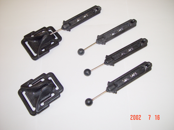

Posted By: Steven Bellavia
Re: New Rule 40.2 Quick Release Harness??? - 11/04/04 10:05 PM
Hi,
I've used the "Ball & Socket" system for about 20 years now. It's nothing new. (see photo attached) I like it much better than the hook as there is no metal to hit you in the teeth or eyeball when not using it and you don't punch a hole in your boat climbing back on after a capsize. As it applies to this discussion, it is probably no easier or harder to release than the hooks. However, it seems to me either is adequate for complying with rule 40.2
Steve
Hobie FX-1, Sail# 211
Posted By: Mark Schneider
Re: New Rule 40.2 Quick Release Harness??? - 11/04/04 10:54 PM
Hi Steve,
As you note, both hook and ball systems have been around for years... So... I assume that these system are not sufficient for ISAF. Otherwise, Why would they have put forth the rule.
Perhaps, they are only addressing the continuous systems that have you permantly attached to the boat (as noted above) However, if that were the case, you would think they would have been explicit in their rule making.

--Quick Release Products--
Sea-Sure Quick Release Trapeze Hook
RWO Quick Release Trapeze Hook
Bethwaite Keyball Trapeze System
