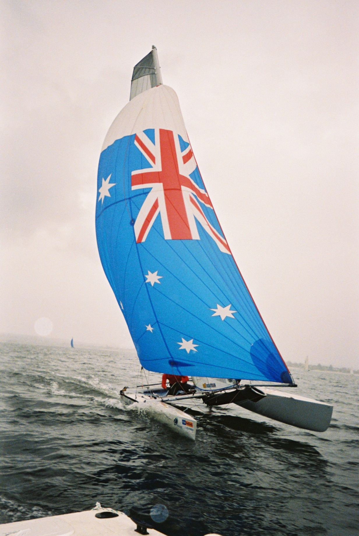

The Bull 9000 I race on from time to time has an outline of a bulls head and horns in marking pen. Simple, quick and looks ok.
More expensive option would be to get it cut and sewn into the kite.
see attached
Posted By: Tornado_ALIVE
Re: Logo on spinnaker - 04/23/05 05:46 AM
Or glued together
