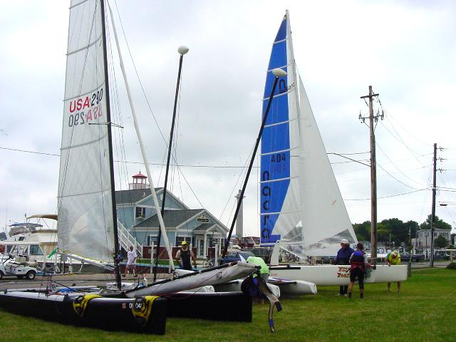

$1300 is for the main only. The jib runs about $500. Thrown in some battens, and you are looking at around $2100 for a complete set of sails (this is what I paid about two years ago).

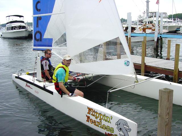

another image

Thanks Jake, I should have realized you were answering the original question from a racing standpoint. I notice you are, in the pictures, using pinhead rather than square top sails. Is there a reason for this? I should have mentioned earlier that the prices quoted by Calvert were for square top although I'm not sure it affects the pricing. Is there any advantage, in your mind, to factory built vs. custom built sails? Or vice versa. I would assume they are using the same materials........

The pin head (pictured) is the Nacra 6.0NA class sail. The 6.0NA came about just before the square head "age". In order to be class legal, for racing, on the 6.0NA you must have the sails supplied from Performance Catamarans....i.e. pin head.
Square head sails offer some performance gains over pin head - but most existing catamaran classes have yet to adopt them for a lot of reasons. EXACTLY why the square head offers an advantage is up for some debate (watch what I just started) - but it certainly allows you additional power up high that is easy and somewhat automatically depowered as needed. We even see monohulls beginning to adopt the square head main sail (did you see the last America's Cup?).
From a sailmaker's view point, getting a square head main sail to function properly can be tricky and it not only involves careful shaping of the sail up top, it also involves precise batten tuning nearest the top of the sail.

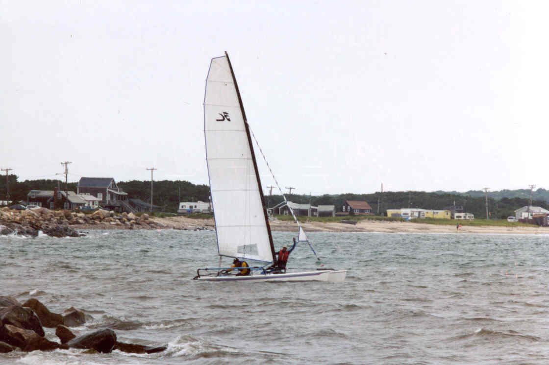

Re: Sails - 09/07/05 05:24 PM
Here's a pic of my Calvert boomless dacron squaretop on my H17

Hey Brian, is that the 5.5 weight? Or the 5.0? Are you happy with it?

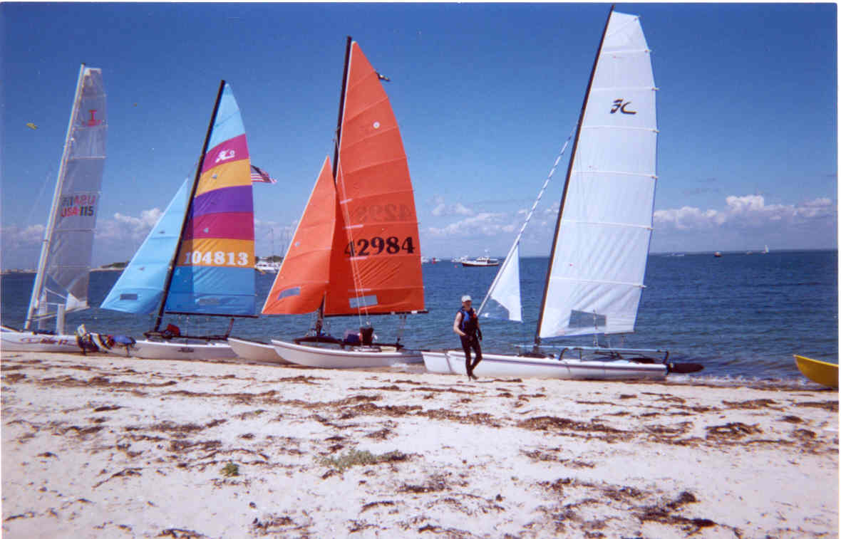

Greg, Sorry I don't remember! When I ordered it, I said I wanted durability for "Fun sailing". I originally ordered it from Murray's, where it was advertised as coming with a window. It did not. I sent it back to Calvert via UPS the first winter, for bolt rope repairs,(no fault of theirs) and the window. I don't remember if they charged for the window, but thought they were very reasonable. They also left out the jib downhaul cleat, which Murray's later sent for free. I am very satisfied so far, though they've really only seen about two seasons worth of sailing.

Thanks Brian,
That helps alot. I wish you could get that "durable" sail (I asked for the same thing with the same parameters) in colors....... That is my only hesitation at this point.
