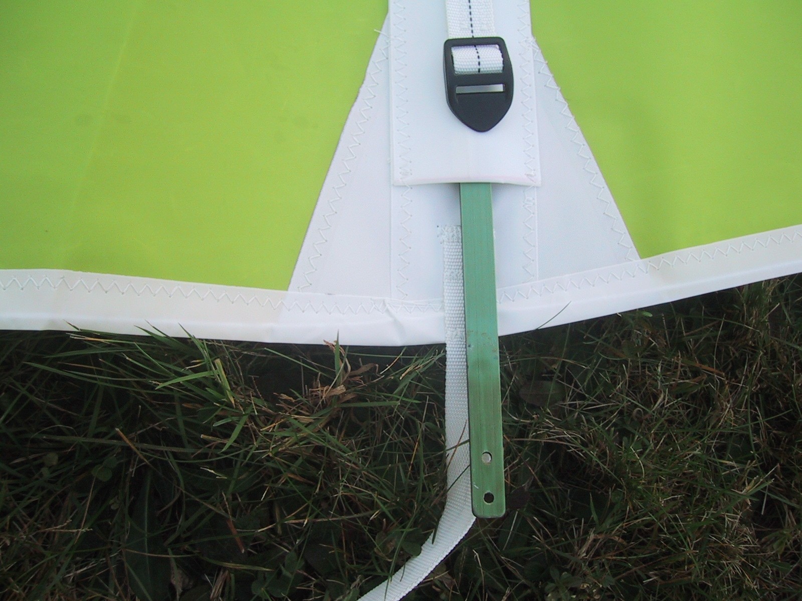

Just got my NEW Calvert Square Top mainsail and am re-using the old battens but the new sail came with webbing and a buckle that I'm not sure what to do with. I am guessing I need to purchase something like the RBS Batten Tensioner that fits up into the pocket and trim all the battens accordingly (down) and then tighten up the straps.
WTF?
Second question is what is the thin line sewn into the leech that extends out the foot for? It's like the thickness of battening tensioning line. What does that attach to? What is it's purpose?
Thanks.
Greg

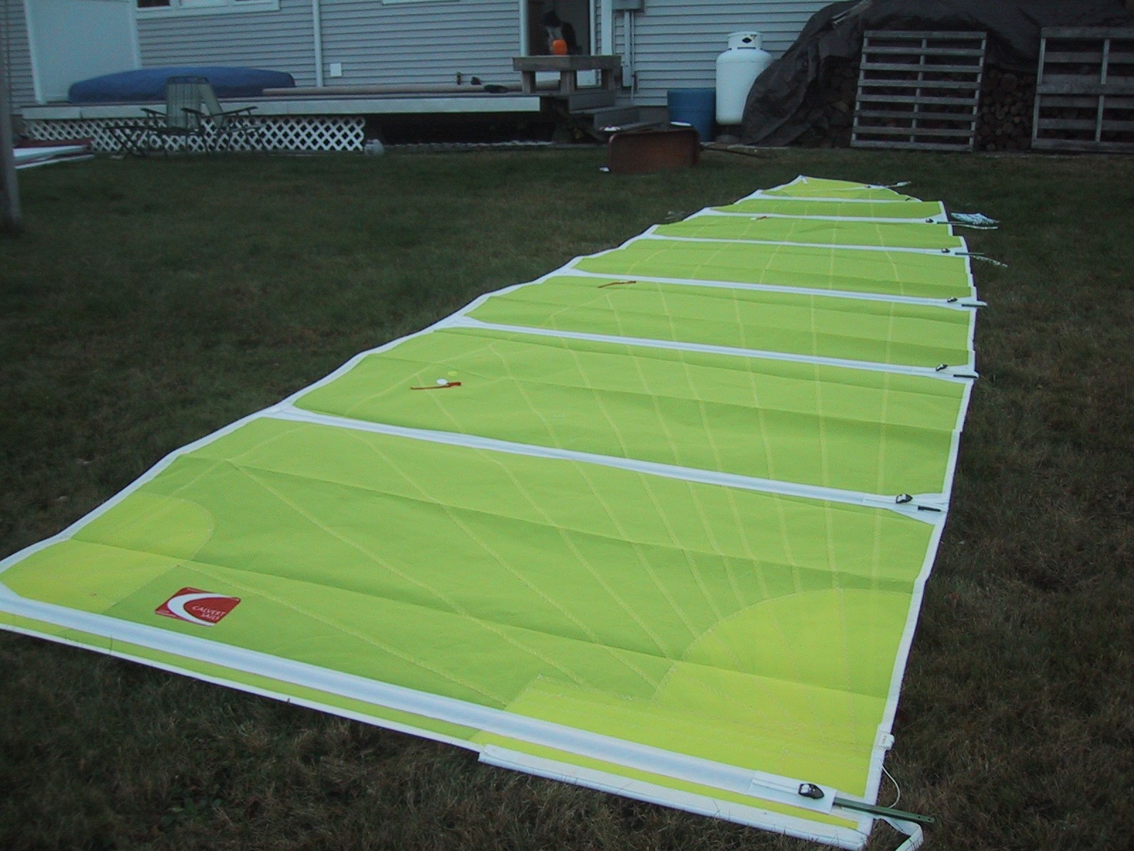

Picture two

Posted By: Rolf_Nilsen
Re: Nacra sail batten leech cap question - 11/05/05 10:17 PM
You need to put a head on the battens, where you can thread the webbing trough. Then you can tension the webbing and trim batten tension. This is a common system on windsurfers..
Perhaps you should call Calvert and ask them for some fittings, or try Sailrite.com
The leech line is for trimming your sail. There is probably a small cleat or something you can secure it to. It lets you control your leech better, and is very common on larger boats. First time I have seen one on a fully battened square top for a beachcat tough.
If the leech start to flutter, you should tension the leech line enough to remove the flutter. Leave it by if it doesn't flutter. If Calvert got the luff curve right, you should not need it unless you downhaul max and really open the leech.
Interesting picture where the sail is lying flat on the ground. Looks like the draft is designed into the luff-curve.

If the cloth in a radial cut mainsail like that has stretched enough to warrant using the leech line, I would personally consider the sail only fit for cruising afterwards.
All sailcloth detoriate over time, but a radial cut sail should be more stable than a crosscut sail (like the Hobie 16 design). When the time comes to use the leech line on this sail, I guess the profile and draft position will be in the wrong position as well. Something to ask Calvert sails about if you contact them for some endfittings for the battens (I would like to hear their reasoning for installing a leech line on this sail)..
After this discussion, perhaps you could do a photo when hoisted as well. Preferably from behind, and from below upwards. Give it some mainsheet and downhaul before shooting (but get the endfittings for your battens first).

You shorten your battens by cutting off a few inches of the back so you can wrap the strap around the back of them and through the buckle. No need for caps or anything. Then you just tighten the strap to create more batten tension - it's a great system although I had some issue with the strap getting fuzzy and wouldn't release from the buckle.

I can't see how you could use these battens and this strap and buckle system without endcaps. The width of the battens (1/2 inch) and the play in the pocket would allow easily for the batten to slip off the strap it seems to me. I would think you would have to have the strap go through a slot in the end cap to make the batten captive. I've been wrong before though!

I can vouch for Jake's advise. Trim the battens short enough that the strap wraps over the end, and tighten the strap/buckle. The strap will deform enough to wrap around the ends of the batten and hold it firmly. I've had a couple of mains with the same setup, and never lost a batten.

I agree with Jake. The strap will deform to make a pocket to hold the battens in place. Plus on mine, the pocket on the sail was sized for the battens so they didn't move.

+5 on Jake's advise. However the battens need to be trimmed so that not much is sticking out the end of the sail. Of course don't trim them so much that you can't get enough batten tension.
