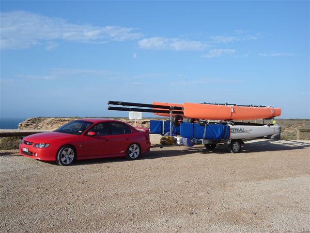

Posted By: C2 Mike
Re: trailering - 04/13/06 10:56 PM
"I use 15" car rims on mine. Went to a wrecker and found 3 mag wheels with good tyres for $25 the lot"
I don't know with a light weight cat trailer if it makes much difference...but for trailers in general you are not suppose to use car tires because the sidewalls are too flexible in comparison to trailer tires.
Bob
The average car tyre will have a working load of approx 1200 lbs and my trailer weight is around 1000 lbs per wheel so the loadings will be similar. (I usually have 2 boats and all my stuff in the trailer). You should use a tyre designed for whatever load you are putting on it.
Tiger Mike

Posted By: Seeker
Re: trailering - 04/14/06 02:27 AM
"The average car tyre will have a working load of approx 1200 lbs and my trailer weight is around 1000 lbs per wheel so the loadings will be similar. (I usually have 2 boats and all my stuff in the trailer). You should use a tyre designed for whatever load you are putting on it."
Hi Mike
It's not so much the load, as the flex of the sidewall...from what I have read on the subject, the sidewalls are much stiffer on dedicated trailer tires which helps to keep trailer sway to a minimum...granted this is a much bigger issue with a heavy utility or power boat trailers.
Bob

Posted By: C2 Mike
Re: trailering - 04/14/06 05:56 AM
Hi Mike
Bob
Well I used the above rig to travel from Melbourne to Perth 2400 miles (each way!) at Christmas just gone with not so much as a puncture. The photo was taken at the Great Australian Bite after about 18 hours of driving when we stopped for fuel.
Tiger Mike
