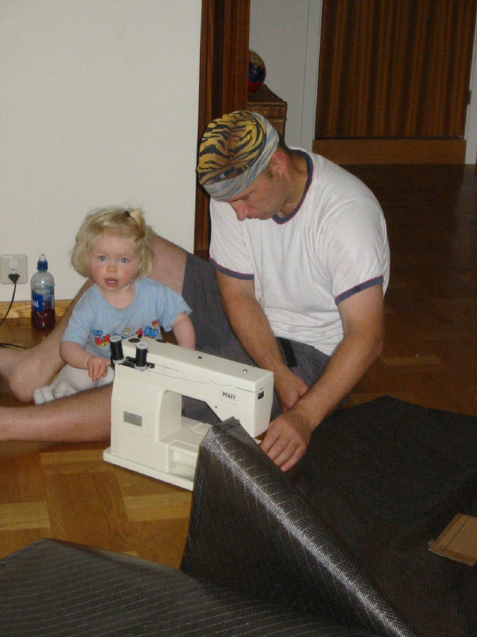

There is also a family side to this homebuildt vs. work extra hours. If you do it yourself, you can do it at home and be available for your family, or even involve your family in it. I attached a picture where our youngest daughter is 'helping' me assemble a new jib <img src="http://www.catsailor.com/forums/images/graemlins/smile.gif" alt="" /> (wife made a veto on spi-work in the living room after we buildt a new Tornado spi there. Too noisy and too much cloth).
How about another caption contest?
"Don't sew your thumb into the sail Dad!"

It is usually more like "Oh, did I change any settings on the machine" or "how much thread is there on one spool". Good to have photos so we dont forget such moments.
