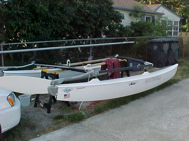

Hey now you have a classic, my boat is #11 from 1966. I have attached file after painting, forget the gelcoat (price out doing entire hulls).
The response from people to polish simply has not seen a hull of +30 years weathered, the other consideration is that racing or stess is out of the question.
A letter of Hobie president said do not do this for bow (hull failure may occur with tragic results). My boat is going for the cruising lifestyle of beach clubs and enjoyment, after all she has been named "the mother of all hobies" and why would you abuse or strain a mother.
Please go to TheBeachcats.com to files and look for historial hobies under surfergirl album, you will be shocked at her condition at purchase and now plus painting guide.
The posters did not take in consideration age, and appartant wear which once again a cost factor.

WOW! Great looking boat!! I think i will give that a try. Besides, if i put to much money into it, i probably won't want to sail it in fear of scratching it!

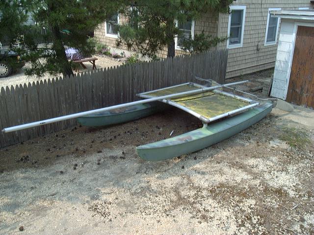

I have attached pic of surfergirl upon purchase.
Posted By: dave taylor
Re: Hull painting - 11/07/02 04:27 PM
amazing. i guess with enough time and work almost any boat can be restored.

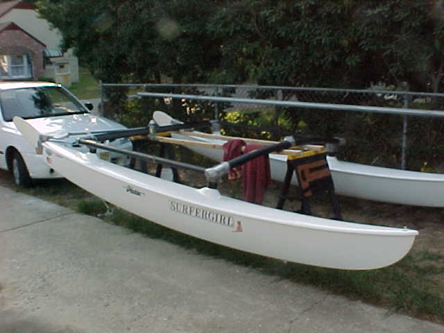

You are right about time and painting, it's like a car if you paint it must cure.
The Holder Hobies I have found in design are more beautiful concerning hull design. I am surprised Hobie never launched
a limited production model based on old design (orginal). The old people have stated that after the era ended the designs took on a
marketing one, in which beauty tooke second place, why look at cars for an example.
The love of restoration is to the detail, and lloking forward to launching her after 25 years land locked.
Many Thanks
