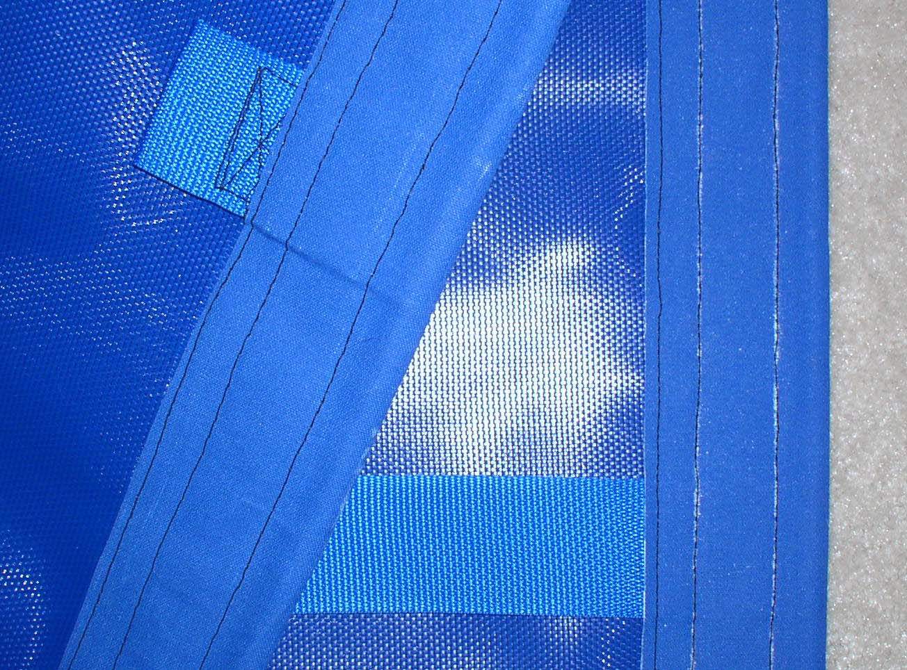

O.K. the tramp is done... ... except for the straps. At the front of the tramp the straps are already attached by looping the webbing material around the edge of the tramp fabric, where the ramp is inserted in the extrusion of the front beam. I hope that this setup will distribute some of the forces directly to the front beam and cause less stress to the rest of the fabric. All of the stitching is covered by sunbrella - I hope this keeps the TX sun out.
The rear of the straps will form a loop and I plan on tying that end to the extrusion in the rear cross bar. This has the nice side effect that the whole deal is adjustable and nothing will pull directly on the tramp.

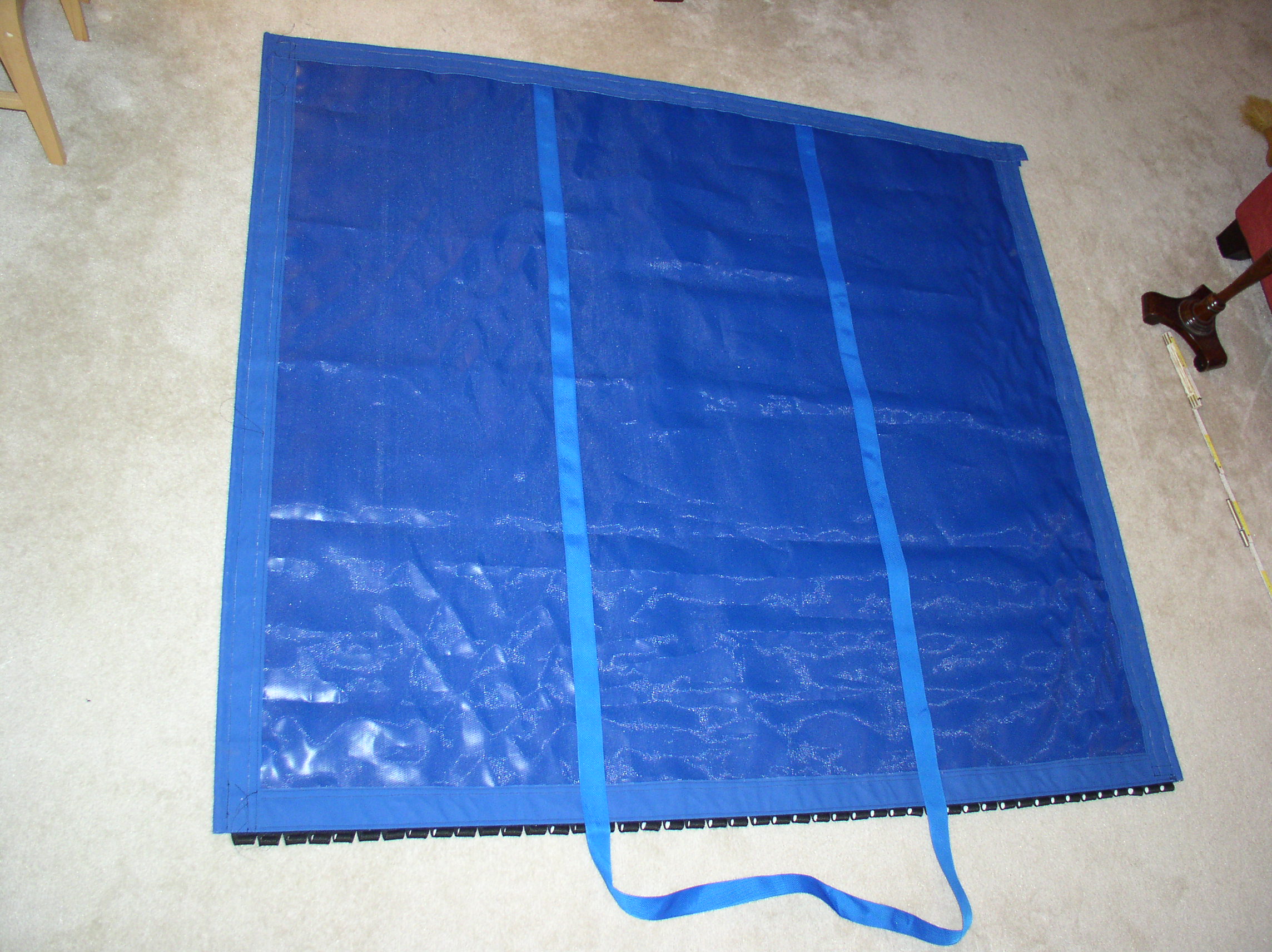

O.K. here is a pic of the tramp in it's current state (straps looped around the front)

hmm... this pic shows the detail of the webbing looping around (top and bottom)

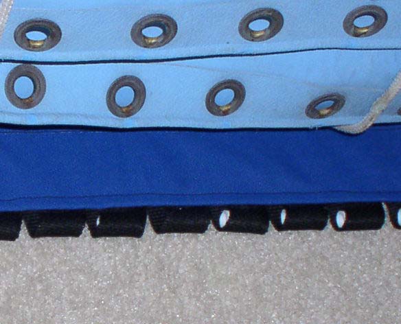

o.k. this is the last pic... ... compares the rear of the old and new tramp. There are more loops on the new one than grommets on the old vinyl tramp (and this is already a double grommet style tramp)
