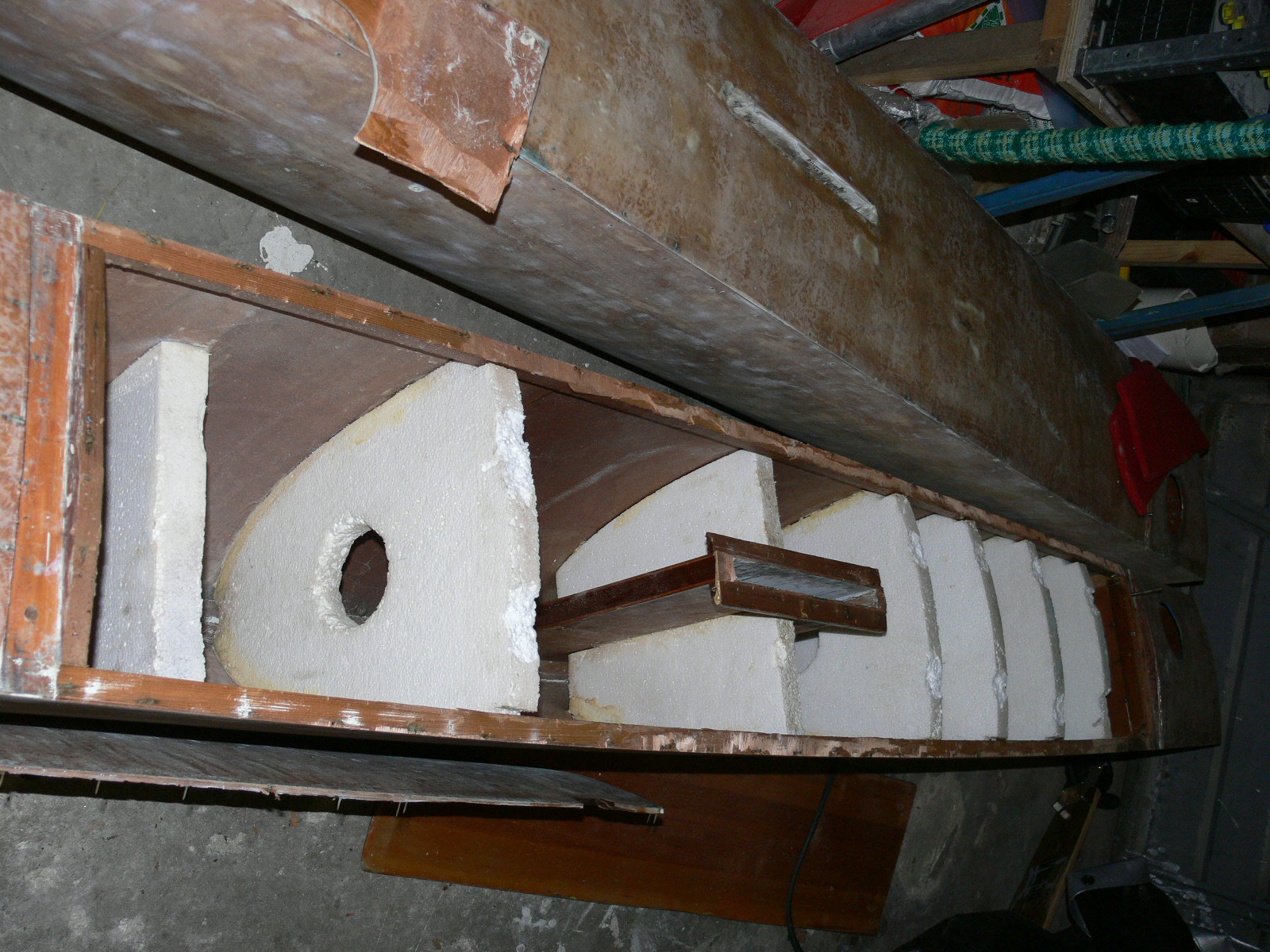

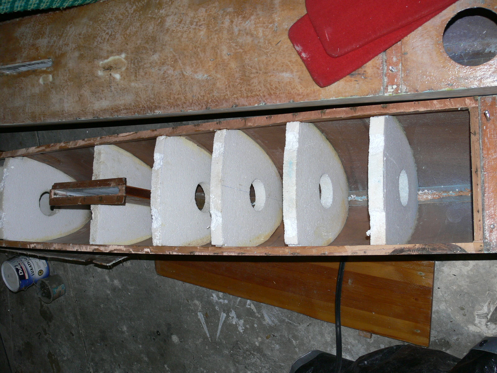

Here are some photos of your hulls. <img src="http://www.catsailor.com/forums/images/graemlins/cool.gif" alt="" />
Thaught You might want to see the damage I've done on your behalf <img src="http://www.catsailor.com/forums/images/graemlins/grin.gif" alt="" /> <img src="http://www.catsailor.com/forums/images/graemlins/grin.gif" alt="" /> <img src="http://www.catsailor.com/forums/images/graemlins/grin.gif" alt="" />
Posted By: becjm
Re: New Deck - 09/22/07 11:23 AM
Can anyone tell By the photos who may have built the hulls?

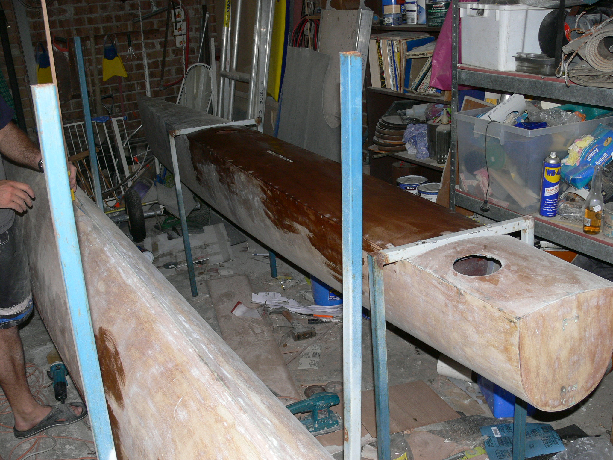

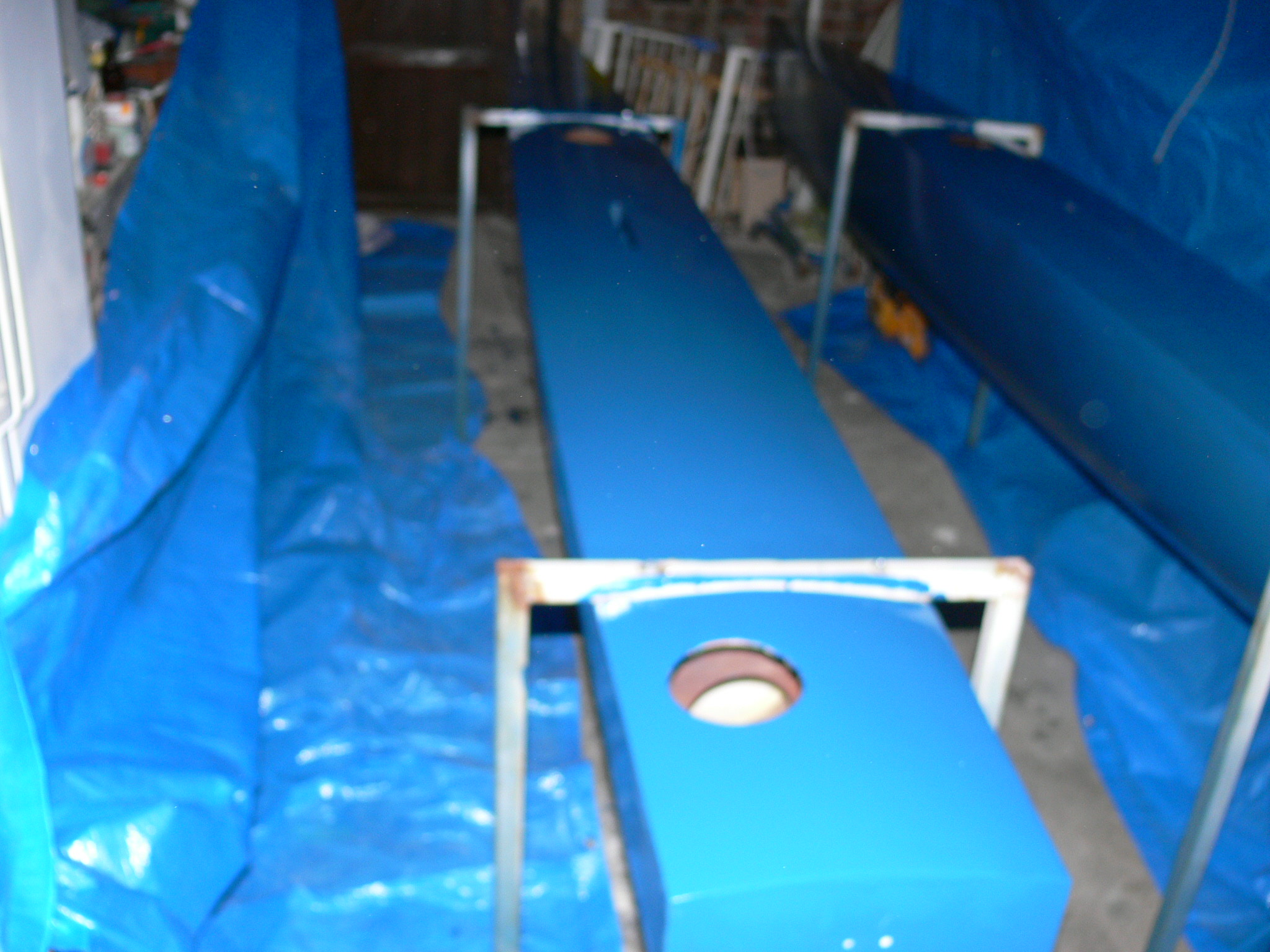

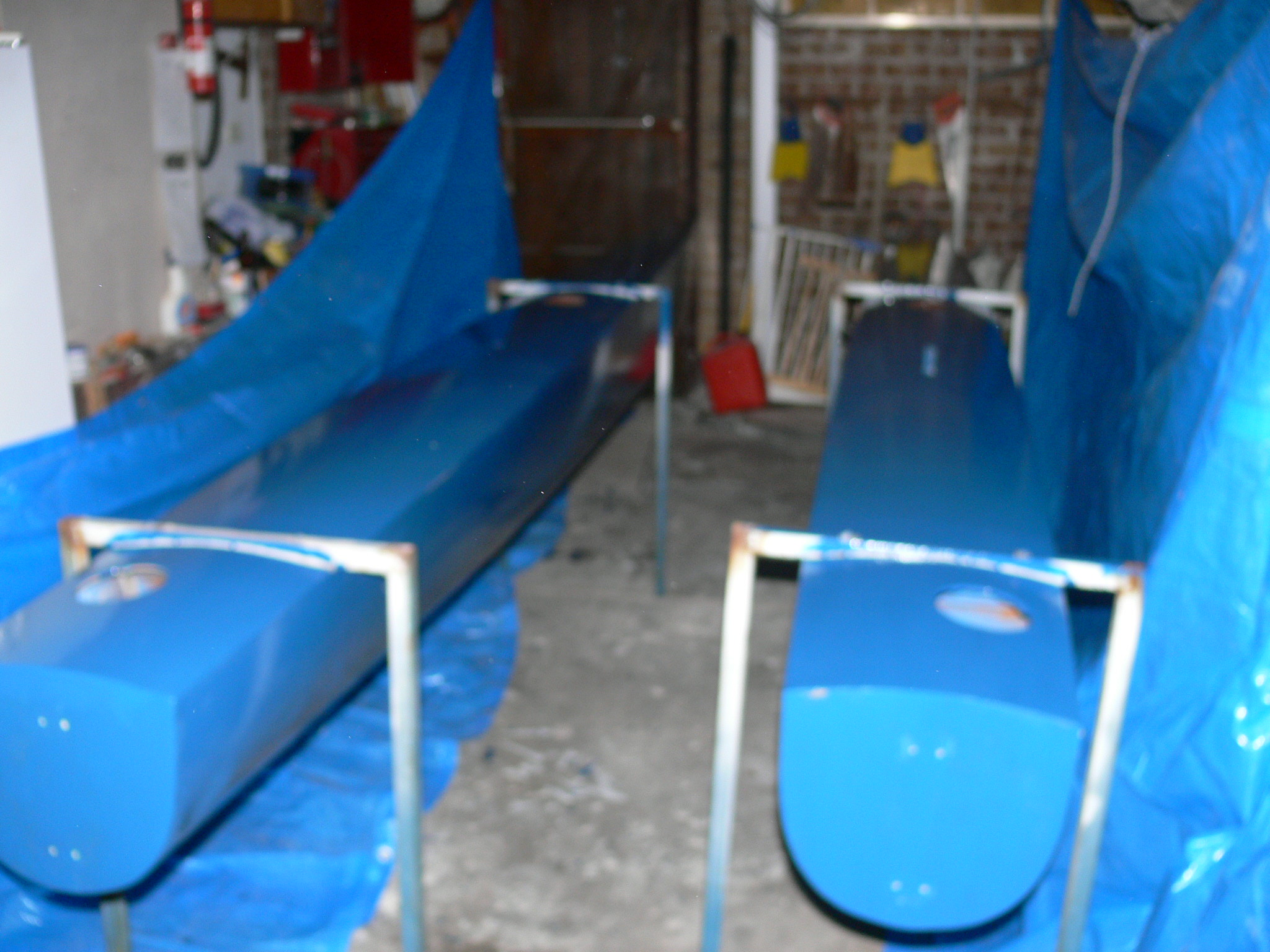

Progress so far
The thin layer of glass on the decks had to be knocked right back as it was glassed with light weight chopped strand with minimal resin making the deck fairly rough but alot of sanding and a small amount of filler has leveled it out.
The decks are both done and we finished fairing the new inserts in bottom of the centercase to accomodate the smaller center boards.
Wed should be paint day.

Yeah its old front deck section that was glassed the previous owner with chopped strand the new main deck is 120gm cloth and west sys resin.
2 pac blue paint to finish.

Posted By: becjm
Re: New Deck - 10/09/07 11:46 AM
Sorry Cam

Posted By: becjm
Re: New Deck - 10/11/07 10:42 AM
Some blurry photos of Cams hulls
Posted By: becjm
Re: New Deck - 10/11/07 11:31 AM
and another
Posted By: Peter_Foulsum
Re: New Deck - 10/11/07 01:06 PM
Ben,
Love the colour <img src="http://www.catsailor.com/forums/images/graemlins/cool.gif" alt="" />
Is it Botany Blue ?
Peter
Posted By: Bandit
Re: New Deck - 10/11/07 10:01 PM
I'll check the lable tonight when coat 2 goes on.
I will look like a smurf after sanding back this coat..
