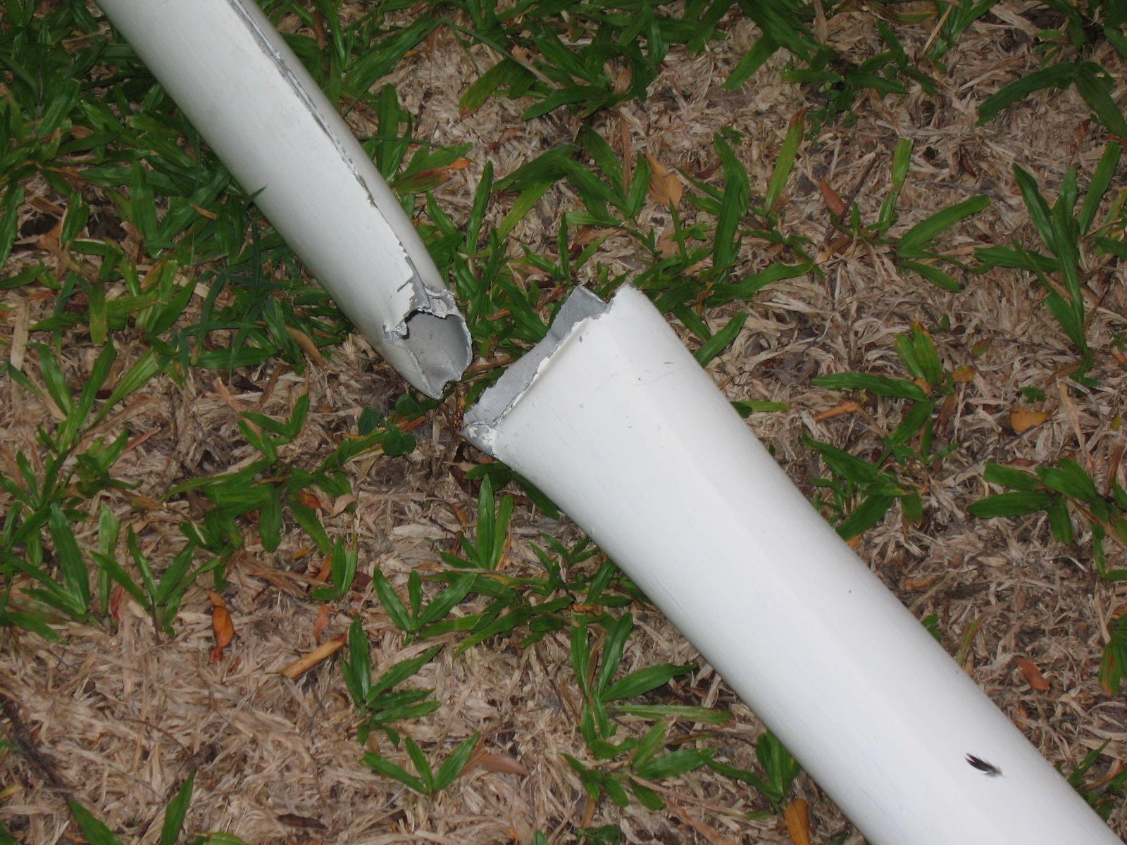

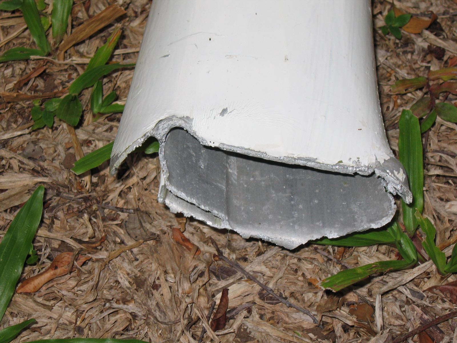

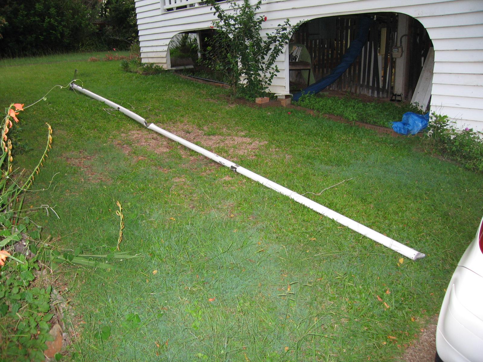

Posted By: ncik
Re: Breaking Masts - 02/08/06 07:27 AM
OK. photos of broken mast below...photos of main can be found in square head main discussion...
Nick.
Posted By: ncik
Re: Breaking Masts - 02/08/06 07:29 AM
Posted By: ncik

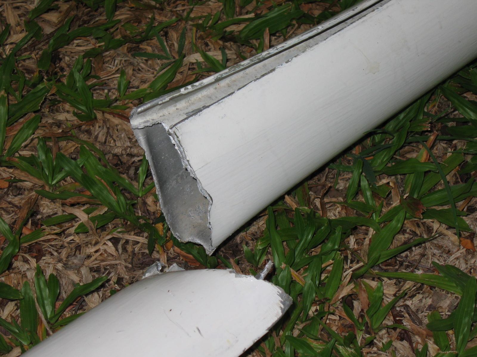

Posted By: ncik
Re: Breaking Masts - 02/08/06 07:31 AM
notice collapsed inner wall
Posted By: ncik
Re: Breaking Masts - 02/08/06 07:38 AM
I haven't really had a chance to investigate the destruction of my mast, but after looking at those photos some more it appears to me that the spreaders may be too low. Raising them up closer to the break should reduce the bending moment around that area.

Posted By: Anonymous
Re: Breaking Masts - 02/08/06 10:13 AM
Hi Nickb,
mast break looks like most I have seen, in that it looks like compression failure. The damage to what I would call the back of the sail track does seem a little unusual though, usualy most of the compression failure seems to be on the side of the mast. Although only looking at pictures makes it difficult, the angle the back of the track is at could be from tearing after initial side wall failure.
When building Altered, I was asking about failures in carbon wing masts, I was advised compression of the side of mast was usual failure point, so I put timber web crossways inside, to stop it caving in. Seems to have made it bullet proof so far.
Spreader positions I have used is usualy halfway between diamond attachment points. Don't remember anything more technical than that. Top of diamonds is usualy determined by how close you can get to your hounds without fowling stays when rotating mast. Hound point is governed by class rules.
Regards Gary.

Posted By: Steve_Kwiksilver
Re: Breaking Masts - 02/09/06 12:04 PM
Hi Nick,
Just looking at your mast-break reminded me of mine a few years ago, going upwind in about 18-20knots with 170kg on the wire (fat friend ), the mast rotator arm bent suddenly allowing the mast to over-rotate rapidly, and we hit the water with a new two-piece mast. It broke almost in the same place as yours, a little closer to the spreaders in my case. My theory is that the mast rotated to 90deg or even past, with 2 on the wire the spreaders are facing fore-and-aft, no lateral support at all, bang. The other factors you mentioned could also be the cause, I`m just offering a possible explanation if you had not set the mast rotator yet and it was over-rotated.
I don`t believe the squaretop caused the failure, but the additional power may have assisted, although I`m not convinced as you say you had not powered up the main fully yet. There are too many possibilities, only way to know for sure is to get a new mast and try it out again ! (just insure the mast first )
