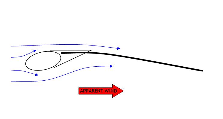

I generally run my downhaul at 4 to 5 on the Ronstan scale with the wrinkles coming out at 3 to 4. I hauled it on to 7 for those conditions and it was remarkably stable considering. I put some luff telltales on before I went out and I definitely needed more rotation so over the last few days I have rebuilt the rotation and the outhaul systems. I put the sail up today and now have a much better system with dealing with rotation and outhaul. In regard to your rotation, do you set and forget or adjust for the conditions? To my thinking you should try and have the lee side of the spanner in line with the apparent wind, (see pic). What do other people try and do?? Obviously you want minimal turbulence on the lee side of the sail..
Your right, I am 'really' enjoying myself...

I really should have a mast rotation system that I can adjust from the trapeze so that it can be tweaked continuously for most efficient airflow <img src="http://www.catsailor.com/forums/images/graemlins/frown.gif" alt="" /> but usually I set it for each leg of the course along with outhaul and just keep adjusting the downhaul. The assumption here is that the wind strength will generally be consistent for each leg of the course and that downhaul will be used to trim the heeling angle.
Too many adjustment lines all over the deck tend to make it messier and easier to stuff up. Maybe I should also try to not loose concentration during a race !!

Hi Peter,
my thoughts on adjustment of rotation on Mossie mast is that the shape of the mast does not make it critical enough to need constant adjustment, from a aerodynamic view point.. Much better to concentrate on what is going on off the boat.
To my mind major effect of rotation on Mossie mast, is on stiffness below the Hounds when you rotate more, more fore and aft load is taken by the Diamonds stiffening the Mast. Allowing you to power up the middle of the sail or less rotation flattening the sail and the entry at the same time.
Regards Gary.
