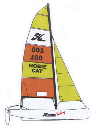

This Hobie Teddy looks to be about 12' with skags but uses a jib for improved tacking. <img src="http://www.catsailor.com/forums/images/graemlins/cool.gif" alt="" />

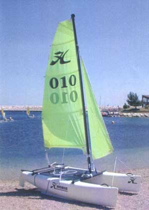

This one looks even smaller. <img src="http://www.catsailor.com/forums/images/graemlins/cool.gif" alt="" />
Posted By: Dermot
Re: A choice to make ... - 01/14/07 09:30 AM
I saw one once - I think that it has the inverted T shaped skegs that Mary mentioned - made it look a bit agricultural.
Posted By: phill
Re: A choice to make ... - 01/14/07 09:36 AM
The Teddy looks a lot like a scaled down Hobie Tiger
with skegs.
Is the jib self tacking?
Posted By: phill
Re: A choice to make ... - 01/14/07 09:43 AM
Just took another look.
The jib does not appear to be self tacking but then I don't
think the Tiger's jib was self tacking first up.
I think the 12ft target audience needs something much simpler to maintain the advantages of the 12 ft size.
Just a personal view.
Posted By: mattaipan
Re: A choice to make ... - 01/14/07 10:06 AM
The Hobie Teddy looks alright, nice clearance under the sail for moving around, never seen one til now.

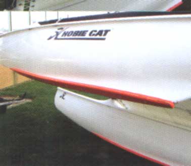

Here's one of the skegs.. <img src="http://www.catsailor.com/forums/images/graemlins/cool.gif" alt="" />
Posted By: Mary
Re: A choice to make ... - 01/14/07 11:48 AM
Yes, I think that 'shoe keel' is what I was talking about. It worked phenomenally well on the Witness 35(?). What difference does it make if it LOOKS agricultural but works great? You guys are SO superficial. <img src="http://www.catsailor.com/forums/images/graemlins/grin.gif" alt="" />

If you put the T-shape shoe keel far enough back you may get some of the stability benefits of a T-toil rudder system.
Is that from the Teddy ? - because the impression I had was that the T bit was much bigger, heavier, looked like a railway track and definitely "Agricultural" <img src="http://www.catsailor.com/forums/images/graemlins/grin.gif" alt="" /> And the boat was very slow. The other kids were sailing Dart 16s and loving it <img src="http://www.catsailor.com/forums/images/graemlins/grin.gif" alt="" />
