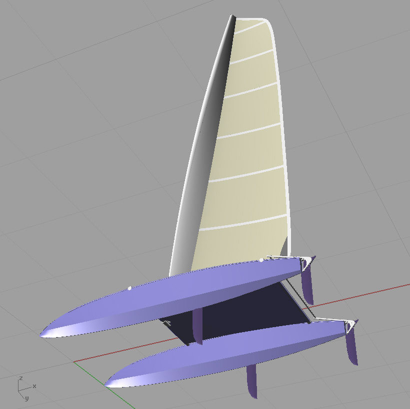

I've actually done the math and modelling on the F12 and interestingly enough it is not suited to say 5 or 8 year olds.
If you scale the basic catamran design down to 10 or 8 feet then you run into other problems, like pitching resistance. The catamaran design doesn't lend itself very well to very short hull lengths. That is one of the reasons why the F12 is what it is now, geared towards 12-16 year old youths and light adults.
Other designers and project teams are invited to create and succesfully establish (smaller) cats geared towards smaller sailors, but I'm not going to do it.

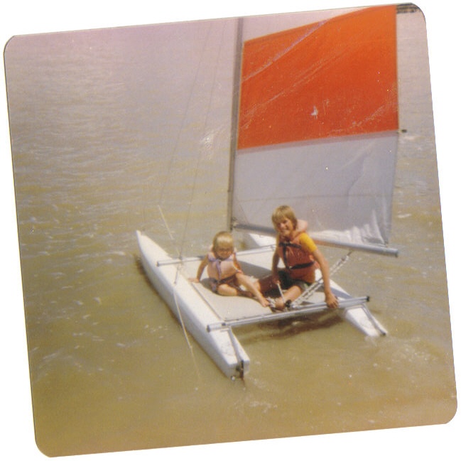

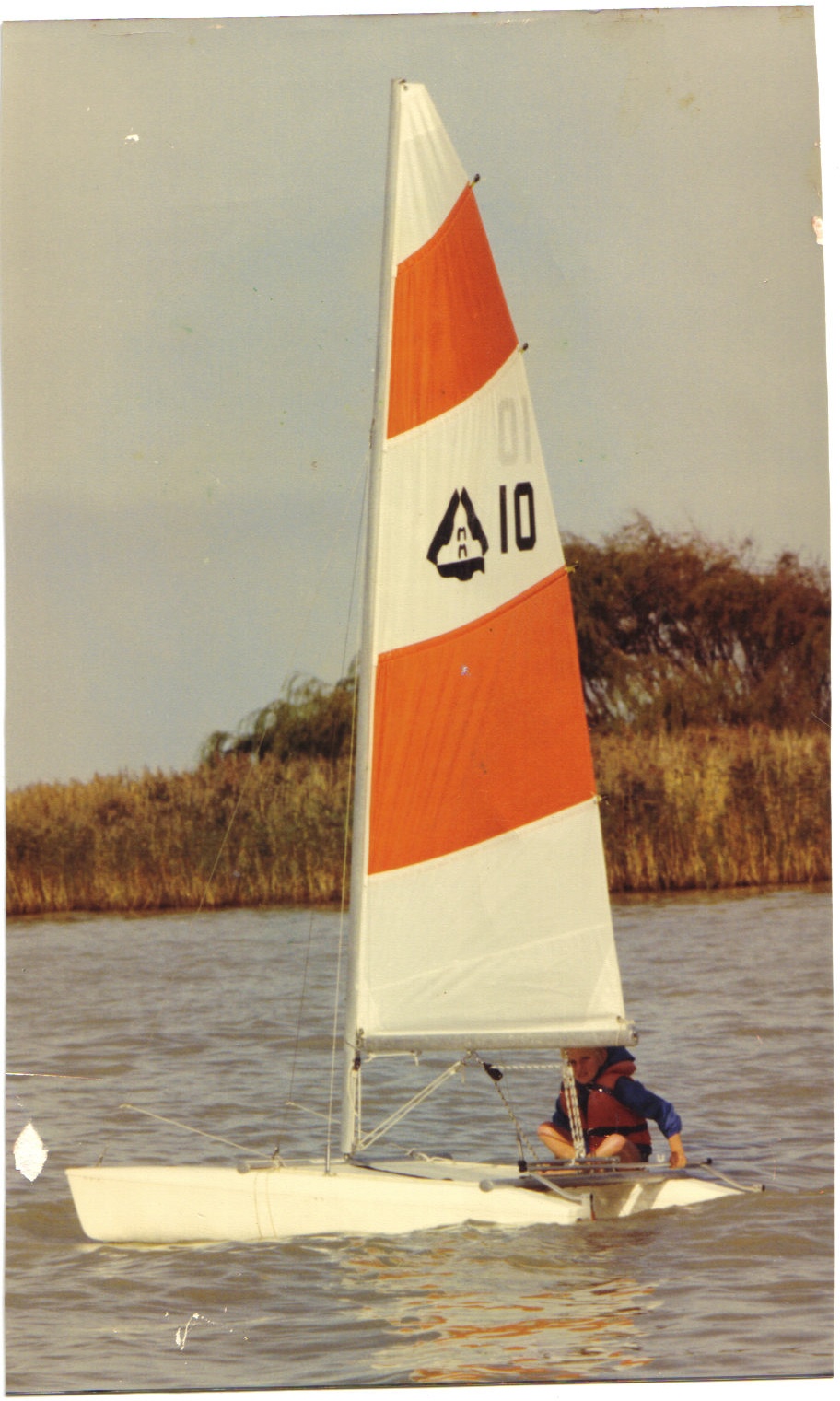

The fact you can teach 7-12 year olds on a 12 ft cat is fact because I've done it for several years at my old sailing club.
I even made sails for each of the 6 12 footers that we had. 80sq ft of sail area and cost me around $200 per sail to make including the cost of batterns.
So that was just basic material cost at wholesale prices.
It was while back now.
All the maths will do is put you in the ballpark or in this case conveniently out of the ballpark.
Interesting to note the 12 ft cats never pitch polled although my youngest at times did drive the crap out of them downwind when the breeze was up and with the spray coming off the front of the boat I was always waiting for him to stick it in. He claimed he knew what he was doing and had everything under control but from the standpoint of an anxious parent.........
The main draw back was the time it took to rig the boats and they were not pleasant on the eye and heavier than I'd like to move around.
You have to put this in context in as much as we had a bunch of Hobie Hawks at the club. (very small dinghy for young kids like the optimist dinghy.) That was our training boat until we got the cats. After the cats arrived we couldn't get the kids to use the Hobie Hawks. The Hawks were near new shiny and very colorful sails. Still they would fight over the old cats.

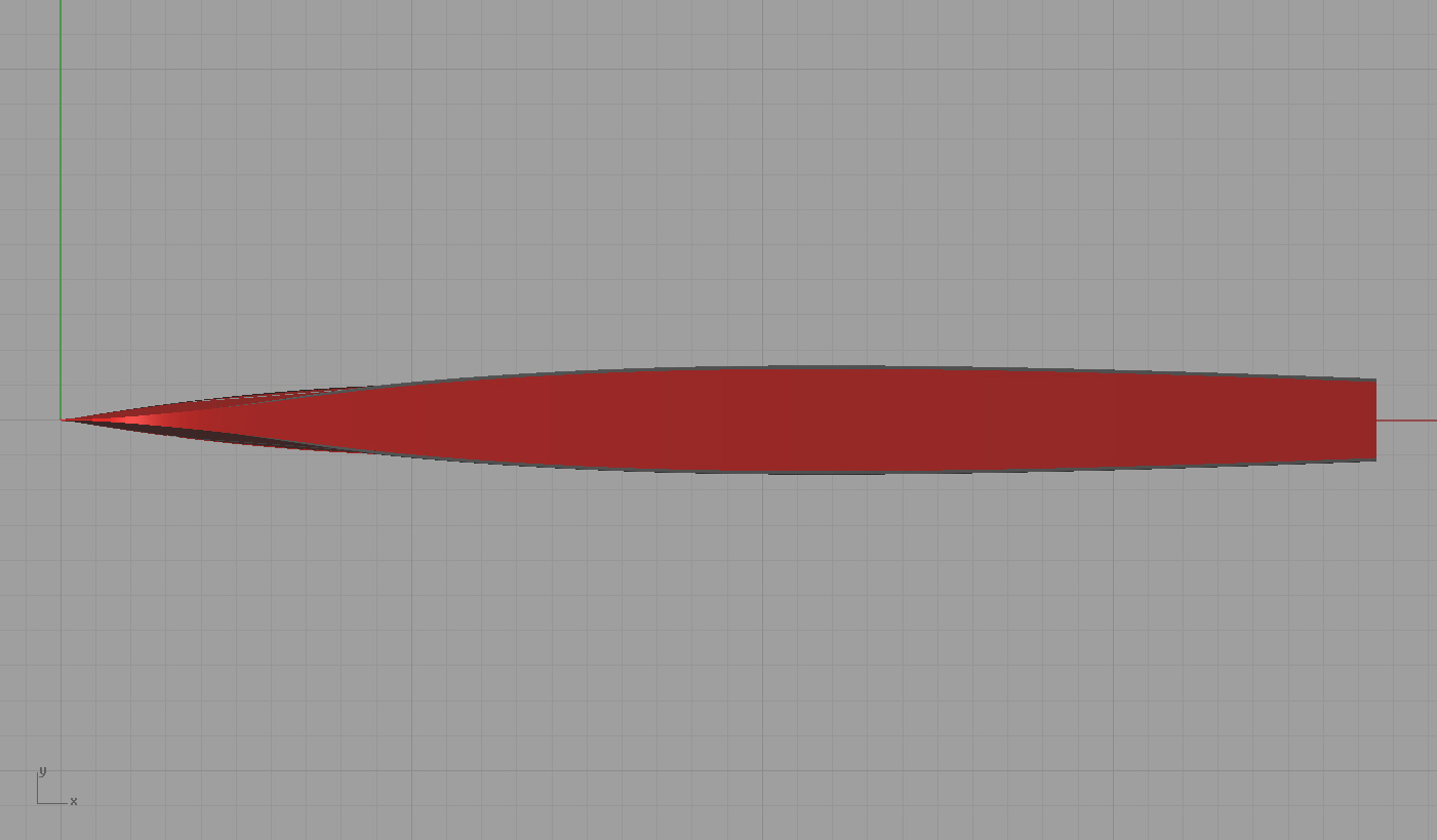

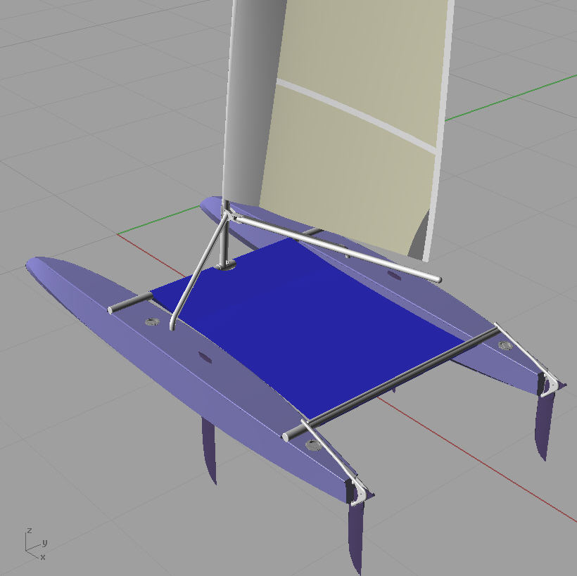

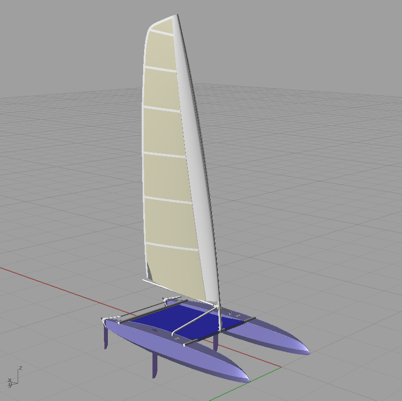

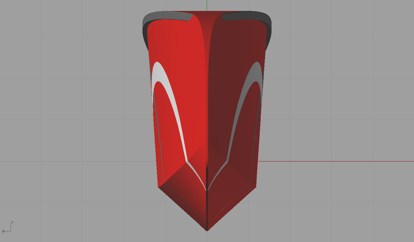

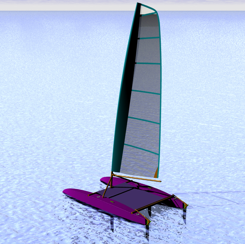

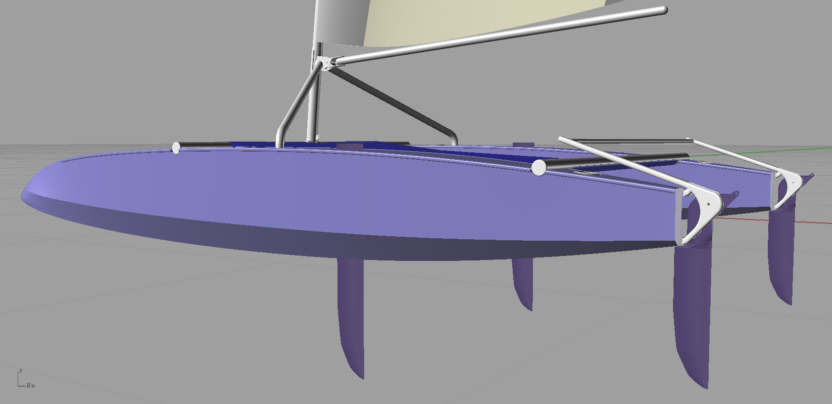

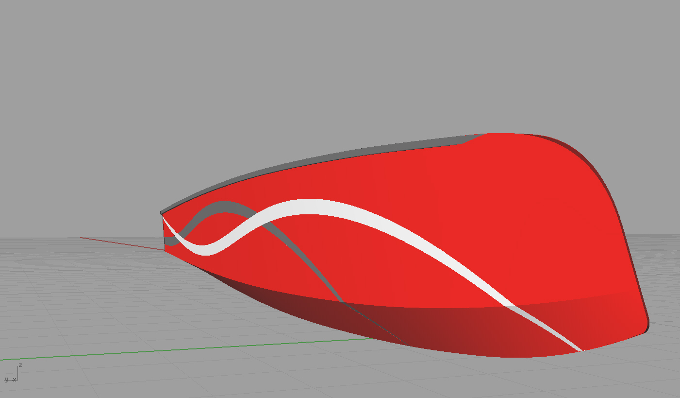

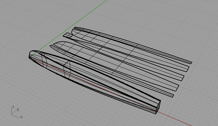

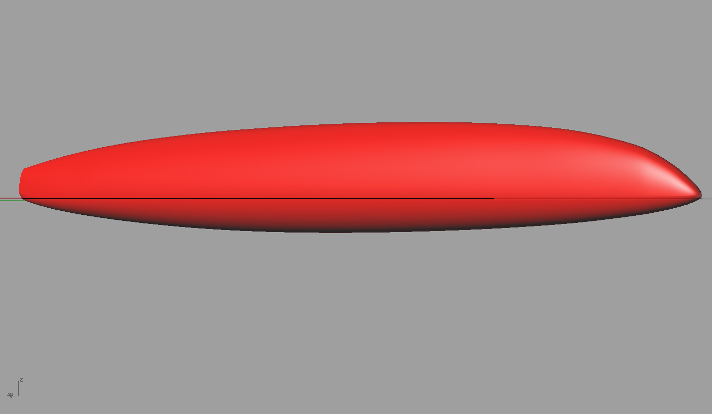

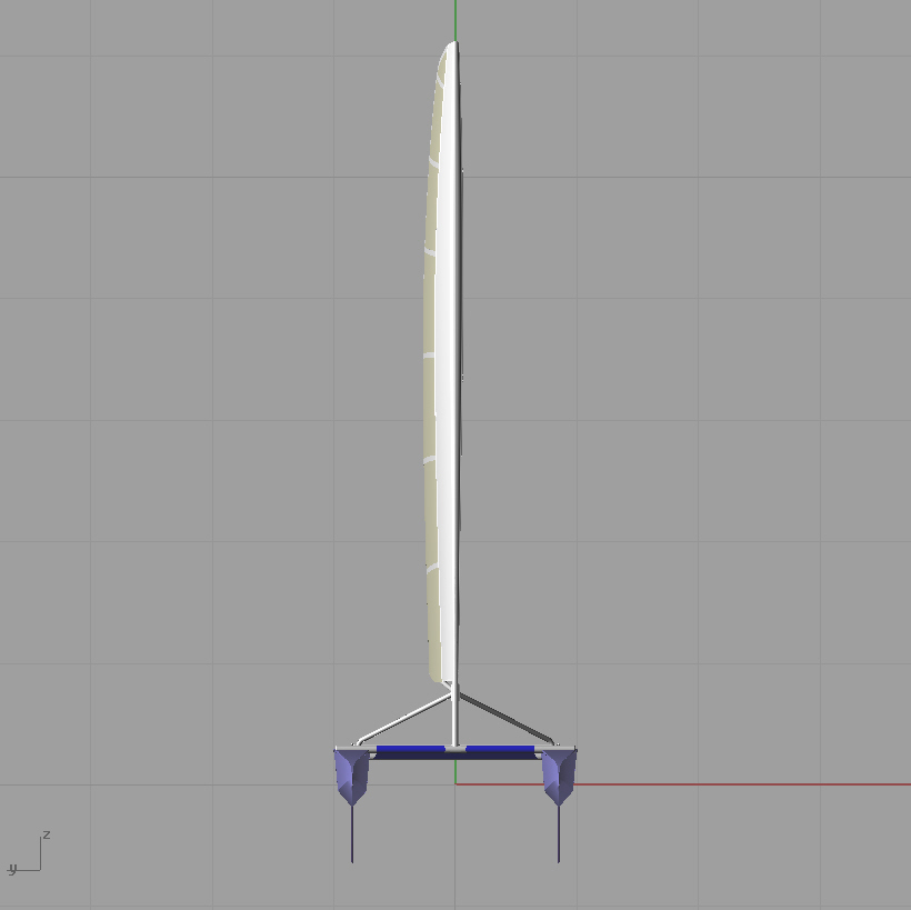

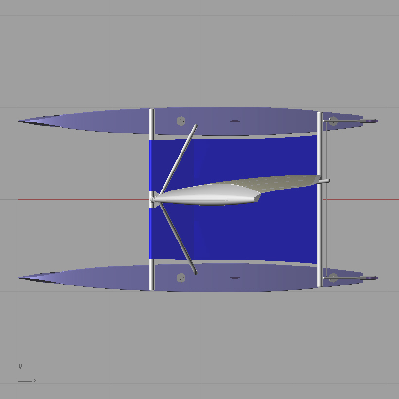

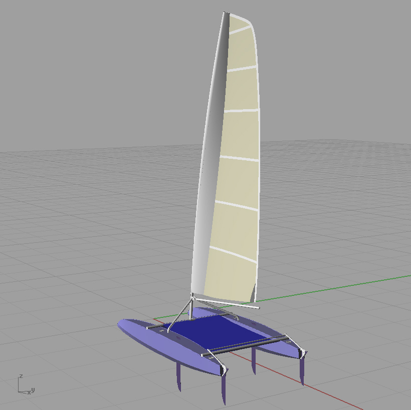

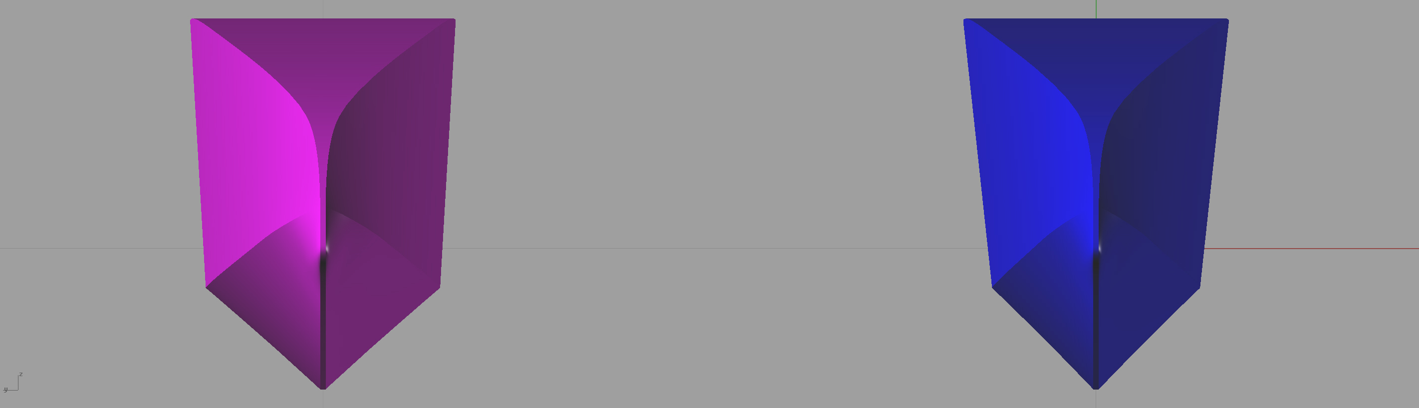

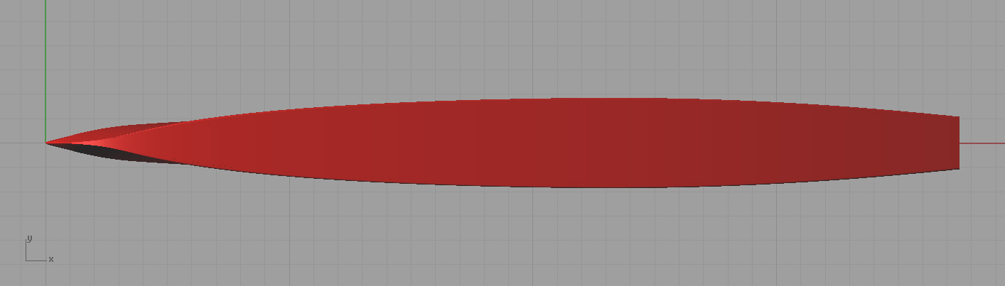

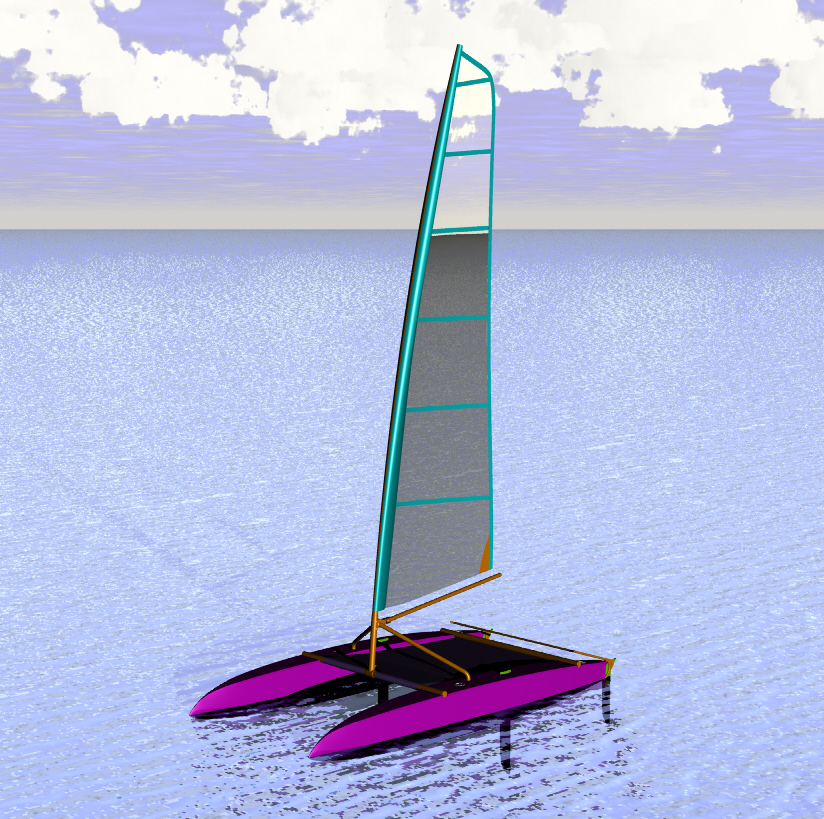

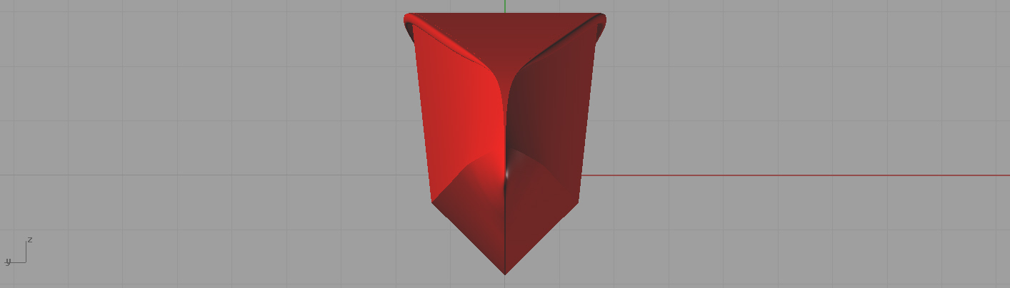

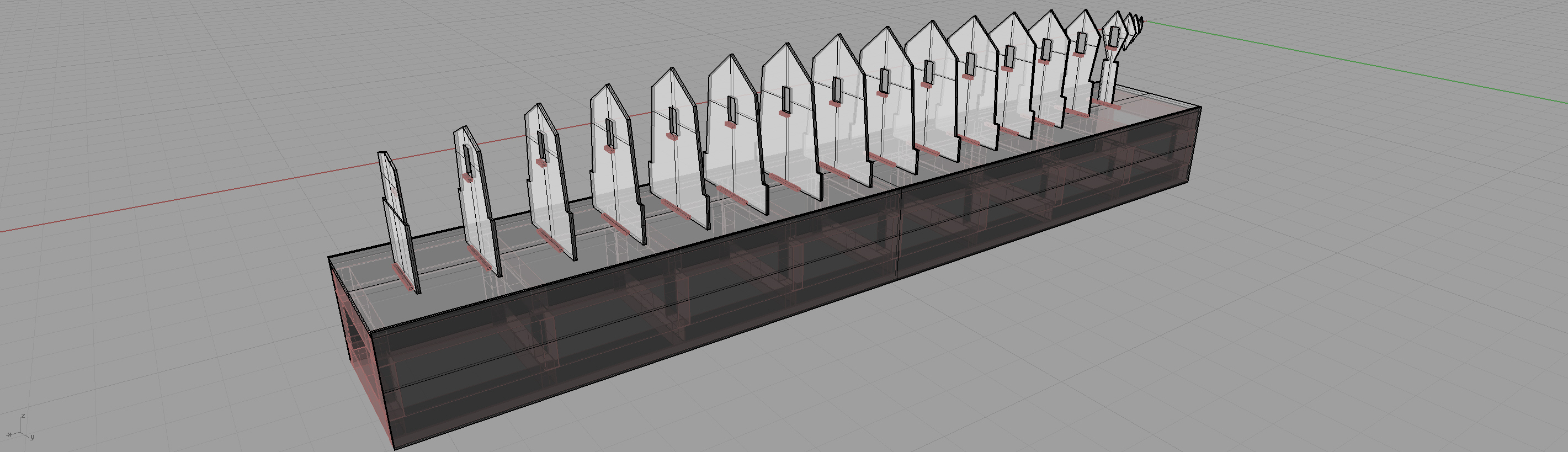

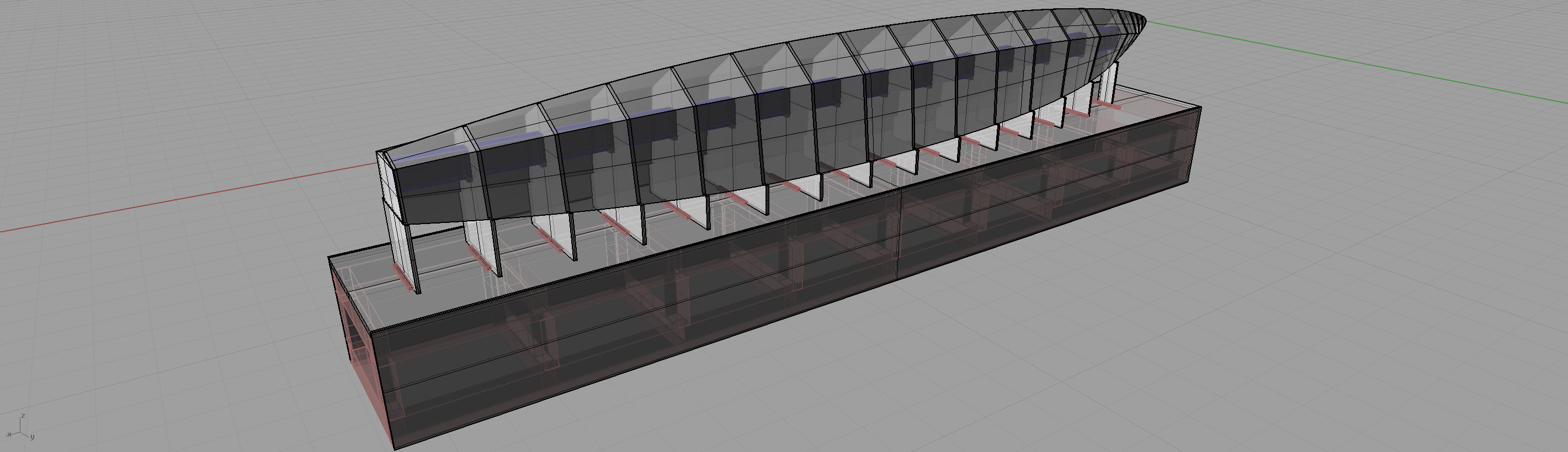

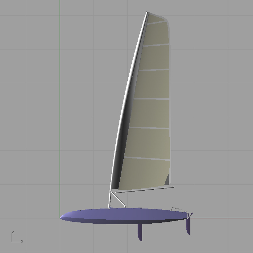

I had Aerynt's son Michael (13) call me last night for help with how to design a better boat than Wouter's shown in his first impressions post. After a few faxes etc I threw the following together which is what Michael and John(7) think their next boat should look like. Its just the hull, can only do so much in one evening.
RG

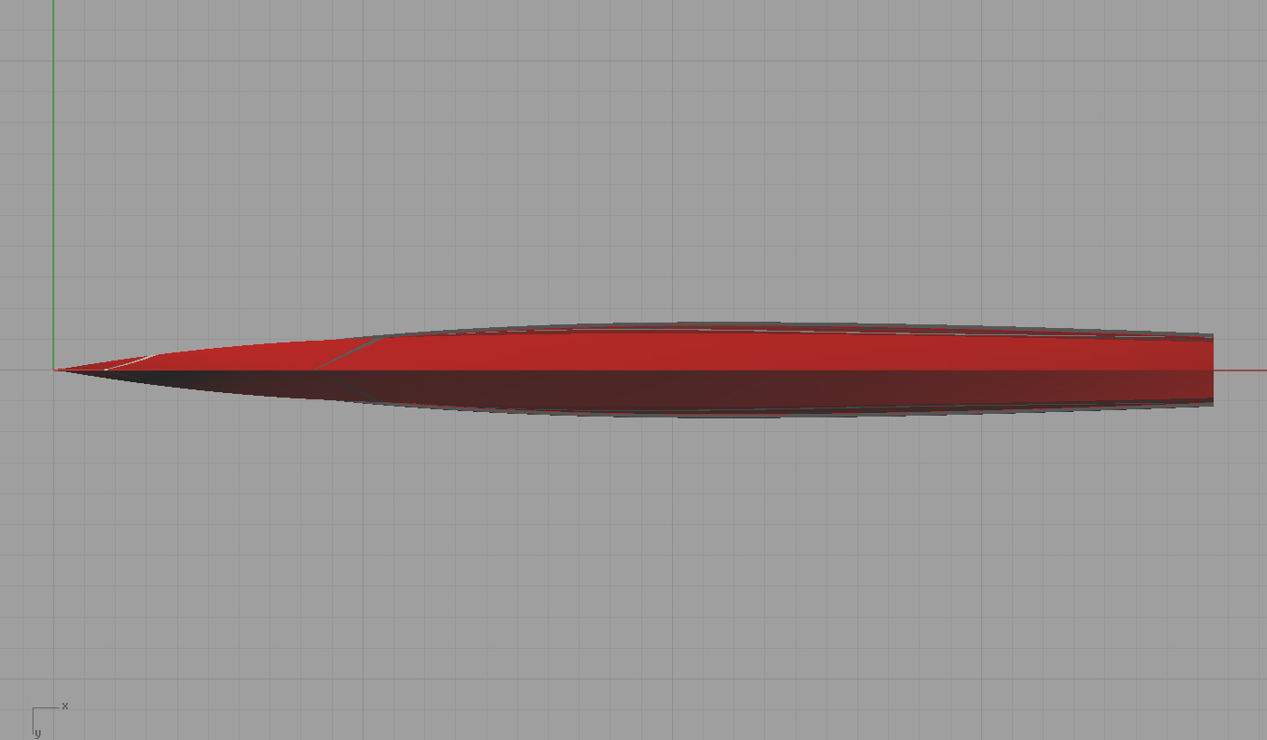

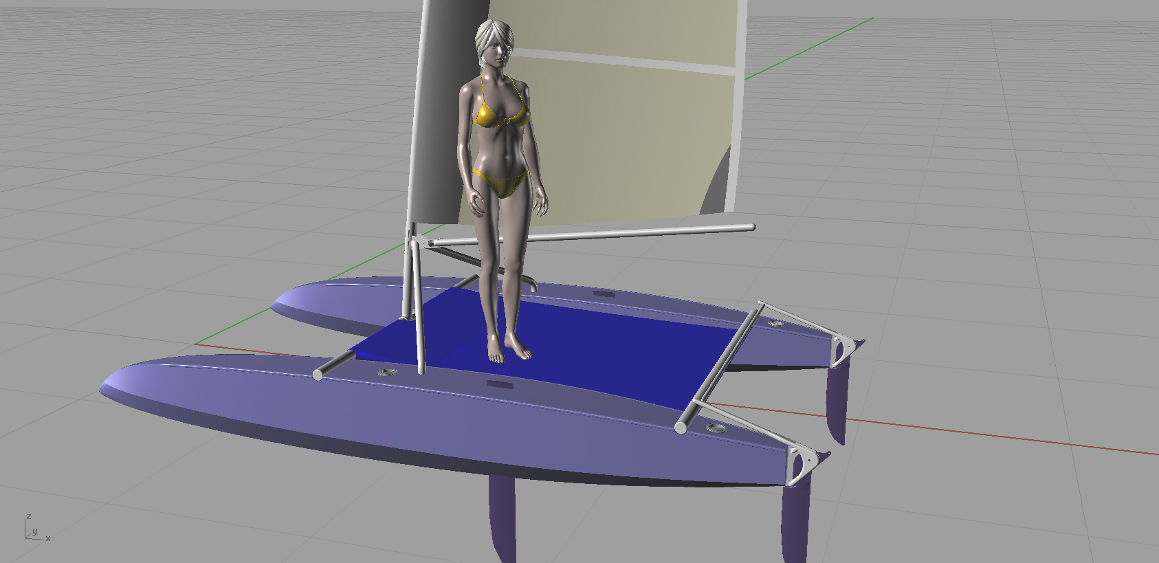

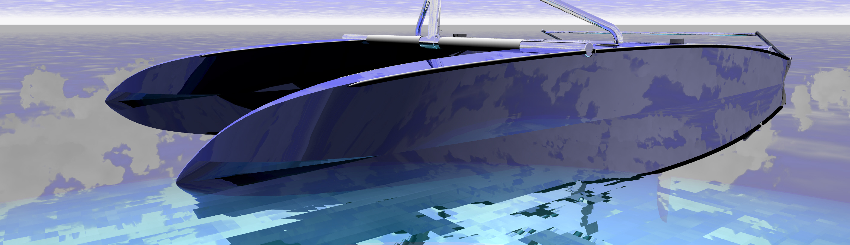

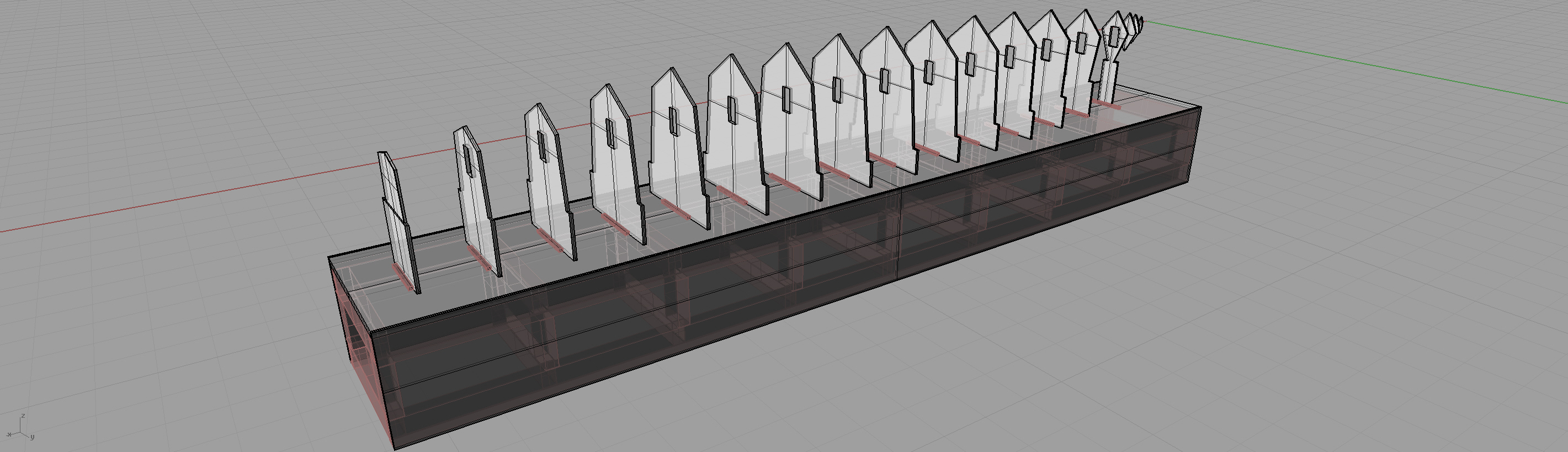

Posted By: RetiredGeek
Re: Kids F12 - 11/03/07 08:27 PM

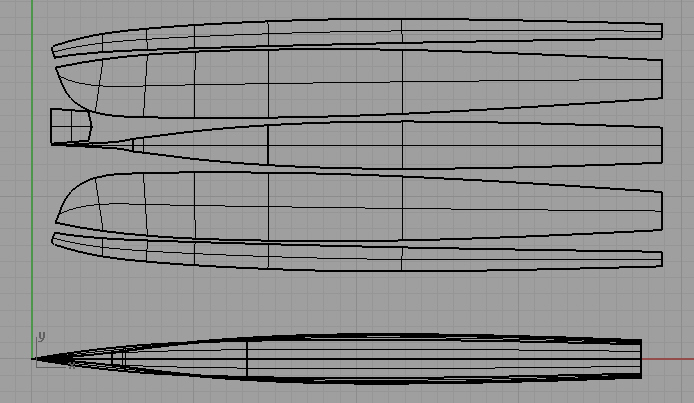

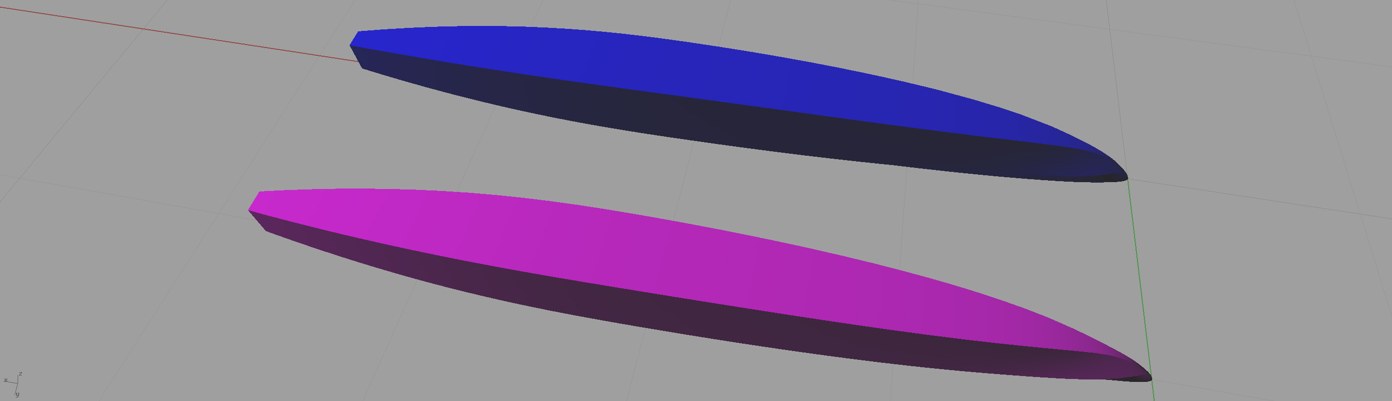

more pics, next few are of the hull flat paneled

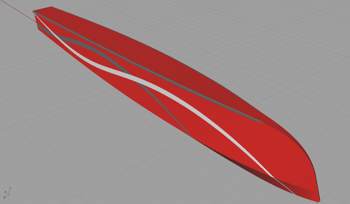

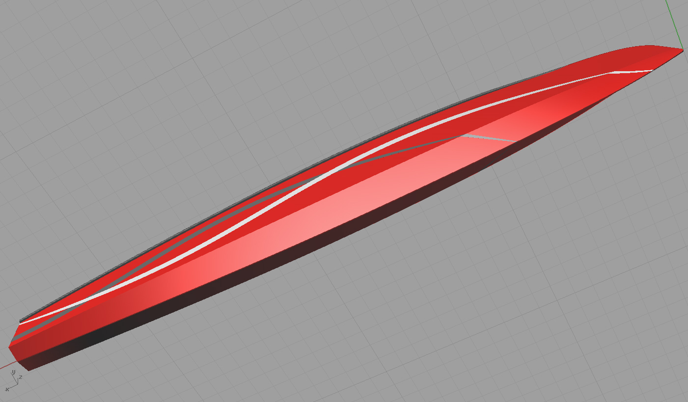

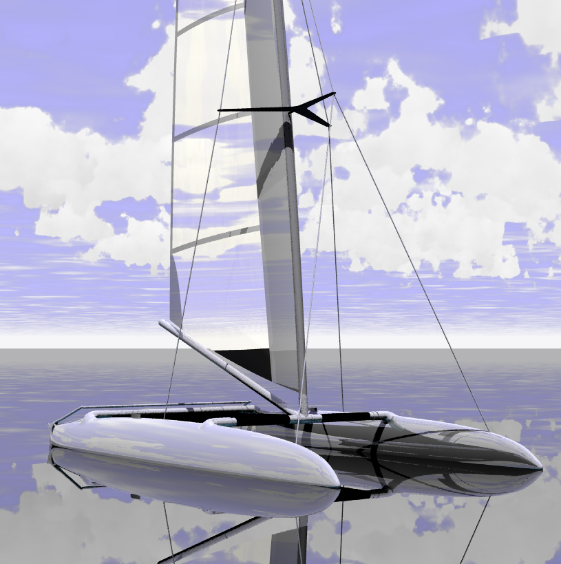

Re: Kids F12 - 11/03/07 08:28 PM
another

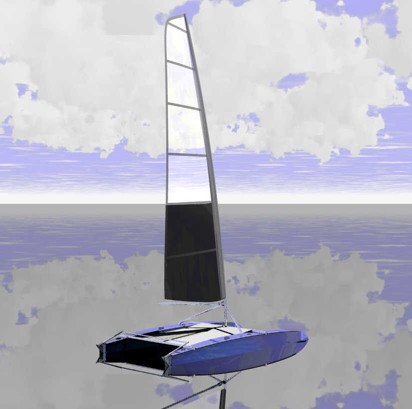

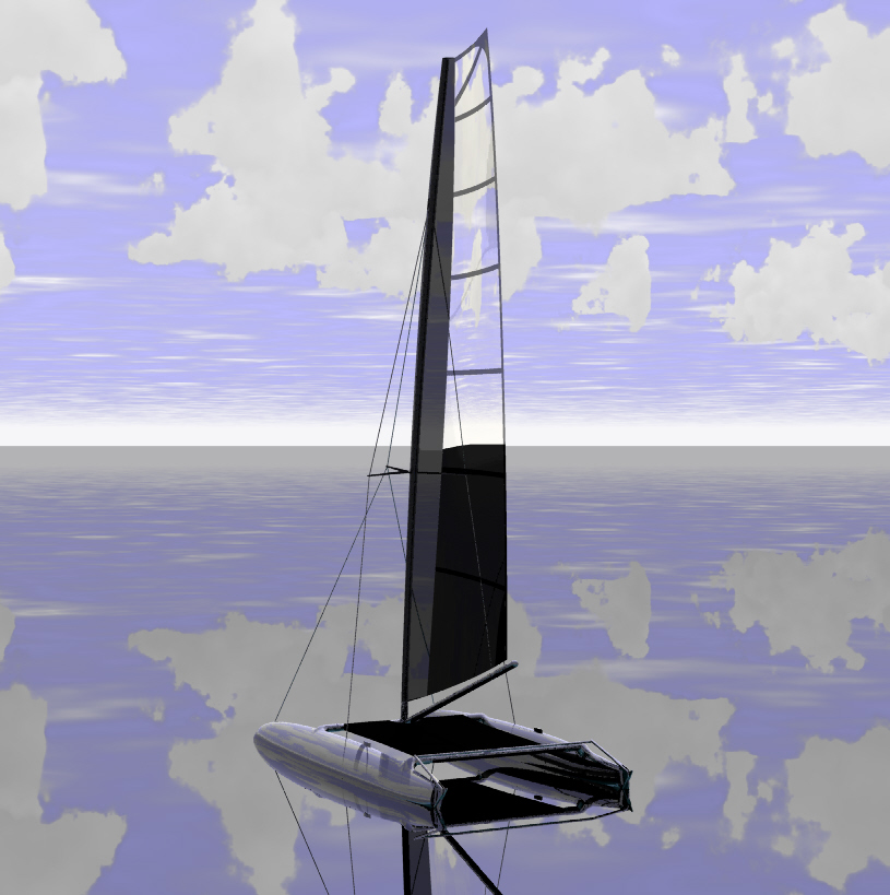

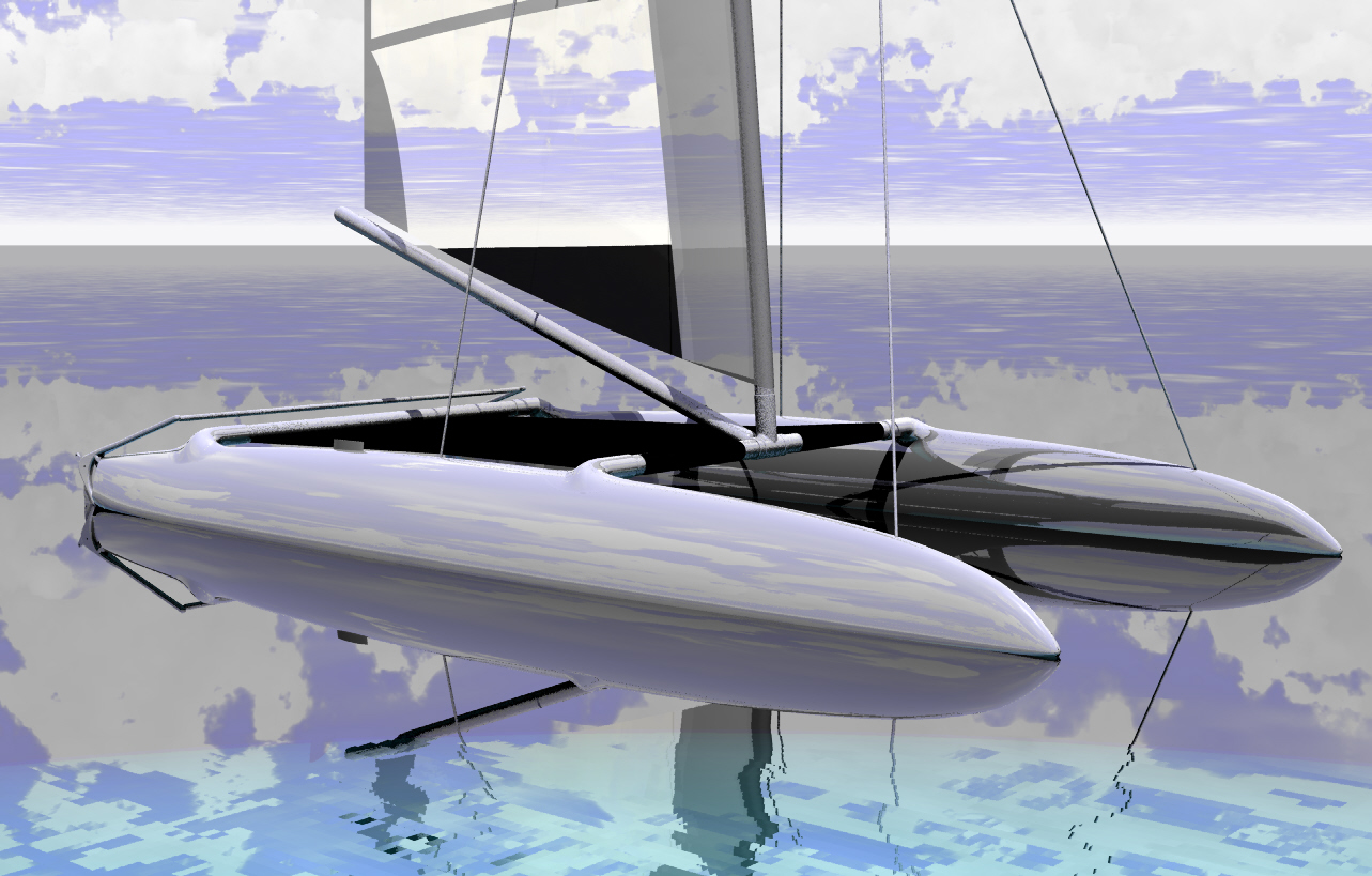

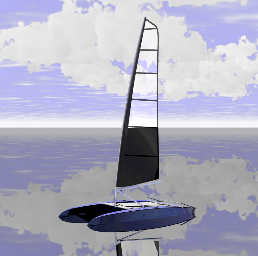

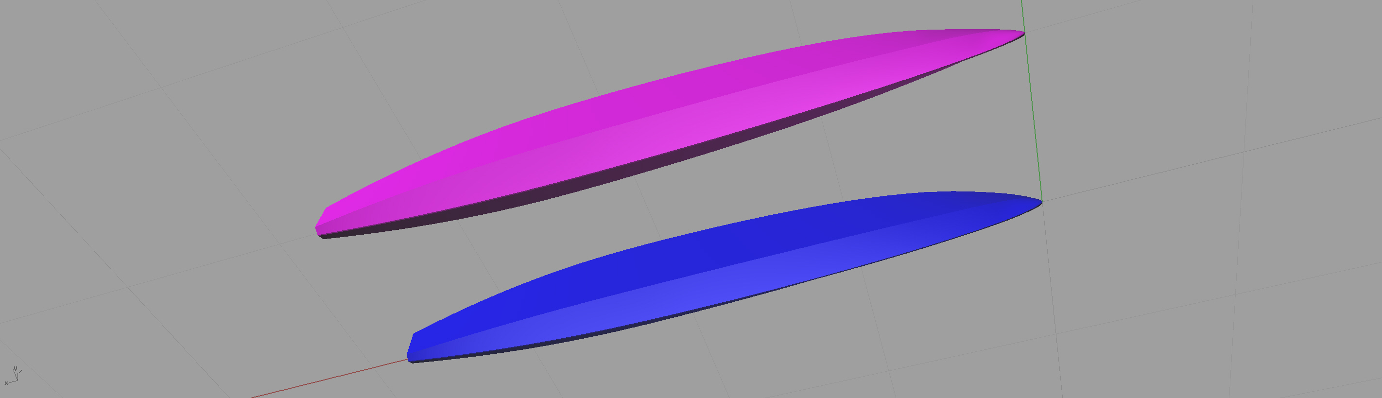

another, rendered

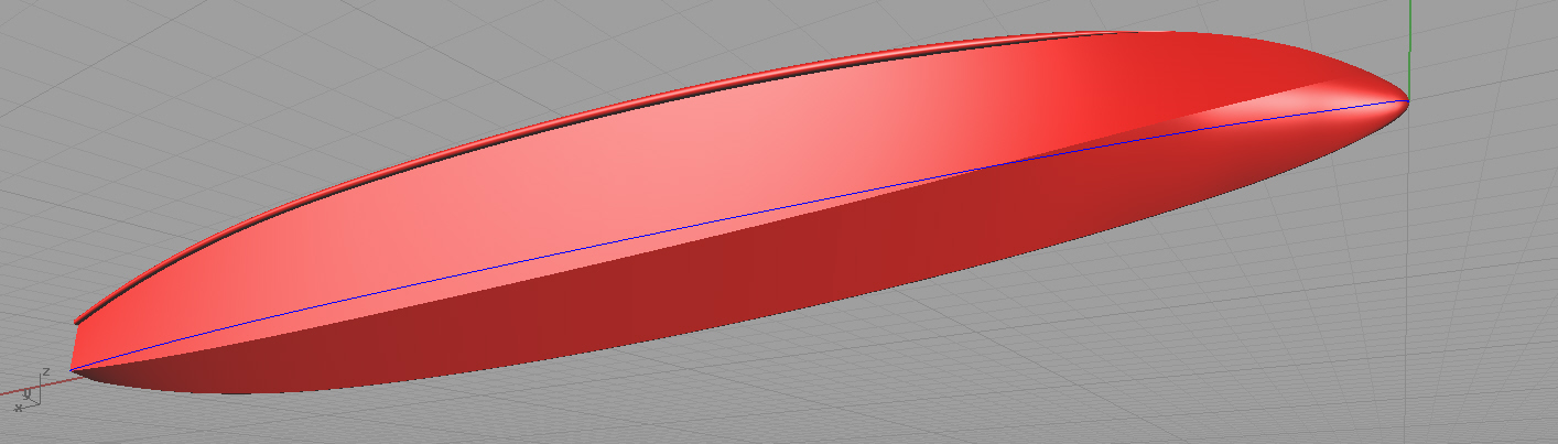

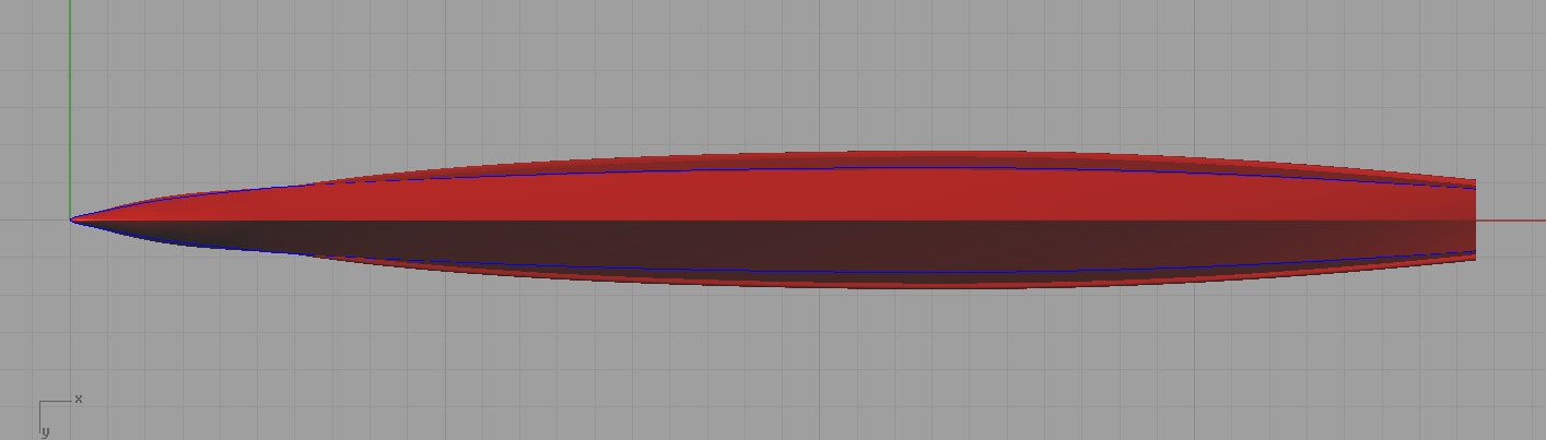

Re: Kids F12 - 11/03/07 08:30 PM
rendered from above

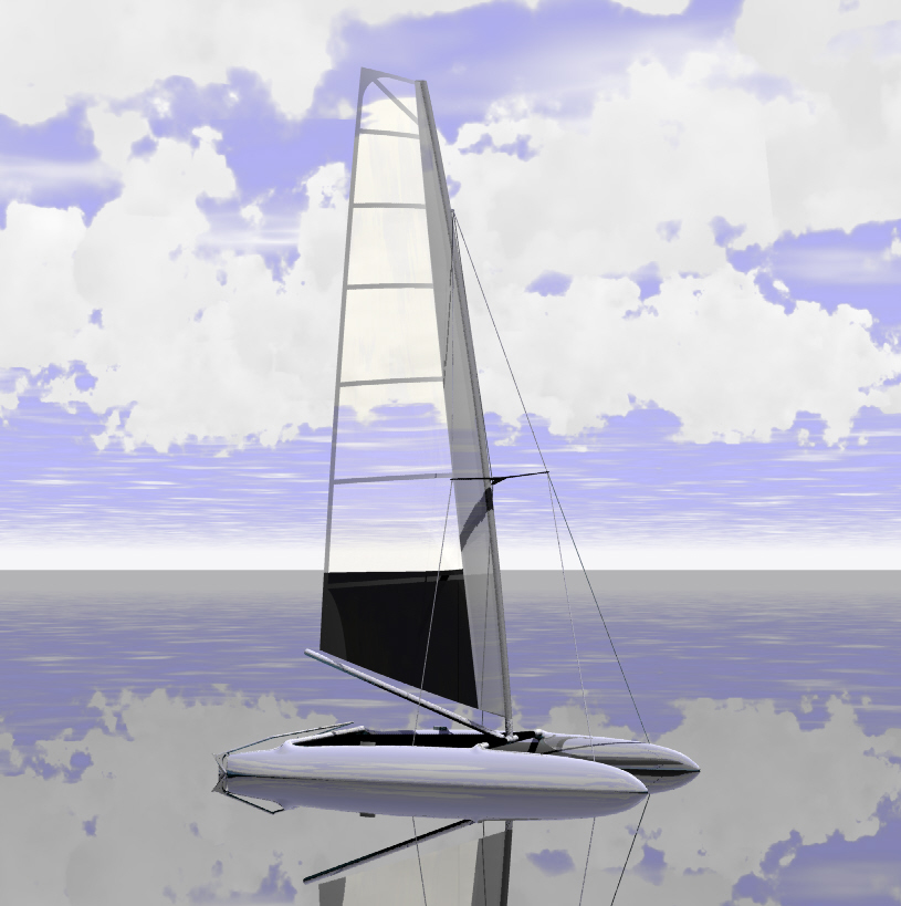

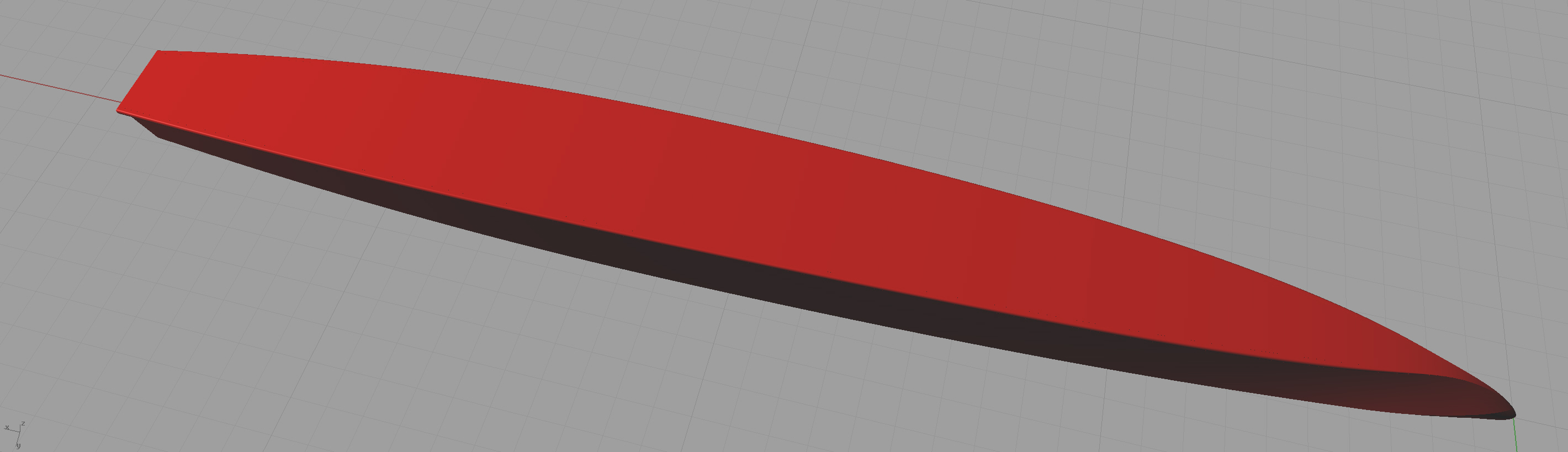

Re: Kids F12 - 11/03/07 08:31 PM
rendered from below
Stern View

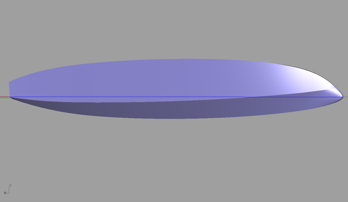

Re: Kids F12 - 11/03/07 08:32 PM
Bow View

Posted By: Anonymous
Re: Kids F12 - 11/03/07 08:55 PM
RG, will it have boards or no?
Posted By: gree2056
Re: Kids F12 - 11/03/07 10:10 PM
I like that, I can see a kid getting excited about a boat like that!
Posted By: isvflorin
Re: Kids F12 - 11/03/07 11:17 PM
Rhinoceros ?
Posted By: Buccaneer
Re: Kids F12 - 11/04/07 12:44 AM
Nice one... <img src="http://www.catsailor.com/forums/images/graemlins/cool.gif" alt="" />
Posted By: Seeker
Re: Kids F12 - 11/04/07 03:57 AM
Ahhhh...Retiredgeek the right CAD tool in the hands of someone who knows what to do with it...great start...question....is there any reason why you did not put more volume lower in the hulls?... as has been the design trend lately? Your drawing shows the bow shaped (in profile) somewhat like a “wave piercer" (please no tangents on what constitutes a wave piercer from the peanut gallery)…but the hull volume distribution in cross section looks more "old school"... any particular reason for this? If I understand you this rendering is something you quickly threw out here as a starting point with refinements coming as your schedule allows. Nothing like a high quality, esthetically pleasing rendering to get things moving out of the doldrums.
Best Regards,
Bob
Posted By: gree2056
Re: Kids F12 - 11/04/07 04:08 AM
I would be willing to bet that the wave piercing hull is just for looks, I don't think that the boat will actually use the ability much, but it does look cool because it looks like modern boats.
Posted By: Aerynt
Re: Kids F12 - 11/04/07 06:17 AM
Thought perhaps I should clarify a few things here, RG drew the hulls that my son's designed as a favor to me, the design is all their's and I seriously doubt it reflects RG's thinking.
What started out as me showing my son's Wouters preview drawing last Friday has now turned into a full on design project by them that RG is just assisting them with. Foolishly I said that if they really wanted new boats instead of my hand-me-down Paper Tiger, then they would have to build it (F12 like & wood) and figure out what worked, I have been seriously taken to task and Im sure my wallet will regret it.
What RG posted is no more or less than what my son's asked for help on and over time <perhaps not a lot> it will change, and given the chance Im sure they will probably totally redesign Wouters boat as they go <img src="http://www.catsailor.com/forums/images/graemlins/smile.gif" alt="" />
This is largely a product of having a single cat available for 2 sons that is often too powerful for even both of them to sail in much over 10 knots.
Happily, Im very proud that they have taken on the challenge, and are so eager to learn what it takes to design a boat, although at some point Im sure I'll regret having opened this particular can of worms <img src="http://www.catsailor.com/forums/images/graemlins/smile.gif" alt="" />
Just so no one is without doubt, RG just posted this to show what my boys think and want and its a long way's yet from something I'll let them start building, none the less, its a hell of a good start.
Aerynt

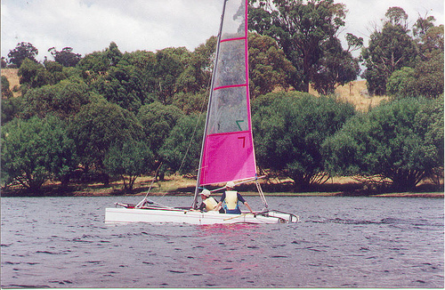

Posted By: phill
Re: Kids F12 - 11/04/07 11:05 PM
Bob,
Like the Glider.
13 ft long with modern sail plan, sails well with or without C/Bs, uni or sloop rigged and even a spinnaker if you want.

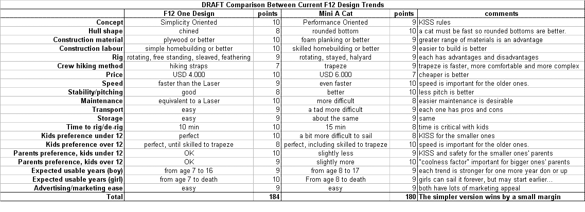

The target weight was in response to the talk on the F12 forum at the time. I did that sketch and then did nothing as the F12 appeared to be heading (at a rate of knots) away from what I considered was something worth spending my time on. The return to a genuine kids boat has re-ignighted my interest and I've set aside approx 1 hour a day (until its done) to produce a finalised design. The kitset price as quoted is based upon the original files and will probably come down with the final product. The "optimum" weight for the newer hull is marginally lower (45-50) but not much, as I envisage younger children sailing the boat 2 up and don't want the boat to become unusable with a teacher and student on board.
With 4 designs currently on the go, assuming Phill is going to unvale a Scalpel (small blade), is it time for us as a group to re-visit a set of class rules for these boats?

Posted By: JeffS
Re: Kids F12 - 11/06/07 12:16 AM
Heres a picture of my then 3yr old son on my old boat, I know the sails are all wrong etc and its embarassing to post but he's the one who's going to sail the F12 and the first new kids on F12's who see adults on the wire will want to be out there. I was strict with him I didn't let him stear the boat from the wire until he was 4
regards
Re: Kids F12 - 11/07/07 07:46 AM
OK, here is my design, a bit modern for sure, but 11 kids have seen it now and all with no exceptions wanted one yesterday. Whether the rest of the planet is of the same mind, only time will tell.
I designed this so it will have 2 hull options, most of the pic's that follow are of the hard chined version because that is what I believed would spark the initial interest, the round bilge version (similar profile) is based around my new F16 design with the appropriate changes and is more geared to older kids, a conventional rig and traps, perhaps even a kite. I'll finish this version as time or interest permits.
To get the round bilge one out of the way, its the first pic, all the rest are of the hard chined version.
I should also note that everything is within Wouters posted guidelines except for the luff length which is just a bit longer.
RG

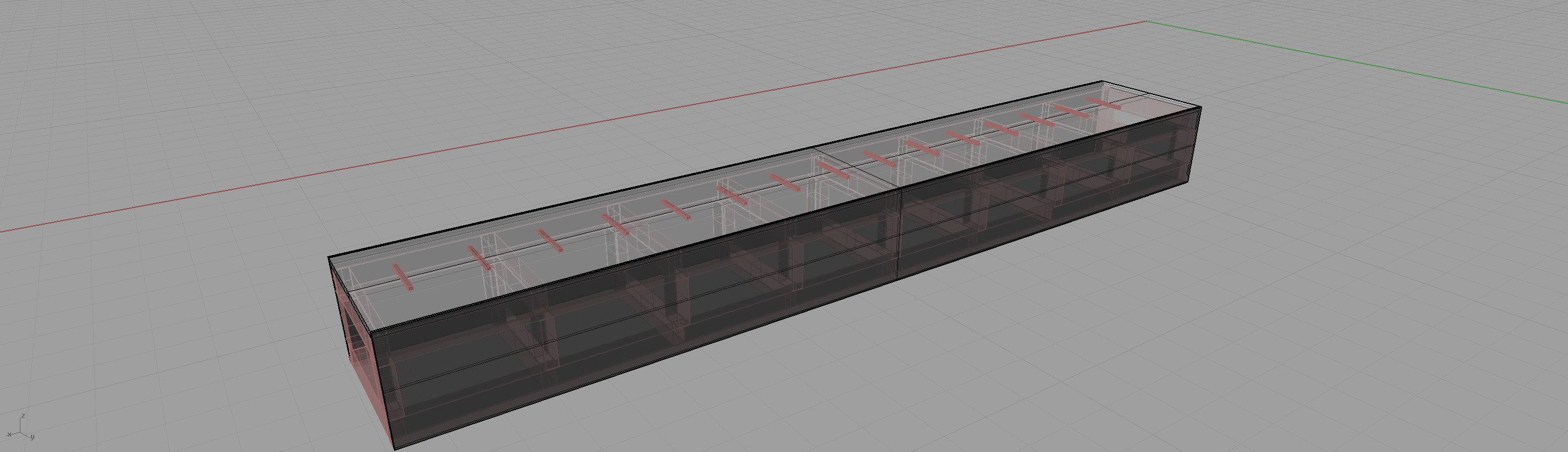

Re: Kids F12 - 11/07/07 07:47 AM
#2

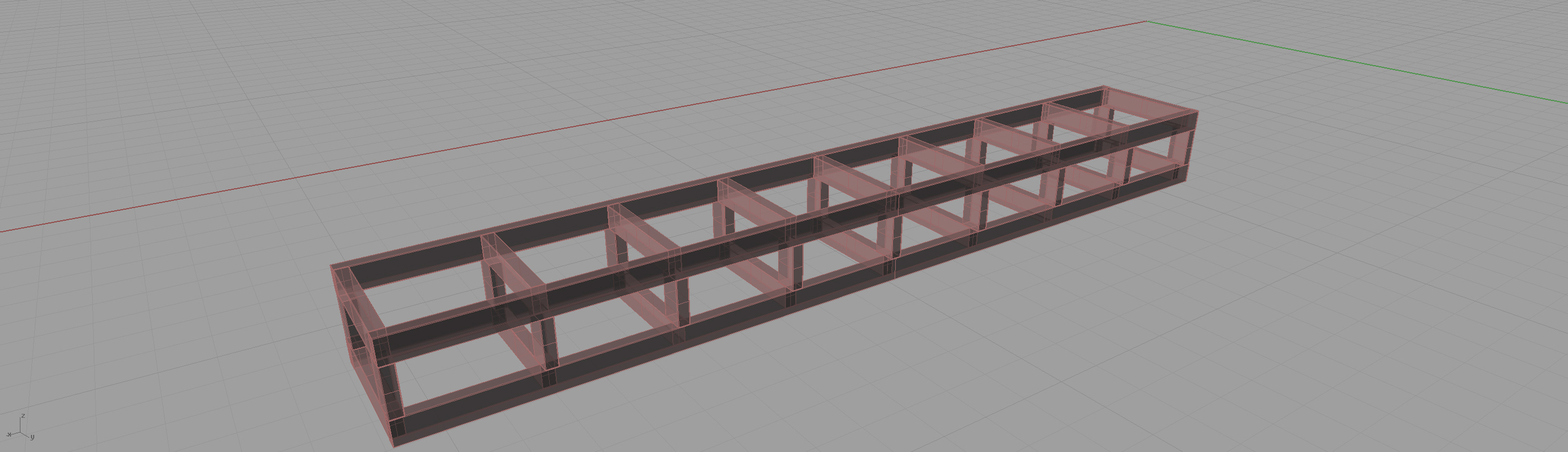

Re: Kids F12 - 11/07/07 07:48 AM
#3
Re: Kids F12 - 11/07/07 07:49 AM
#4
#5

Posted By: Wouter
Re: Kids F12 - 11/07/07 08:18 AM
The luff length as given by my was determined by the stiffness of the mast and what I know will work from my class 5 landyacht sails. It is not a hard boundery. I'm already thinking to stiffen up the mast to have it bend less and allow the battens to pop more easily in light winds. This desire coincides with the desire to use the same section for the beams and the bottom part of the mast.
How much is your luff longer ?
Re: Kids F12 - 11/07/07 09:17 AM
Thanks for sharing RG. What's your target crew weight? Also curious about the narrow transoms. What's the thinking behind that? I know your A cat hulls are also narrow at the stern, but also through the whole length I think, so this seems like an interesting departure.
Re: Kids F12 - 11/07/07 10:06 AM
Mark,
65 kg would be the max if you raced it but I put enough in it so its comfortable at 120 kg (kid & adult) also. Best range would be 40-50 kg.
Hull transoms and/or narrow hulls have nothing to do with narrow, its all about slightly lower drag and minimizing the pitching. The 2 hulls show are actually quite different but both do the same thing more or less. The round bilge hull has more than 8% less WSA, is more than 6% fatter and almost 10% more WPA and a fatter transom than the hard chined version, yet the pitch rates are almost identical (within 1%) so just looking at physical sizes has very little to do with the dynamics. The thing you might have missed is that the chine goes downwards for a long ways aft before it rises again, is quite good for keeping the transom out without having a big fat shape at the back that just drags water. The other thing to remember is that if you can keep the pitching under control, you don't need a lot of reserve buoyancy at the back to counter stuff thats not happening.
197mm longer
RG
Posted By: Aerynt
Re: Kids F12 - 11/07/07 10:48 AM
I would have thought that the narrow transoms would help sit the back down when your aft in a blow and make keeping the bows out easier, no ?
Aerynt
Posted By: Luiz
Re: Kids F12 - 11/07/07 03:56 PM
OK, here is my design, a bit modern for sure, but 11 kids have seen it now and all with no exceptions wanted one yesterday...
That's really great! I want one too! There are hundreds of positive things I could say, but they wouldn't help as much as some constructive observations:
1) That gooseneck looks like it would "bite" the fingers. Would it make sense to use the Laser standard system - and perhaps the same boom as well? Maybe another boat's standard system that fits?
2) Each mast support tube is curved near the extremity to enter the deck perpendicularly, when a straight tube cut in the right angle would be easier and cheaper to manufacture. Is this for aesthetic reasons, to provide a better holding point when hiking/trapezing, or for yet another reason?
3) Why the rudders seem to have no Ackerman compensation? It would probably facilitate manouvers.
4) I'd like to know if what Wouter wrote about daggerboards stands true with this design. How much would be lost if one daggerboard was eliminated? And without daggerboards? Would it still beat a Laser? In my opinion, the boat just has to outsail the Laser. Faster than that might be too much.
5) Is there anything else that could be done to simplify or improve its maintenance, use and safety?
Built in beach wheels that double as fenders/bumpers when raised? Hard tramp? A **** for safety? Back rests? Single rudder? More grab points for beaching? Butterfly nuts in the bolts that attach beams to hulls for easy assembly? Standard righting pole? Reefing system? A shark's mouth painted in one bow and a big smile in the other? (just brainstorming).
Great job!
Posted By: Seeker
Re: Kids F12 - 11/07/07 05:24 PM
Very interesting...great start.
Comments and Questions:
1) Any reason for not putting more volume lower in the hull?
2) The profile looks hot but the head on view makes the hull cross section look quite dated… As if you have a very up to date profile, but a 20 + year old hull cross section.
Is picture # 123637 depicting the same hull as shown in picture # 123641? It may just be an optical illusion… but the picture shown with the rig on it looks like a “stretched out version of the non rigged hull. The picture of the hull ( #123637) looks stubby in comparison to the hull in picture (# 123641)
3) If you are going to have dagger boards why would you want such a deep V hull section? Small mono hulls are fun because they tack “on a dime” Would not a flatter bottom shape make the small cat tack much easier?
Best Regards,
Bob
Re: Kids F12 - 11/07/07 09:04 PM
Luiz,
yup, the gooseneck is a mess but the piece it's mounted on is tricky, first the tube there is a clamp (2 half shells that open so you can rotate the mast into place, this just leaves the aft half to attach the braces to and you can't rivet anything to it, so whatever is there will have to be welded, next the right angle at the outboard end of the braces goes into a molded recess so the whole brace just drops in vertically, this gives us more bearing area and holds the brace in position while you rotate the rig up to the clamp, seemed like a better way than trying to juggle to pieces that can move at the same time.
As for the rudder compensation, I just hadn't got around to doing it yet, rudders came off the F16 design which has canted hulls and so its not necessary.
As for boards, a quick look showed that the leeway angle was excessive without them, so they got put in.
Bob,
Lower volume is no problem, just use the round bilge version of the hulls, I had thought that the reason to do hard chine hulls was so that it would be easy to make these from playwood and keep it all cheap? The hulls are all the same in the pic's, its just the perspective. As for the deep V, due to entry limitations that are inherent in what you can twist play into, the waterline sections in a hardchine boat are quite draggy, you can offset that a bit by keeping it narrower but that gets you a deeper hull. I don't think there is a perfect answer to this one, it really just gets down to your choices and what you want.
RG
Re: Kids F12 - 11/07/07 11:36 PM
apart from the fact that it adds a little scale to the picture, every boat should be sold with one of these <grin>
cheers
RG
Posted By: JeffS
Re: Kids F12 - 11/08/07 01:15 AM
RG your a very naughty boy in two ways. Firstly my children and I would be ecstatic to hike out on that boat not really sold on the bars yet but happy without traps. Secondly I was hoping that boys would consider that rocket to be better than sex and therefore only be after my daughters for their boat <img src="http://www.catsailor.com/forums/images/graemlins/grin.gif" alt="" />
Posted By: Wouter
Re: Kids F12 - 11/08/07 08:15 AM
Why have a gooseneck at all. The mast is non rotating and the boom can even be totally free handing.
I think it is actually a drawback to use a conventional gooseneck, it will only prevent the rig from totally weathervaning or even being sheet out fully when on a dead downwind course.
As the mast section is round, one can just have a fitting on the end of the boom that is a fork and have that slide over the mast. Well, at least that is how my design has it.
Posted By: Wouter
Re: Kids F12 - 11/08/07 08:49 AM
Allow me to play the devils advocate.
I did some spec checking and I compared some aspects of RG's proposal to the stated design goals.
RG wrote to me that he used a copy of the Moth rig in his drawings. The Moth rig is not an unstayed rig and it is highly unlikely that an unstayed mast will remain as straight a given in the pictures when loaded up. The Moth rig is actually 8.00 sq. mtr on a 6.250 mtr mast. More specs of other boats can of course be found on : http://www.xs4all.nl/~whijink/F12/
RG's design looks very well and is very succesful in attracting the sailors to the F12 idea. That is a very important development. Without some good promo the F12 project will be struggling. I too appreciate that very much.
Still, I'm a little bit at a loss in how to incorporate this design in the larger F12 scheme. Afterall it is basically his LR2 A-cat design scaled down in size with a Moth rig on it. Neither of these components is particulary inexpensive or easy to (home)build. But homebuilding is indeed regarded as the way to kick-start the F12 class till a more professional builder can be convinced to invest in the project. Of course the chined hull construction, as also shown by RG himself, is alot more in line with these design goals. It may be wise to focus on that part of the design and forget about the fully rounded version as I fear it will really problematic to prototype and build the class on the fully rounded version. We shouldn't give people to wrong idea by showing that version around to much either, for I fear they will never "get" the fully rounded version.
At this instance we must also appreciate how problematic it can be when the class is started and grown initiallly on the chined hull version only to have a professional builder do the rounded hulls later. Will all the boats build in the initial stages by outdated by that, how will their owners react to that, will they even consider building the boats when they are aware that such a thing may happen later. Such considerations are simply skipped over now.
RG comments on how chined hulls are draggy, or at least when compared to say his fully rounded hull. This may give further weight to the problems of transitioning from chined hulls to rounded hull later in the existance of the class. But I also believe it misses the F12 point somewhere. Indeed it stands to reason to expect the chined hull to be more draggy, but how important is this in the greater scheme. A Hobie 16 is seriously outdated in relation to say an F16 but the performance difference between them is only 15 %, most of it coming from the differences in the rig and overall weight. How much of that difference is the result of having inferiour hulls and lacking daggerboards ? Take a look at the Paper Tiger, a chined design that nobody regards as being slow.
This leads us to the following question, which is a very important one for the F12, how much additional cost and building effort is say 5% additional performance worth ?
It shall be obvious that I take a totally different take on things. I feel that it is far more valuable to have a very easily and inexpensively build F12 and work that quality into class growth. I don't believe that losing an X amount of performance (limited to 15% at max) is "worth it" if the class is strickt One-Design and will be beating a laser dinghy anyway.
At a certain point enough is enough and at that time there is more to be gained by optimizing the building time and costs. For a concept (sailing class) to be succesful, the whole picture must be right not just a few parts of it.
Welding ? Something I really tried to avoid in the F12 design. Homebuilders can not easily do it. It is also not needed. The same with bending the tubes.
Daggerboards have been covered already. Interesting to note is that assuming a chined hull is more draggy then it may well be more resistant to sideways slip ! I've sailed boardless cats for a long time and the pointing difference between say a nacra 5.7 and a nacra 5.8 wasn't very large at all. It is to us to decide whether the difference is large enough to decide to use daggerboards on the F12. In this balancing act we must not forget that daggerboards are a custom made item and do indeed add building costs and complexity to the design. They are also one more thing to get broken. To us the decision whether the advantages outweight the drawbacks.
Four of the more important design goals as stated explicetly last january were a F12 that could be build for 3000 Euro's or less by a relative homebuilder in 100 hours or less, fully rigged and derigged in max 5 minutes and fully assembled/disassembled in max 10 minutes. I still believe these to be critical for the succesful launch of the F12 class; otherwise I too would just have taken a CAD drawing of an F16 and scaled that down while replacing the 6 in the class logo by a 2.

Yes my kids want one too! <img src="http://www.catsailor.com/forums/images/graemlins/cool.gif" alt="" />
But the high aspect dagger boards are going to get whacked… I caste my vote for going with low profile boards (2/1 max.) for the kids.
Re: Kids F12 - 11/08/07 01:04 PM
Aerynt called me tonight with another angle, his eldest son thinks it will be a babe magnet and is very happy about it <img src="http://www.catsailor.com/forums/images/graemlins/smile.gif" alt="" />
RG
Re: Kids F12 - 11/08/07 01:10 PM
As a kid we used to have a half round welded to the boom that sat on an upturned oar rollack (plastic) that was riveted to the mast, vang held it in place and while it got chewed up in a season, could easily be replaced and was cheap. Problem here is that we have slip fit everything and you can't rivet into slip fittings....one way or the other even with this suggestion, you have to weld something
RG
Re: Kids F12 - 11/08/07 01:31 PM
the first pics you got were indeed a scaled moth sail, but in case you hadn't noticed I redid everything for the pics that were posted, so thats irrelevant.
No its not an LR2, even an idiot can see that, but it does use a few tricks from that, but more so from my new F16...Oh and btw, the 3 LR2's were built at home, just by 2 skilled guys <img src="http://www.catsailor.com/forums/images/graemlins/smile.gif" alt="" />
While the round bilge version will take more time and probably a bit more skill it will win races (and there will be some over time) and it does look nicer.
As for building an F12 in 100 hours, your dreaming, for your average homebuilder (first time round) I'd say 400 hours was optimistic if not impossible (and in case you didn't know Ive built over 30 boats over time....and I think about 14 of those were wood) In case anyone wants to see what's inside a Paper Tiger go here.... http://www.bur.st/~h20melon/other/building/The%20Building%20of.pdf ... and then tell me if after you have looked at the pic without the deck whether your going to build that in a 100 hours. And thats just 1 hull <img src="http://www.catsailor.com/forums/images/graemlins/smile.gif" alt="" />
As for the draggyness of hard chined hulls...your comparison is invalid cause they weren't hard chined and a boat's performance is always (no exceptions) the sum of the drag angles (read Marchaj)...under no circumstances does drag make you more resistant to slip or improve your leeward angle.
RG
Re: Kids F12 - 11/08/07 01:36 PM
How much harder to make the rounded hulls? are we talking another day in the building or another week? That boat is fast out of the water! RG do you have plans on the building of it yet.
The round bilge version would have to be done as a strip planked foam hull, then glassed and faired, in some ways quicker and in others slower, I'd guess that with 2 people a single cat this way is about 6 weeks work (500 hours approx) if your reasonably experienced. For a beginner I'd add another 200 hours.
RG
Re: Kids F12 - 11/08/07 01:40 PM
Can change the profile to suit in a blink, and yes high AR tips can get ground down, but if they forget to lift them, you just have a longer chord to repair <grin>
RG
Re: Kids F12 - 11/08/07 01:53 PM
Now for the good stuff....some decent renderings of the hard chined version
#1
Posted By: _flatlander_
Re: Kids F12 - 11/08/07 01:55 PM
RG,
With all due respect from me as well, and heaps of appreciation for your participation and contributions.
Have you read all the previous posts begining with and including "Youth Recreation Trend" on the big forum from approximately one year ago?
While 100 hours may not be realistic for one amatuer on their first go, it should be an ideal, or easily attainable by a group of builders, i.e. a half dozen father/sons building a half dozen boats at the club over a weekend.
We've all let go of our "must haves" regarding catamarans (trapezes and the like) to strip ourselves down to #1) the mentality of child just learning to sail and about sailboats and #2) a parent who potentially is just learning to sail and about sailboats.
The daggerboards, and trunks, are a maintenance issue. A move in the wrong direction.
My two cents.
Thanks
hard chined #2
hard chined #3
Re: Kids F12 - 11/08/07 01:56 PM
hard chined #4
Re: Kids F12 - 11/08/07 01:57 PM
Now for the round bilge design
#1
Re: Kids F12 - 11/08/07 01:58 PM
round bilge #2
round bilge #3
Re: Kids F12 - 11/08/07 01:59 PM
round bilge #4
the last one
round bilge #5

btw, those moth photos are not of Rohan or his boat. It is a UK developed moth, home built actually! I think by one of the top UK moth sailors, he may've won the previous world championships between Rohan's wins.

Like ncik, I too was worried about the loss of section moment in the main beam if you put the mast through it, plus 4 attachments for the x-brace makes for a hassle if you ever have to tear the boat apart. Also, means 4 more attachment reinforcements to the hull.....just seems like a lot of fiddly stuff.
Personally, I'm not leaning in any direction, just find it fun trying to deliver something everyone wants, quite a nice brain teaser if there ever was one.
Did the 75kg crew hull, gunwhale is the same, profile the same, just changed the chine, was a nice surprise that the drag coefficient for the hull went down, but not as much as the wetted area went up, so nett gain is to drag (0.7%) but it does produce more lift (sideways) and the overall hull L/D is up by 1.3%, so point will be higher as will VMG
Jeff, my wife is 61, so its a safe bet she'll go for whatever is easiest....more amazed that after all this time she actually wants something I designed <img src="http://www.catsailor.com/forums/images/graemlins/smile.gif" alt="" />
Pics of 2 hull comparison attached
RG
Re: Kids F12 - 11/09/07 07:58 AM
2 hull comparison #2
Re: Kids F12 - 11/09/07 07:59 AM
2 hull comparison #3

A thought came to mind while looking at RG's renderings. Have any of the people considering free standing rigs considered the option of using the dolphin as a socket. ie use an oversize striker tube and then run a X pattern of straps rather than the traditional St. Steel strip. It would then allow you to get rid of the struts.
Yes, Phills design is far more along those lines. I think he is also used in pod in which you can just drop the mast.
I eventually decided against this as the unstayed rig will need to be supported both along the centreline and perpendicular to the centreline. In effect you'll need to dolphin strikers then with one running along the centreline to the rear beam or something. I my opinion this comes close to have the famous kneeknocker bar of the old Nacra 5.2's. Also I feel this contruction is both more complex and more expensive then the push rod setup.
The push rod setup have other advantages as like much lover stresses in the involved components. But I won't go into detail here. The pushrod setup is also simpler and quicker to homebuild as it can be made up of plain parts like round alu tubing and standard marine hardware like eyebolts, threaded forks, plain bolts and clevis pins. There is no bending of straps or tubes involved.
Two added advantages of the push rods that I was after are the ease of sliding the F12 on its beams on the supports (plain plancks or beams) of a trailer or roof rack and the ability to grap this structure by the sailor when getting back on board or handling the craft.

Thanks RG for doing the comparison of the Original to the 75kg hull design…from what I can tell from the renderings it has confirmed my assumption…
The depth of the hull, width on deck and general design shape appear to be very near the same (at least at the cross section you provide) with just the width of the hull at the water line increased by about 1”…if this is the case, it is very hard to argue that increasing the F-12 design parameters to a crew weight of 75 kg would spoil anything in the way of safety, ease of use (weight), handling or performance for a younger child. It appears as if there is a mind set that sees all these little optimist sized cats flooding the sailing scene when in fact a boat capable of handling a greater crew weight would serve a greater variety of size kids, have a wider appeal to parents as their child will not “outgrow” the boat so quickly and as such, be more economical to own.
regards,
Bob

Pretty much all F12 designs presented so far could carry more weight, but that doesn't mean that the competitive weight range is expanded to 75 kg.
Compare it to a F18 carrying over 200 kg (over 420 lbs). It can do it without any problems but you still won't be competitive with crews weight 145-155kg.
It is the same with the F12. The design was always intended to be able to carry more weight recreationally as it was agreed upon early on in the project that a parent with kid should be able to sail it (when the child first learns to sail it).
When we talk about a (competitive) weight range running from 40-65 kg than we are refering to youth RACING and not recreational sailing. Of course, adult can race this F12 as well but then to make things fair we need a minimum crew weight rules and split the racing in to groups.
the youths : 40-65 kg
the adults : over 65 kg
The adult will go around the course slower then the youth but as all adults will go slower by equal amounts the racing inside a group will be fair again.

Mark II CTMD F12, sorry I'm not as good on rhino as RG. Jeff, yes you could use rotating centre boards, however I will show daggers as standard. [Linked Image]
Re: Kids F12 - 11/19/07 11:19 PM
Chris, since you've stuck with a stayed mast and dolphin striker, are you considering the possibility of a trapeze?
And target crew weight is still 45-50kg, yes?
Re: Kids F12 - 11/19/07 11:58 PM
Mark,
target crew weight is still 45-50kg (I've left some extra freeboard in to cater for heavier crews or two people).
The concern with trapping is the extra compression load applied to the rig. The rig I'm looking at is designed for a two person, one on trap dinghy (MG14). With a 60kg person hiking on the cat the mast will experiance similar loads to what it would see with one person trapping on the less stable mono. I've gone with this mast at this stage because its similar in shape to most modern cat wing masts and because fully rigged it will be less than 6kg (a weight that will enable kids to rig their own boats). If you wanted to be able to trapeze its only a matter of talking to whoever you buy the extrusion off and discussing what section they would recommend (you'll propably end up a couple of kgs (4lbs) heavier at the most). The beams and dolphin striker as specified would be fine.
Re: Kids F12 - 11/23/07 07:47 AM
Final Hull, this is a compromise shape between speed and being easy to handle and the result of a whole heap of VPP runs....while it looks similar to the previous stuff, the transom is wider, rocker is changed slightly and is both wider and narrower in places (just a few mm here and there).
The really good news is that I now think I'll have (not a promise, just an optimistic guess right now) about 5 boats building by Christmas so about February/March we should have some on the water pic's and performance reports. Wish I could do it faster, but I think this is a realistic time frame. Will post pics of the builds as they evolve. As I was changing the hull up until yesterday, cutaway pics are still a week or so away.
Enjoy the new pic's
RG
Re: Kids F12 - 11/23/07 07:48 AM
Latest Hull #2
Re: Kids F12 - 11/23/07 07:49 AM
Latest Hull #3
Latest Hull #4
Latest Hull #5
Re: Kids F12 - 11/23/07 07:50 AM
Latest Hull #6
Re: Kids F12 - 11/23/07 07:56 AM
Forgot to mention that I have 2 people interested in the round bilge version also, If Im lucky, the first of those might start building in Jan-Feb 08
Re: Kids F12 - 11/25/07 12:56 PM

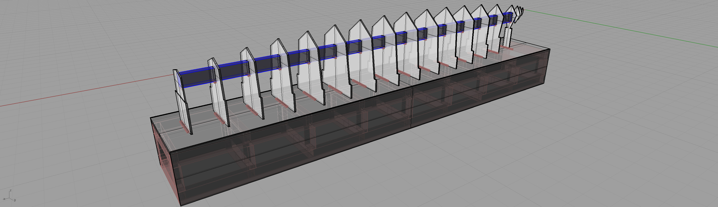

The following attachments should give you an idea of how I think the hull jig should go together, this drawing is not yet complete....if any of you want changes, speak up.
Pic #1 the base box, made of 2x4 or 50x100mm, kiln dried so it won't warp and nice and heavy so it won't move.
Pic #2 plywood wrap, 25mm on top and 12mm on the sides
Pic #3 12x15mm cleats screwed to the box to attach the frames to
Pic #4 Frames get attached (12mm thickness)
Pic #5 Upper cleats are attached, these could actually be attached prior to attaching the frames
Pic #6 Frame beam is inserted
Pic #7 Hull in the jig
The front 3 frames that aren't attached to the base, I'll explain how that works once I get the rest of the drawing done.
The next 3 frames moving aft will be detachable and can slide aft when your ready to lift the hull off. This is required because of the tumblehome.
The rear frame is notched so you just have to sit the transom sheet in place to get it aligned correctly, all frames are notched on the outboard edge to help hold the side panels in place correctly.
RG

Pic #2

Pic #3

Posted By: Luiz
Re: Kids F12 - 11/25/07 06:10 PM
I would strongly prefer to have the boom above the attachment points of the push rods as then the rig can rotate fully around the mast which is very advantage (performance) when sailing deep. It also is a safety feature as any kid can let the rig weathervane completely when surprised by a squall or something.
A freehanging boom (possible with a fork at its mast end) is possible and most easy solution.
Not sure a reduction on mast height gains us much as its such a small triangle at the bottom that you gain, and that doesn't lower the COE very much. And I tend to agree with Wouter about letting the sail weathervane if required.
Also, don't see that the stayed rig is that much more complicated, but do agree that the freestanding is faster & easier to rig.
To my surprise, most who I have talked to so far have elected to go after the stayed rig because it will allow trapezing, and these are the kids talking, not their parents who don't seem quite as sure about the whole thing. In the words of one kid.....why should I hike all day when I can trap and go "zoom"
You are both right. Besides Optimists, I sailed with fork type goosenecks in Penguins back in the 70's - with rotating wingmasts! It is very simple, efficient and inexpensive for small boats exactly as you say. Note that it was not possible to weathervane the Penguin due to the shrouds (unlike the Optimist), so the fork solution is ideal for the free standing rig only, not so for the stayed/trapeze rig.
Two divergent conceptual paths (trends) emerged and are being followed:
a) Simplicity oriented, with chined hulls, free standing rig, hiking straps, cheaper price. It is essentially the original F12, but I'll call it F12 One Design.
b) Performance oriented, rounded bottomed hulls, stayed rig, trapeze, normal price. It is essentially a Mini A Cat.
I guess it is ok to follow both trends until a clear winner emerges. Still, we already know that the Mini A Cat will end as a scaled down A Cat, so we could just as well follow the F12 One Design path only and in the end compare everything to a scaled down A Cat - including the class rules.
I made my own spreadsheet to rationalize the decision process and it indicates that the F12 One Design wins by a small margin, basicaly due to simplicity and costs. The other differences more or less cancel themselves. Sorry, could not upload the spreadsheet as is, just its picture.
Re: Kids F12 - 11/25/07 08:02 PM
It might not be necessary to assume that a trapeze version goes with the round hulls and higher construction skill.
I note that your spreadsheet indicates a target age range that spanning both Wouter's original target and the younger kids that others favored. Not sure if this is generally agreed by everyone else. Still interested in knowing the ages of the kids RG is talking to.
Also curious whether "one design" is still the consensus. My impression was that Chris and RG are both pursuing separate designs with the expectation that they will both fit into the box rule defined by the measurement form they put together.
Posted By: Luiz
Re: Kids F12 - 11/25/07 09:34 PM
Agreed. The end of the process is to add all positive features we can to the best concept, regardless their origin, but sticking to the chosen concept.
Yes, but note that I am spanning the original age range with two up.
As Wouter wrote, a cat that is optimal for 12+ year old kids is also a very good choice for a couple of kids under 12. This adds a very important marketing feature to the class, for then it will be a strong replacement/competition for both the Optimist and the Laser - while interfering little with the original goals.
Also, note that this is a tough feature to replicate in a monohull class: a Laser can be sailed by two small kids, but it is hard for them to keep the boat upright when tacking and jibing (have you noticed the high beam of the Optimist? It's no coincidence).
The cat's high initial stability makes life a lot easier for the small ones. I think we must use this advantage in our favour as much as possible, if anything because we can't get read of the inherent disadvantage: the tendency to go to irons when tacking.
The trapeze is a source of interference with the original goals. If we accept that it is indeed advantageous for the class to target this segment (startup boat for ages 7 to 12), we'll have to analyse this feature carefully, for it leverages the advantage that kids over 12 have against two smaller ones.
Good point.
The problem with a formula is that parents start competing to see who spends more on the kid's boat. This forced the Optimist to become a strict one design. Even with the narrowest possible rules, parents still find ways to spend a lot on their kids to give them an edge (buying high tech lines, gore-tex clothes, multiple foils, sails and hulls, etc.).
This is another interference caused by the increased age span. Younger kids' parents require strict one design rules, while older kids (and their parents) can live with a formula - and possibly have more fun with it.

I added the requested modifications to the spreadsheet. The file should be in your hotmail direction by now. See the "2" sheet. A picture follows attached, so nobody has to wait for the upload.
I'd like to comment (and read other comments) on the features of Phil's Blade 12, as posted in the Open forum:
- The mainsheet and rudder crossbbar setups are great, ideal for kids. This setup should be mandatory.
The dolphin striker receptacle for the freestanding mast is neat, but I like the struts better because the dolphin striker can hit a child's head when righting the boat, while the struts help coming back on board - besides other advantages we already wrote about.
Posted By: Wouter
Re: Kids F12 - 11/26/07 10:21 PM
I hate to say it but this part of the design is also 4 years old now :
See below the artist impression I made for Phill Brander in late winter 2003.
Notice the mainsheet setup ?
Phill is going to be really pissed at me, but I'm going to say it anyway. The time has come to actually produce a design and not more artistic impressions. It is great to see Phill has found a new person with much more advanced skills to make these flashy pictures but in the end of the day these are nothing more then a bunch of glowing pixles on a computer screen. It is time to produce detailed cost and weight tallies. Work out the materials used and the individual dimensions of the parts. Many will find that a few more snags are encountered here and will need to be overcome.
I really love how Phills Blade 12 looks and indeed we discussed its OD status as far back as 2003/2004. I was surprising to see Phill come out for a more open class rules based F12 class on this forum knowing he was fully working towards his own OD Blade 12 setup. This is confirmed by his own admission on the main forum. His pod like setup for the unstayed rig will most definately work. The mast design I have presented in this post can be used for his setup without any modification. It appears his mainsail is basically the same area the same as the sail depicted in the photographs (5.5 sq. mtr).
But the flashy picture do mislead people a little bit. The Hulls for example. These "appear" to be scaled down Blade F16 hulls with a rounded keel. Not even Phill himself believes that these can be homebuild without a serious building effort, meaning multi panel construction that is steamed into a rounded shape. Basically these hulls will not be much different in building requirement then the Blade F16 hulls. A multichine hull or even a deep V-ed hull design are much more likely to be chosen eventually and as such it will be much better to show these in the CAD drawings, like RG does. At least then we all see what we are getting into.
Either that or Phill will do best to clarify how exactly these compounded hulls can be made with very simple tooling and small time investment.
It is interesing to note that the OD class rules that I have written up earlier actually do NOT rule out the pod setup that Phill prefers. Basically, in that OD class both the rod and pod setups can be used legally. I would like to stress once more that the OD class rules are not SMOD and that apart from limiting a few design features in a very strickt sense, like the hullshape and the requirement of an unstayed mast, other aspects are left completely open to personal preference. I don't see any reason to not allow design freedom in these ways.
I do really like Phill Blade 12 and I always have, even though I have differed in opinion on some design aspects. But when made well the Blade 12 will be a good design.

Posted By: ratherbsailing
Re: Kids F12 - 12/10/07 04:56 AM

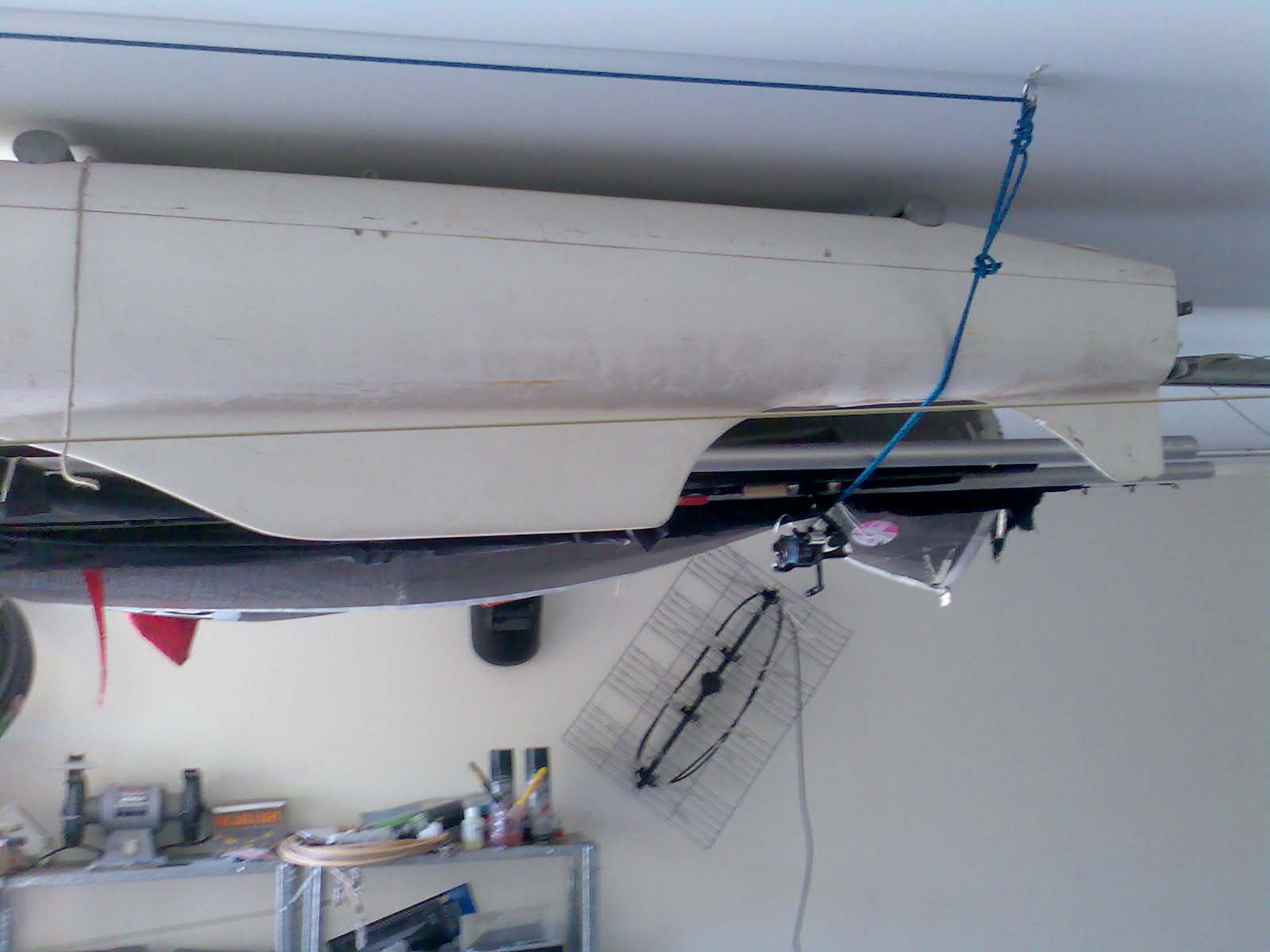

Ok i have searched the house and come up with the photos of the cat jeffs seen at my house. It's called a micro cat it's 8 feet long fiberglass uni rig and in the picture i was 7 or 8 years of age photo was taken at Milang in 1979. Dad told me it came from Western Australia and is the only one in South australia. so any one in WA mite no where they came from.
Re: Kids F12 - 12/10/07 04:57 AM
one more

Posted By: JeffS
Re: Kids F12 - 12/10/07 07:12 AM
Great photo's and thanks for posting them Danny
regards

and all of the internal stiffning will be replaced with sine wave stiffners
Sorry for going off-track, but what is a sine wave stiffener, and how does it work?

Berny said, "There's plenty about, several here in Australia and I'm guessing elsewhere in the world ..."
Flatlander said, "There are very, very few about in the US, at least away from the coasts. What does exist are Bravos, outside of this the only thing available here are old H14's..."
I just found another old attempt at a 12 footer, Canadian this time. It's a Mystere 3.7 skeg boat, 12 feet long, 6'6" wide, 19 foot stayed mast with single trap line, 190 pounds, 8.5 m2 sail area (but it has a jib).
The reason I'm interested in this is because I've owned a few Mysteres but better yet I just found one of these rare boats for sale! If I can "steal" it for few hundred bucks I'll grab it this weekend and have my 7 year old be the judge. <img src="http://www.catsailor.com/forums/images/graemlins/laugh.gif" alt="" />
EDIT: I just saw this boat and a salvage guy has it. Good sail, tramp, and straight mast but the rudders are lost. I just happen to have a set of M 4.3 rudders and castings. He wants $125 USD. Hmmmmm...I'll offer $95. My wife will kill me but it's gotta happen!
Mystere 3.7
Posted By: JeffS
Re: Kids F12 - 12/11/07 10:09 PM
Bloomin heck, to my untrained eye that looks like Wouters lines on his original design. Put the modern rig with light mast and I'd have that now.
