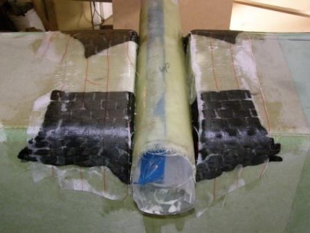

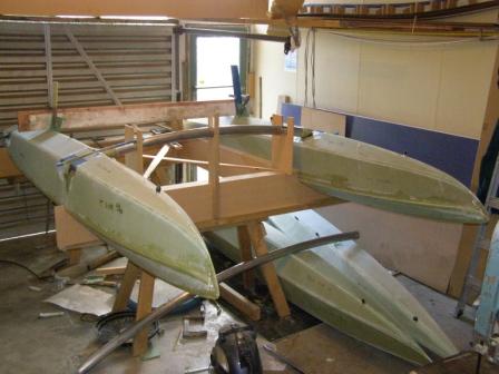

Posted By: billby
Re: Kiwi F12 Build Pics - 03/03/08 06:12 PM
Hi there, with a bit of experience and liking the comcept we decided that testing two was better than one, then setting up for two just as easy to do four so more people can experience them and we can make more of an impact when we launch.
Here's a picture of the two halfs together for those interested.
Posted By: billby
Re: Kiwi F12 Build Pics - 03/03/08 06:15 PM
Here's a photo of one hull being held together.

still moving forward all be it slowly here is the jig for setting up the beams(beams yet to turn up)and remember all things come right when you have a great class.
Posted By: billby
Re: More Kiwi F12 Build Pics - 08/14/08 05:22 AM
sorry that pic didnot work trying again(not as good as gato but sill coming along)

beam landings

Re: More Kiwi F12 Build Pics - 08/16/08 05:02 AM
About the beams>>> 1) What is the diameter? 2)Wall thickness? 3) Alloy?
4)Radius of the bend?
Bob
Posted By: RetiredGeek
Re: More Kiwi F12 Build Pics - 08/18/08 05:55 AM
Bob,
beams are 6061, 63.5mm * 3mm and the bend radius is 3.152m. Billy bent his beams to 4.0m as that was the minimum the benders could do, so they aren't quite flush with the deck. Beams are also sized by what we could obtain, 60mm*2mm would be adequate if you could get it.

more build pics - 11/01/08 06:17 AM
A few pics to show that work is still continuing :-) ... the hope is that they will see the water by Christmas
RG

One question though, are they carbon or glass beam sockets?
Yes, socket tubes are E-Glass and epoxy, but have carbon tabs/reinforcing to hold them in place and spread the loads
RG

So, in one way we went into the F12 concept the wrong way. We decided to go for a chained hull (wood) because it would be cheaper and easier to build. At least for my part I have learned something. Even if we keep the original idea of the kids participating in the building the foam/glass construction is easier. At least the foam stripping, that’s like making a jig saw puzzle.
Re: more build pics - 11/06/08 05:45 AM
At least its a fun jigsaw puzzle.....and it will keep on producing fun :-)

Oh good, it looked like there was carbon against the aluminium beams, which wouldn't be good.
