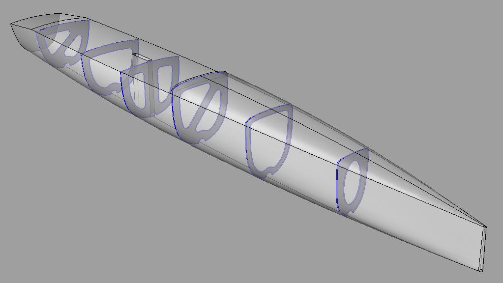

sshhh - 08/07/08 06:01 AM

Posted By: RetiredGeek
Re: sshhh - 08/07/08 06:10 AM
is that really as fat as it looks or is it just the perspective that makes it look that way ?
Posted By: ncik
Re: sshhh - 08/07/08 07:02 AM
It is wider than the first iteration, but still wouldn't consider it fat. Designed for 120kg displacement.

Posted By: Wouter
Re: sshhh - 08/07/08 02:32 PM
and at 120, or even 125kg design displacement, doesn't this makes the F12 more marketable? May be sold also as an adult trainer or appealing for Mom/Dad to sneak a ride on when the kids aren't around.
Didn't we realize this from the beginning ?
That we would have to design these boats to take also an adult and small kid (up to ten years old) or two kids simulatiniously; ergo at least 100 kg crew carrying ability for the F12 !
Combined with min boat weight this makes a minimal displacement of 150 kg ?
It is always better to sail a volumious boat light then sail a light displacement boat heavy.
Scarecrow, for what range of displacement is your DS12 designed ?
Re: sshhh - 08/07/08 08:18 PM
thats less than I imagined, must be the perspective. The Vudu's DWL is set at 100 kg, but even at 150 kg it sits in less than 40mm.

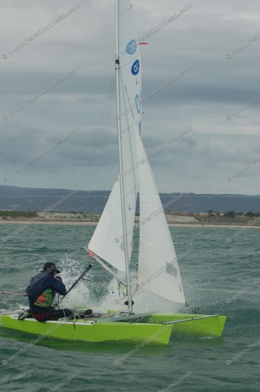

Posted By: JeffS
Re: sshhh - 08/08/08 12:07 AM
I agree that seeing adults on little boats is funny but they can take it serious too this adult is sailing an 11 ft marine ply, Arafura Cadet, designed 30 years ago, in heaps of wind and 2.3metre waves off Adelaide a month ago. Picture courtesy of Peter Muirhead's site.

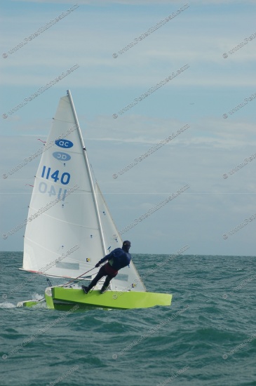

Posted By: JeffS
Re: sshhh - 08/08/08 12:09 AM
and another photo this boat is lighter than the DS12 despite being built 20 years ago.
I was so impressed I've purchased 2 to use at the club.
Posted By: Darryn
Re: sshhh - 08/08/08 01:18 AM
Which makes sense given the local fleet, kids will learn more sailing boat on boat then sailing an orphan, no matter how attractive the one off may be.
Your building a pair of F12s aren't you Jeff? AC rig would help get them on the water fast and you could compare the hull designs with the same rig.

Posted By: JeffS
Re: sshhh - 08/08/08 02:43 AM
Arafura's are minimum 36kg with all fixed fittings.
Heres a link to their sight
http://www.arrowarafura.com/
The 14ft Arrow is minimum 50kg thats why I dont see the F12 minimum weight as planned to be a miracle of modern engineering.

Re: sshhh - 09/28/08 05:42 PM
Had to go out once more before painting. There was 15-20 knots of wind. This is a fast cat.
http://www.gust.ax/gallery/f12/08-09-25/
Posted By: ncik
Re: sshhh - 09/29/08 12:05 AM
W00T!
Good to see the hulls had enough volume. Grown man on one hull!
Was it tempted to nose-dive?
Posted By: Gato
Re: sshhh - 09/29/08 05:47 AM
She is not prone to diving. Did dig in once, but that was asking for it. The DS 12 is diving faster.
It's sad that I don't have a rig for them both for the moment, it would be easier to compare, still I have the feeling that your cat is a little bit faster at least when it comes to max speed.
Posted By: ncik
Re: sshhh - 09/29/08 06:56 AM
Interesting! I wouldn't expect that because the developed linesplan was only aiming for a forgiving boat to drive, not necessarily a fast boat.
How long till you get a second rig and on the race course?
Posted By: Gato
Re: sshhh - 09/29/08 09:26 AM
The cat is both safe and forgiving, but in winds of +15 knots i'ts deffenetly alive.
