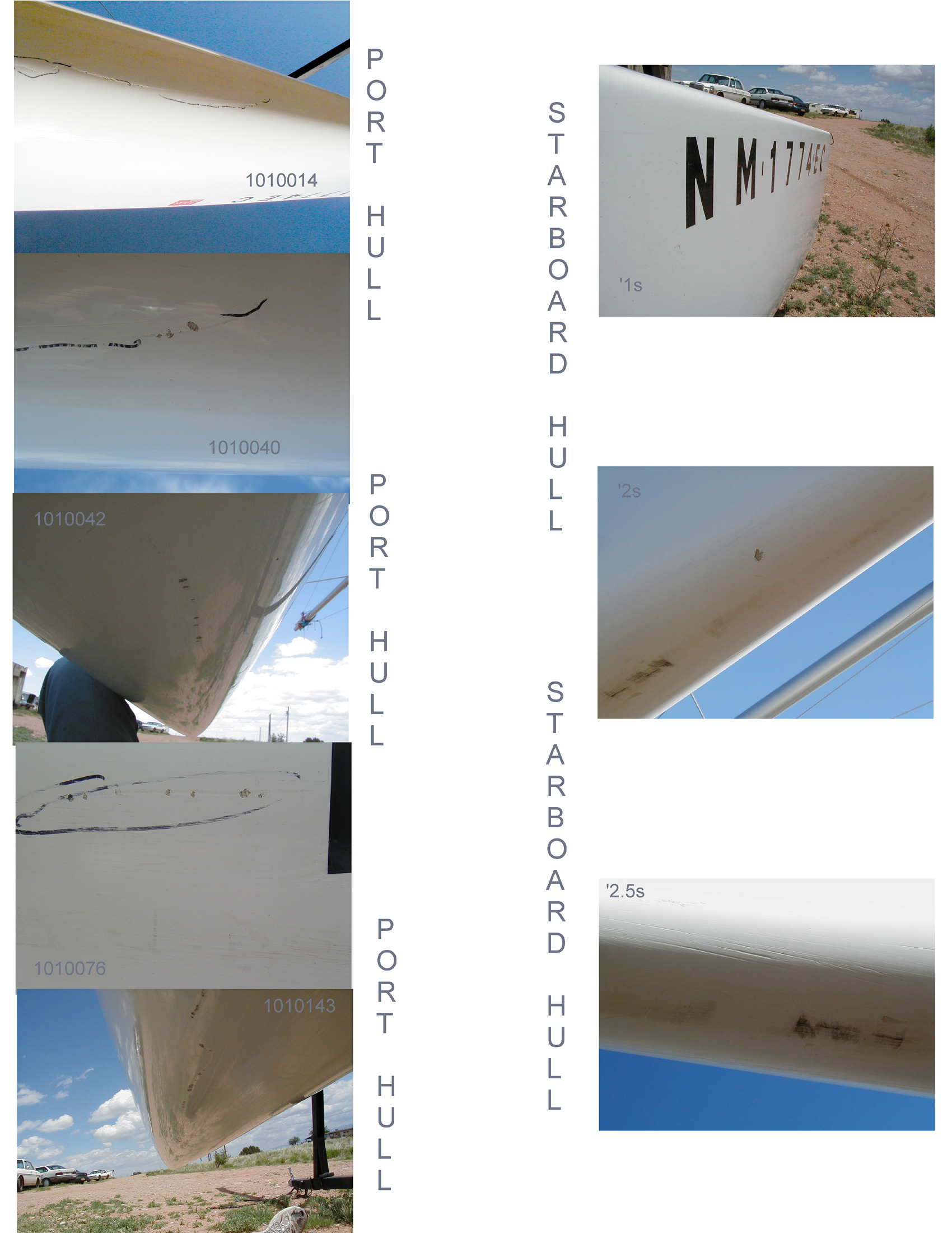

I took a bunch of pictures which wasn't that easy to do, something about a white hull against a bright sky. Any way I lined up the pictures, port on the left side of the page and starboard on the right, three pages of pictures and my complaint and sent them off to Matt McDonald at Vectorworks Marine. The response, after my prompting, was about what he thought of me and my sailing skills and several presumptions but nothing about my ringing question, 'why is one hull doing so well and the other is doing so poorly'?

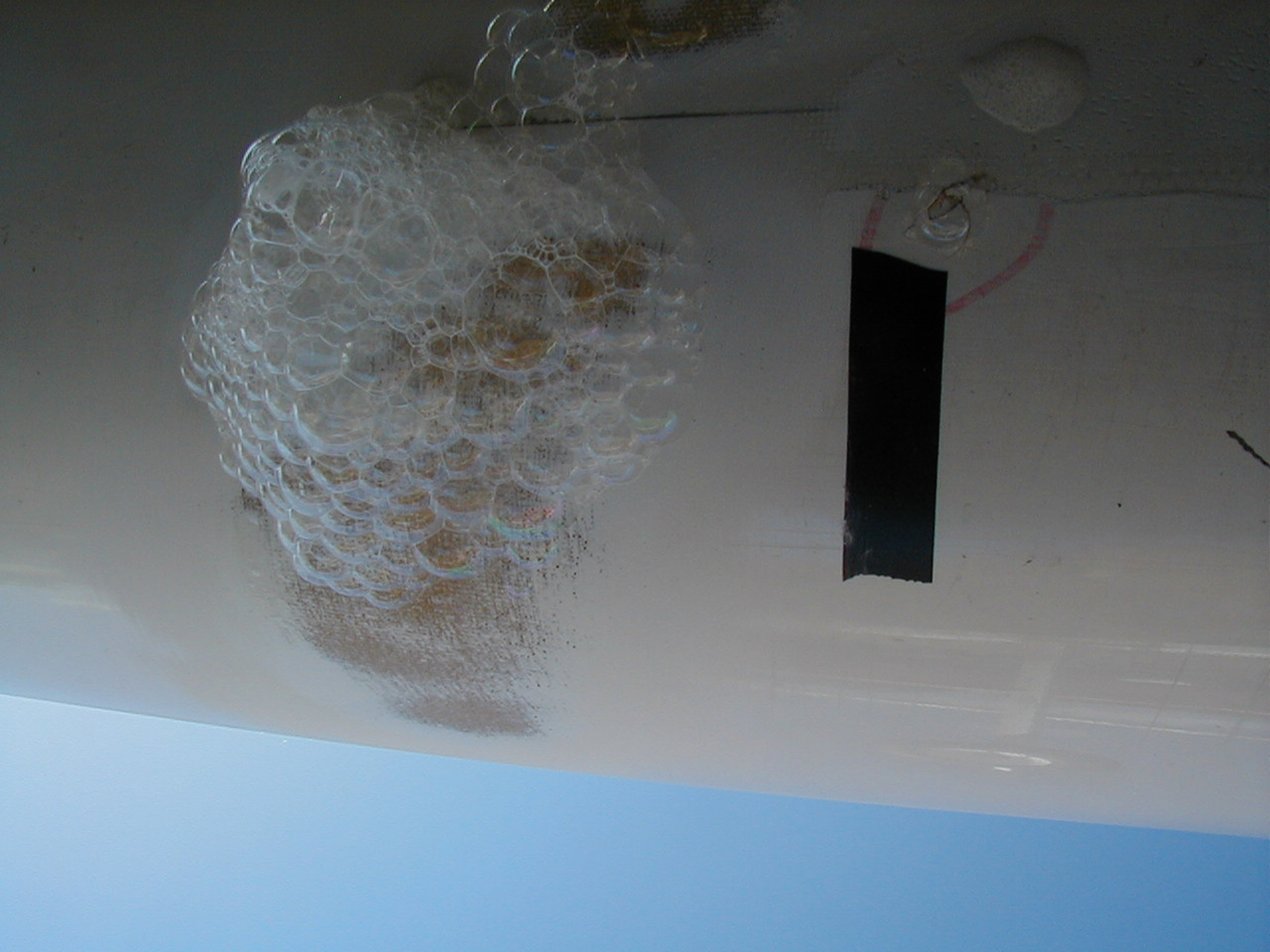

When I found this I felt quite satisfied that I'd found the problem, finally clear evidence that what I'd been sensing now has a reason. Although there is a composite structure where there is tensile strength of the fibers there is not enough resin to provide compression strength. It really depends upon the gel coat for compression strength which is okay but it's on the wrong side of the laminate, it's strong against a push from the inside of the hull but not a push from the outside. It wasn't until the next morning I asked myself, "but where are the yellow stringy fibers that they talk about when sanding Kevlar, why was I sanding into the laminate when kevlar can't be sanded and faired out?" Simple, it's not kevlar. It's fiberglass.
I took four pictures and sent them to 'you know who'. They accepted the mailing on 30 Oct. '07. I got the normal response, nothing.
I'm curious to know what others think of this very porous construction. I haven't found any discussion of this very lean composite. I can't visualize how that much resin could be sucked out of the sandwich with vacuum bagging and not have air to replace it. Not being that familiar with hull construction I'm wondering if a partially impregnated fiber glass with vacuum bagging could yield these results?

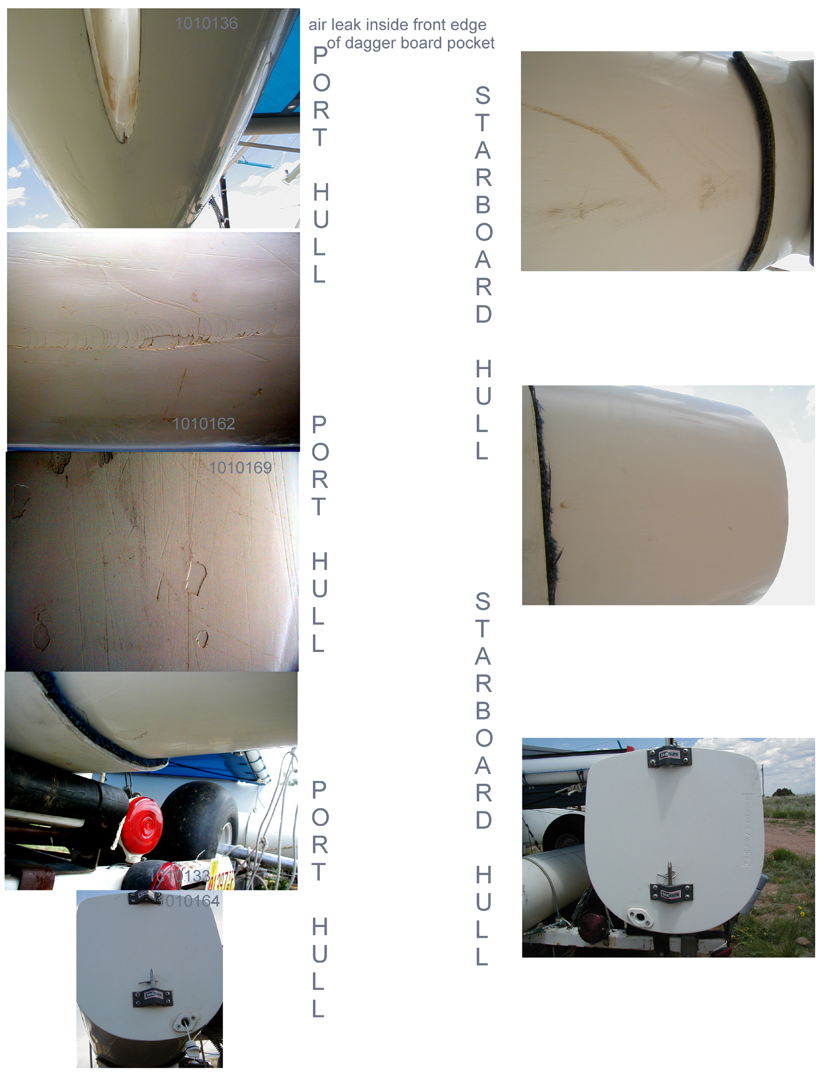

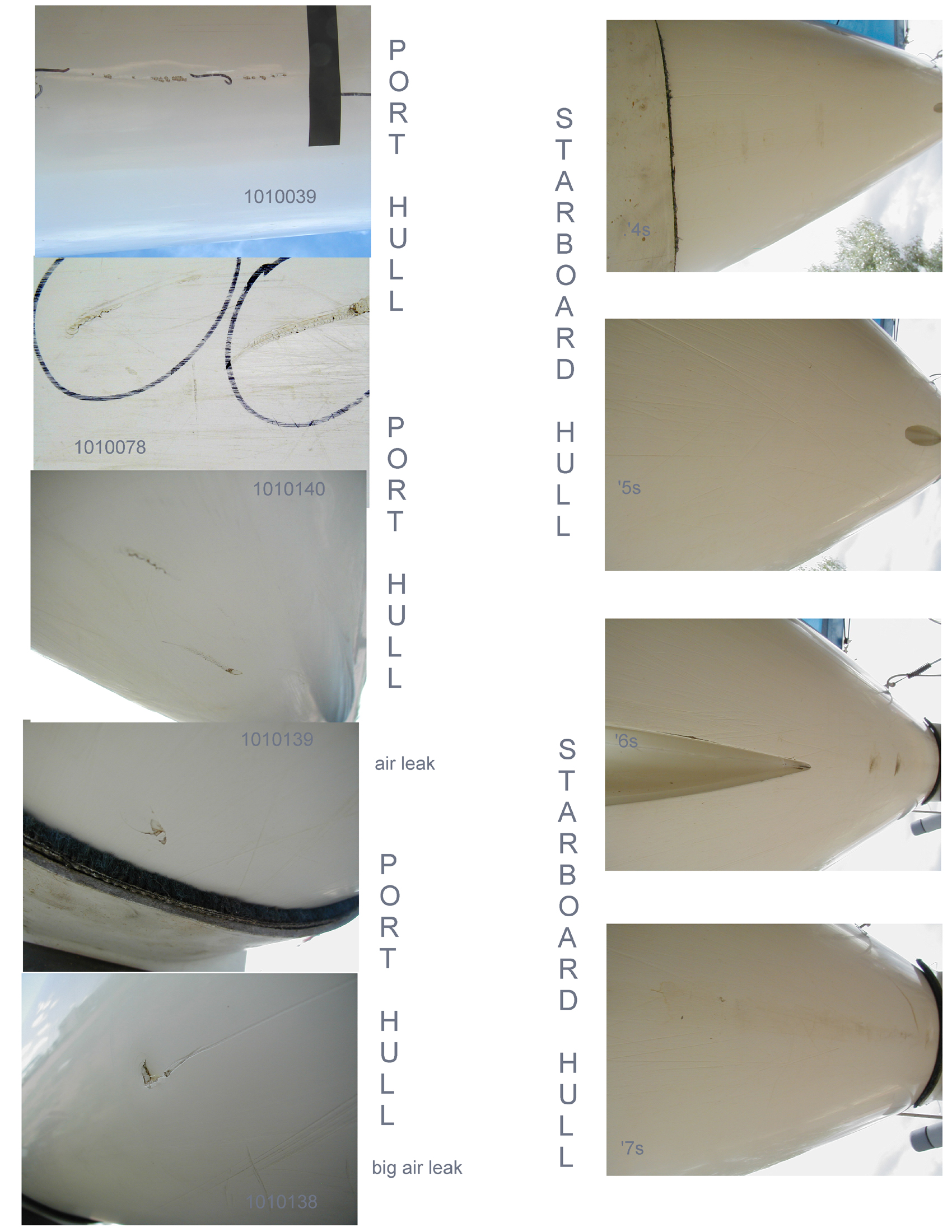

I'll attach photos of the hulls. It may take 3 posts to get them in as they're about 1.6MB each.
Will

Re: Trouble In Paradise - 11/12/07 04:31 AM
Photos, page 2
Posted By: WillLints
Re: Trouble In Paradise - 11/12/07 04:33 AM
Photo, page 3

That boat has taken some serious abuse!
It's a lightweight racing boat for crissakes. If you needed a boat to take that kind of abuse Will (and no disrespect intended) you should have gone for something rotomoulded.
While I'll admit that the differences between port and starboard hulls might be somewhat puzzling, it could be simply down to prevailing wind dir where you sail, particular route always followed out of the water or sundry other reasons.
Bottom line though? I wouldn't expect ANY make of GRP or epoxy boat to take the sort of abuse that those photos show without problems (and I'll include an H16 in that statement, even though you've got one). I just wouldn't choose to abuse a boat in that way. I have sailed on and off rocky coastlines, shingle beaches, concrete ramps etc. and my boats always touch only the water and the trolley - nothing else.
If you have a concern over the construction of one hull over the other then surely discuss that aspect with VMW, even have the construction reported on (you'll have to cut a section from each hull). But to blame VMW for the damage evidenced by those photos is IMHO plain wrong.

I am sorry, but I have to agree with John. Sandwich construction buildt light enough for a catamaran need to be treated carefully. Hitting rocks or letting waves and wind pound the boat on rock or concrete will ruin the laminate and make repairs neccesary. You can park the boat on a sandy beach, with care, but the boat should go directly from the water to the beachwheels.
A 5 - 7 lbs difference between hulls isn't that much. It can be caused by a lot of things. I would not worry overly about it knowing that advanced sandwich construction need aircraft grade quality systems to produce identical parts. We would not be able to pay for aircraft grade quality tough..
If I was you, I would have the boat repaired (not impossible at all, just need to let it dry out) and moved on. I am sorry to hear your story but hope you fix the boat and continue sailing it.

Will your photos clearly show that the boat was subjected to punishment outside the design criteria of a High Performance composite Race Boat.
It is fortunate for Vector works and Matt that you posted the series of pictures. Hopefully they will put to rest any accusations of poor quality or non responsiveness.

I agree with all the previous comments, look after your investment. Running it aground is not looking after it.
The only thing that looks a little suspicious though in those photos is what appears to be the outer layer of gelcoat chipping off to reveal an inner layer of gelcoat. I would only expect 1 layer of gelcoat and if a second is required for whatever reason, it will be preped properly to ensure a good bond between layers.
I had a dinghy that got scratched up on one side more than the other. A cat with widely separate hulls will also experience assymetry with regards to damage.

Well Gang, I agree that I should have been more careful with the hulls. Cat Trax are a bit of a hassle especially if the shore drops off quickly and the wind is blowing. Between the $500 Cat Trax and the $100 cradles I always worry about someone taking them while I'm out on the water. I bought 5 ten foot pieces of 2 inch PVC and 6 elbows and 6 T's. This will make 3 rectangular sliders, one 2' X 10' and two 4' X 2' . The T's are to have on opposite corners so that the frames fill with water and don't float away.
I know it's hard to believe that I wasn't crashing up onto the shore, I always got off and walked it up. I thought it was Kevlar and that something was wrong with the Kevlar. It wasn't until 2 or 3 weeks ago that I found that it was a super light fiberglass construction. I don't think I said, "give me one tough hull and one fragile hull". I started patching last fall with Marine Tex but when I air checked, the patch was still leaking air. I was having trouble getting the F16 to sail the way I thought it should, H16s where shaming me. I've never bought a new car, believe me when those dings started showing up I felt bad, kind of like being kicked in the gut. I just couldn't figure it out, why is this hull cracking, I thought it was suppose to dent. I thought it was Kevlar, I was afraid to sand on it, I had read or been told not to sand Kevlar, I thought I was going to have to have someone else fix it. I don't know if there is anyone in the state experienced fixing Kevlar.
By the time I stopped sailing it this spring I had gotten a pretty good handle on making the boat go, loving those broad reaches with spin. I hadn't gotten everything figured out but the de-powering controls made it so I could sustain and sail pretty fast in strong winds and still be stable (I'm 145 pounds). I was getting so I could set the spin in white caps and at the other side of the lake snuff it with out taking a bath. I had a lot of fun sailing it this spring, especially the four days with Andrew and Elizabeth and their Taipan 4.9 at Heron Lake. The water was in the forties, I think. Andrew grew up sailing Lake Michigan so water temp was nothing to him.
