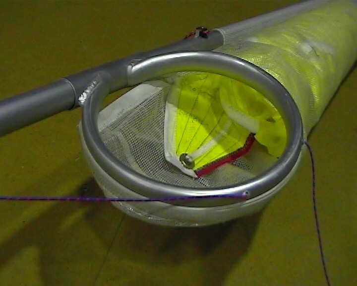

I just wrote to AHPC in OZ about their snuffer products and got a nice e-mail and a bunch of photos. With the pole too expensive to ship sensibly, the ring and bag cost $264 AUD which works out to only $190 USD. (See attached photo.)
This is CHEAP! Compare with the Guck site which says $599 for their midpole "Skunk" alone.
