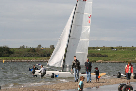

But I'm happy to be proven wrong by anybody. So guys who is up to building a full foiling catamaran under a fixed rule system and race it around the cans in a few different wind strengths.
The bruce foiling guys has already done that See picture.
