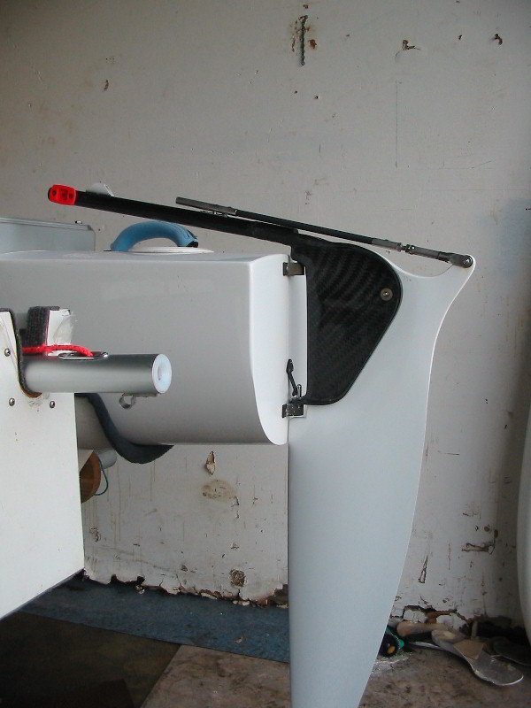

All the parts used in the rudders are shown in the picture below, there are no more parts, no spring, bungees or lines. There is just a one piece rudder stock the rudderblade and the rod with it locking pin a locking plate.

Pretty much the rod is a more or less flexibly glass rod with black heat shrink around it. The heat shrink is there you won't get any splinters in your hands. The metal ending near the rearbeam has a pin in it that falls into a hole in a stainless steel plate fitted to the tiller. This happens when the rudder is down. For the rudder to move up it needs to press the pin out of it locking hole. As the pin is straight it can't do that UNLESS the rod itself is bending giving the pin the angle of the vertical as well. So with enough force the rod bend a little allowing the pin to pop out of its locking hole, the rod is then unsupported and the rudder moves up further.
On my stocks I tighten the bolts a little so the rudder just jams a little inside the stock now I can disengage the rods and sail through to surf with the rudders down and full control. As soon as the tips hit the bottom the rudders are pushed up. Only a little bit of contact is needed for that. When the surf is a shallow as 0.5 mtr the breakers are behind me. I've been doing this for 3 years now and everything is fine. Only now you can see that a little gelcoat is rubbed off the very ends ot the rudderboards.
