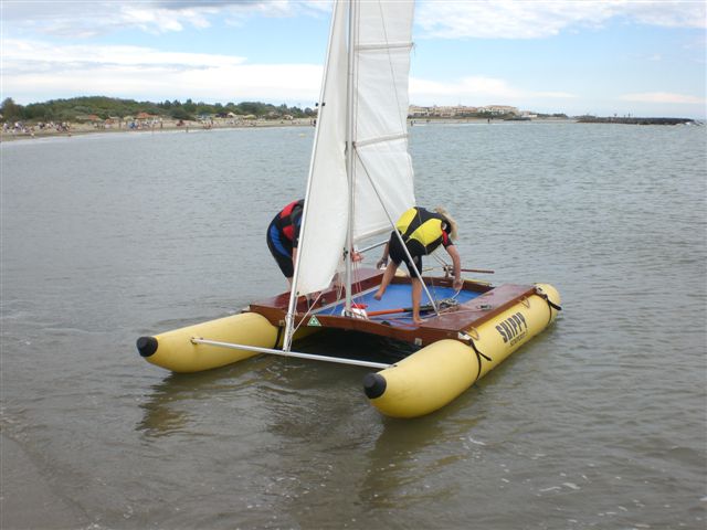

Just to give you all an update on the inflatable cat
I brought it along on holiday to the south of France and tried it out..
Perfect little boat, my daughter [and a lot of her friends] loved it.
The boat itself is very easy to sail -tack, gype etc, points reasonable high.
I recieved a lot of commets /questions while on the beach from people who were wondering were to buy/ what price etc.
construction....hmmm I must admit it is build very smart and could be an example for the F12 iniative over here on the forum. The use of wood is to much/ to heavy. I'm thinking of replacing the wooden parts for Alu tubing
all and all, very nice little boat
see attached pictures [I know my daugthers PFD is to big, when sailing alone she used here one, for the pictures she wanted to wear the same as Dad]

Looking at the pics more closely I see it has exactly the same rod rigging that was proposed for the F12's. What is you opinion on that. Does it work well, is it well enough away from to drew to not be a nuisance ?

the rods work quite well, they are not in the way of crew, actualy they guide the lines of the jib and provide a handle /something to hold on to, which is nice for the kids
please notice that there is a wire from the base of the rods to 2/3 of the mast, this is to prevent the mast from bending to much to lee side
The front jib "wire" is solid and provites support as well, both for the mast and for preventing the bows to bend. The jib itself slides in just like the mainsail on a "normal" cat.
