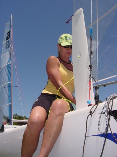

Now that's a broad oops I mean board that really appeals to me Wouter (especially the one in yellow)

Darryl,
Yep, I'll have one of those.

Whats that little nub about a foot or so down from the top of the board on the outboard side for?

Patrick,
Are taking about the recess in the board for the knot in the pull-up line which goes thru a hole in the board from the inboard side.
This should be about a foot and a half down from the head of the board.
The recess is just so the knot does not jam the board when it's in the case.
Re: Building an F-16 [Re: phill] #105113
04/30/07 08:41 AM
04/30/07 08:41 AM
thanks Phil. That makes sense. I didn't know these boards had lines to pull them up.
