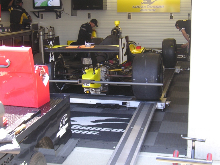

Hey, check this out! The Indy Car teams stole my tiller extension idea!
I never even realized an Indy Car needed a tiller extension, but we saw these in several garages, when the Wave Midwest participants went to the Indianapolis Motor Speedway on Friday. The mechanic working by the right front tire is a member of the Eagle Creek Sailing Club.
Okay, well maybe it's a part of the measurement jig they use to set up the cars...
