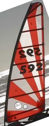

The F12 can take the standard laser-1 rig, it has the same surface area, luff length and mast height. The Centre Of Effort will be close enough to the intended F12 rig as well. However looks are important and the battened F12 rig is much more modern in apparence, trim and performance. See attached picture. Shown is a 5.5 sq. mtr. 4.7 mtr luff sleeved sail on a homemade aluminium mast. The intended F12 rig is just a scaled up version with the same surface area as the laser-1, as such it will be 7.00 sq. mtr by 5 mtr long luff. mast height will be 5.7 mtr. mast weight is just under 10 kg = 22 lbs
