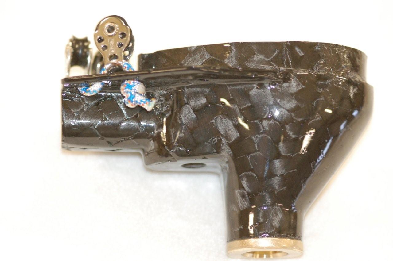

Re: Tornado Carbon Mast [Re: phill] #134241
03/02/08 12:59 AM
03/02/08 12:59 AM
Posts: 1,021
Australia
macca Offline
macca  Offline
Posts: 1,021
Australia
mast base [Linked Image]
