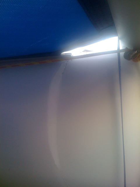

You can have a light boat, even one built without exotics. But it won't be as strong or as stiff as one thats built with high modulus materials.
I mention this here because I have been banned from the F16 Forum and there was an active discussion happening there until the moderators decided that it wasn't in the class' best interests.
no prizes for guessing what this boat is <img src="http://www.catsailor.com/forums/images/graemlins/smile.gif" alt="" />

Another pic of a lightweight boat... [Linked Image]

That kind of cracking does not just happen on lightweight boats. That same kind of vertical hull crack, aft of the front beam, happened to us on a Hobie 18. I, as crew, was out on the trapeze, and it was maybe a couple of minutes after the start of the race when all of a sudden the hull just started to split open right in front of my forward foot. Very unusual location for a crack like that.
We managed to get the boat to the beach on the same starboard tack, keeping the starboard hull as far out of the water as possible. (Still got full of water, though.)

Did you ever find out what caused the failure?

Such a crack will happen on any catamaran irrespectibally whether it is a 180 kg F18, 75 kg A-cat or a 18 ton Groupama 3 when an internal element like a bulkhead or subdeck comes undone or cracks due to production errors and no longer supports the hull skin.
As a result such damage has happened to pretty much any design out there in the world today and will continue to happen in the future. Boat builders are still not applying aeronautical or space-age quality control systems; as such these incidental mishaps are recurring.
More importantly is whether the company building/selling the boat takes responsibility and handles the warrantee in a proper way. That has always happened thus far.

Mary's right - I have seen a very similar-looking issue on other "heavy" boats. Showed up on my old Mystere 4.3, which could never be confused with a high-tech lightweight boat. Not nearly a fatal issue, either - it was a straightforward repair and was completely invisible when complete. I sailed the boat for another two or three seasons without recurrence.
In the right hands, boat repair is not a death knell for racing boats - I think too many boats are "totaled out" after collisions and failures. Effective repair doesn't necessarily mean significant weight added.
I have yet to see a F18 with such a failure. but to build a boat down to a very light weight and not use exotics will increase the chances of such a failure. Hence the Photos I posted of a F16 with catastrophic hull failure.

Macca, you did not say what brand of boat that was, and where, when, and how it happened.

I could give the details but then I would be accused of picking on a particular class...
They know who they are and they also know my position on their boat weights and current class rules.
