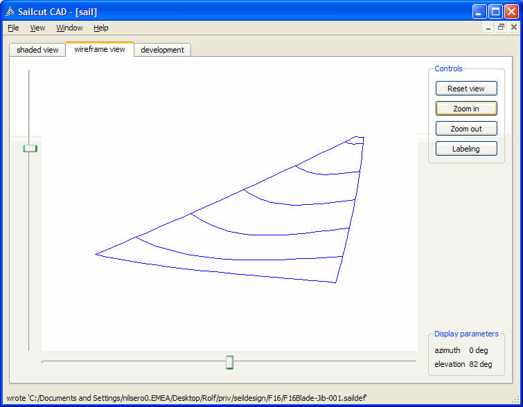

Here is a first go at a jib, just to let you (and others who are interested) have a look at the mid section profile.
Could you measure luff, leech and foot length of your current jib? Also, could you fold the sail and measure luff curve for both position and amount? By folding I mean that you fold the luff back over the cloth once, and then fold the luff forward again so you can measure hollow against the straight fold of cloth you have got. If your jib is in a stiff laminate cloth, this might be hard and using a straightedge or a plank might be easier.
A word of warning, you would be sailing with the prototype as we are not ready to do the sails yet!! Perhaps better for you to wait until we have launched and done a couple if iterations of the design.
Software used is SailCut, which is available here: http://sourceforge.net/project/downloadi...xe&78816830
If you want to play with the datafile, I can post it as an attachment here.
