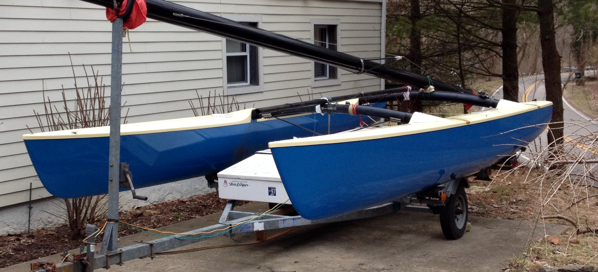

I'm now about 3 weeks out from actually sailing my Hobie 21 SE
Holding off on my plans to convert the Tramp.. to a hard deck.
Instead i found a Guy with a trampoline in his back yard, who
let me learn to walk on it ; so i Duck-taped up the sharp objects
on my Fakies and learned to stand on this surface. NO Flips ! HA !!
The Rear cross-beam i cut in half because it was stuck and couldn't get
my new toy home from Northern Cal , is spliced with an inner sleeve of
3" inch 6061-T6 alum with a wall of 3/8" + a Glass/epoxy spacer.
If any bending is noted in the
near future then i can wrap a 3oz glass on the X-beam to act as a dissimilar metals
barrier then wrap 10oz Stitched carbon (+ - 45) till it has a 1/4" wall. that would be WAY stronger than
stock. I kinda think my 21" inner splice will work Fine.
Trailing with a 9.5ft wide package may be fun ---------------------NOT !
The traveler will need some thought.
I found a some-what decent fabric to make New tramps for me Hobie ;
so next i break out my sewing machine & I'll show pictures of how it turns out ...
Good or Bad. Anyone use this fabric before ? :
http://www.sailrite.com/Trampoline-Mesh-Soft-White-63#
Hopefully i can use the same for my Wings as well.

Would you happen to Know about how many gallons of water
the Mast Float will displace ?
I can't afford a new one so i'll need to build my own.
I Don't "Want" to flip my 21-SE but Do Want to be ready
if/when i do.
Making molds is Fun ; need to mold my center-board because
one is Good and one is Toast.
Same with my Rudders ; one Good , one Bad . I'll have
TWO Carbon ones for, (cheaper than one new) ; once the mold is made. Can
paint the mold with a surface coat on the part that is a LOT
lighter than Polyester-gel-coat ! Too bad because i Like
that black carbon look but can't use it at Mohave where the temperature in the shade is 113F
Bille

That looks like the boat from Eureka. Great boat if it is.
