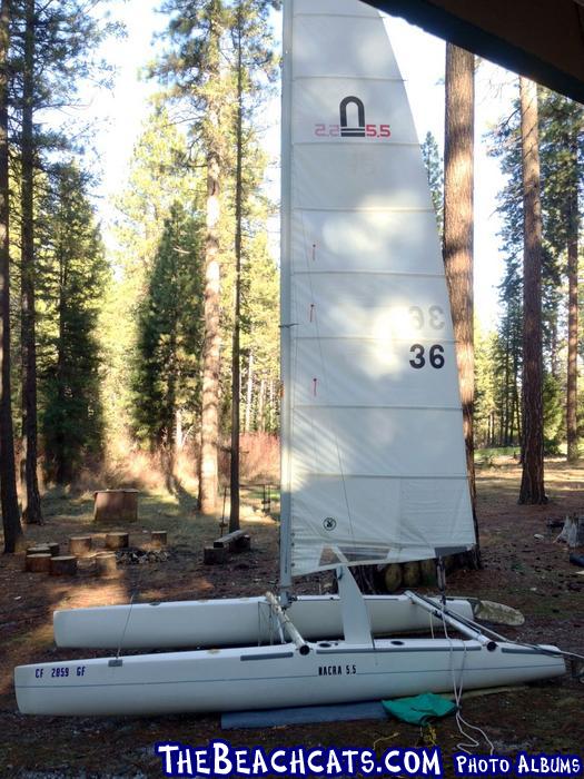

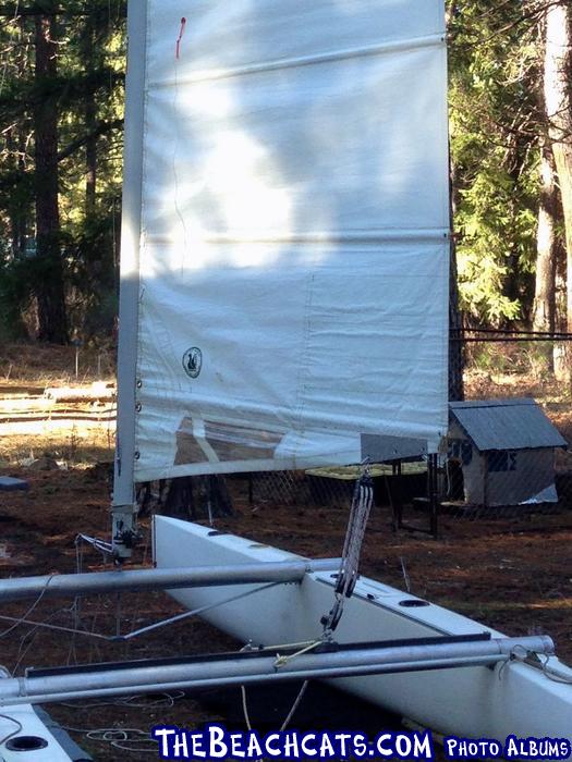

Update: I've been busy! I built my new beams, and assembled the hulls, along with finishing the trailer. No tramp installed yet, and need to overhaul the rudder assemblies. First test today putting the mast and sail up, checking the stays were the right length and all my calculations add up (they did!). Very exciting to see it come this far!
One concern - with the sail up I noticed the old adhesive outline of a removed sail marking that reads '18s' (as in 18 square). You may be able to just make it out in the photo, below the Nacra logo and the red 5.5 numbers. So my 5.5 uni, made up of 18sq hulls, with previously chopped down 18sq beams, may now also have an 18sq sail?! I guess I don't really care what we should be calling it, but I would like to know if it truly is an 18sq sail, and if so, how that might affect the boat on the water. Bigger sail area comes to mind, with added power, but not sure if this will change the handling adversely (besides the extra healing moment). The mast is 29'6" long (excluding casting) and the sail seems to fit it well. I know early 18sq had a boom, then they went to boomless. This sail almost looks like it was made for a boom. Perhaps the silver colored clew plate could have been added later?. Even hooking my mainsheet to the most inboard hole of the clew plate, sheet tension isn't pulling outboard enough, and the foot of the sail won't tension properly. On the most outboard hole it looks just ridiculous - the foot of the sail has a giant flapping belly in it. I know the rear beam/traveller is meant to angle slightly forward on boom less, and slightly aft on boom rigs, but I don't think that will fix sail tension the way things stand. Any thoughts appreciated. Is it a 5.5 uni boomless sail, or 18sq boom/boomless sail? Issues?

You are correct in that this is not nearly enough angle on the mainsheet for a boomless rig to function properly.
Hmmmm. That's what I am thinking. *sigh*. So, does this frankenstein of a boat need a boom added to it now? The sail is quite nice. Do you think the mast is also from an 18sq, or were they the same as the 5.5 uni? (this mast is 29'6"). If I recall correctly, the 5.5SL mast is a little shorter than the Uni, but don't know the specs on the 18sq masts.
