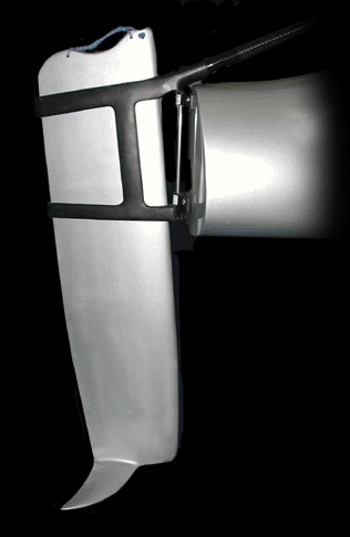

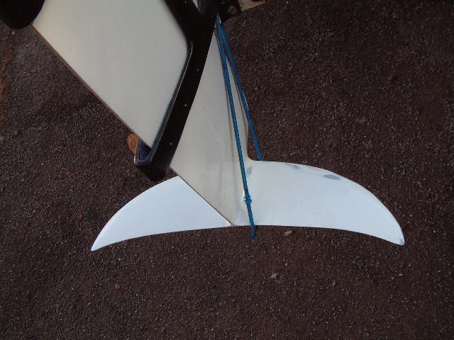

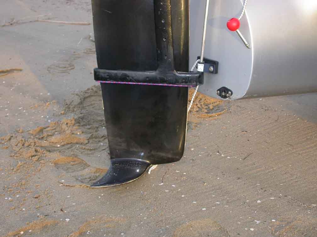

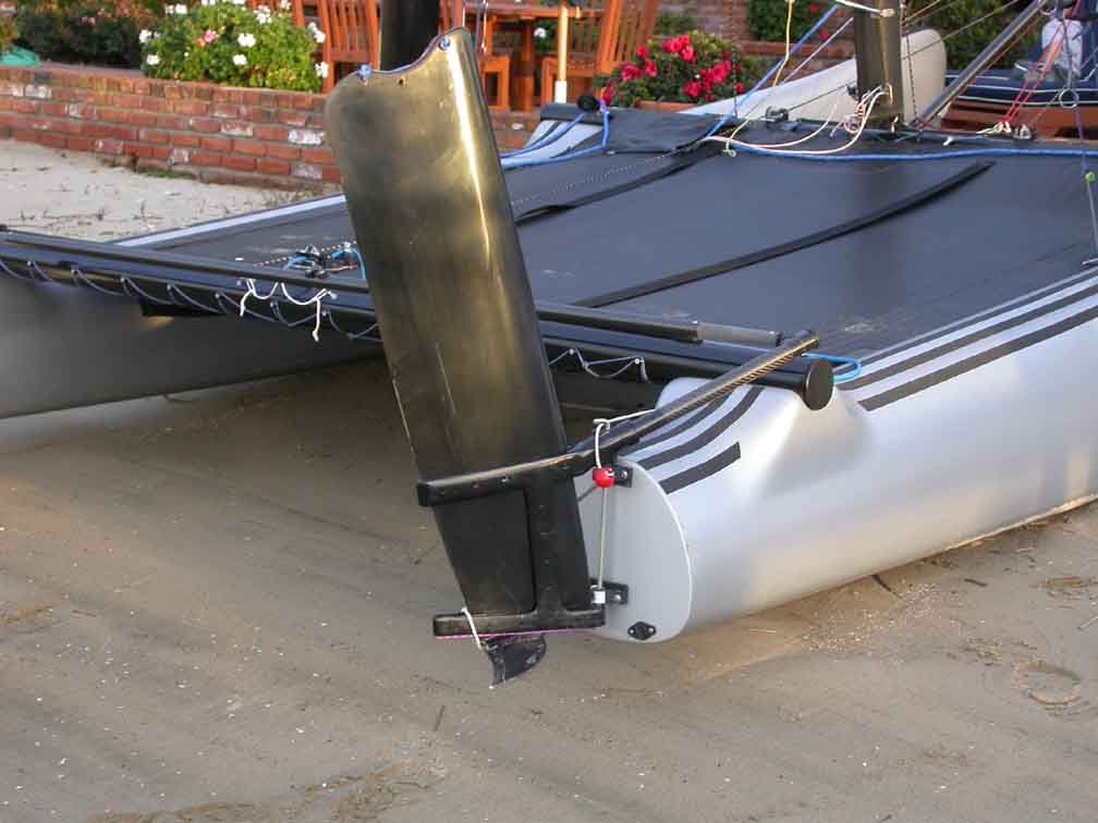

Pictures of T-foils on rudders [Re: Marcus F16] #45386
03/06/05 10:49 AM
03/06/05 10:49 AM
I too am very keen to see some photo's of the T-foils
And here you have them :
Note the white foils are of 2002 the Black ones are newer and more faired.
And now for a work of art !

Pictures are all of Stealth F16's; The white ones are off a UK based boats and the Black ones are off a US based Stealth F16 in California. Of Mark Talla. Eric Poulsen took them when he went up there for a sail in 2003 I believe.
There are quite a few T-foils in the F16 class at this moment. Currently all on Stealhs but a large portion of all of the Stealths produced have them. The other builders (except VWM) have looked at the setup and even had a test sail with them. I don't know wether they will go for the T-foils as well, maybe Marcus will. I personally still have to test sail these but that is planned for this spring at the Dutch Stealth Agent.
All very exiting.

I've posted a few pictures of the T-foil rudder system in reply to your request. The foils on the stealth are much smaller than the I-14 because their function is a little different. The F16's are not as nervous as the 14's and more control can be left to the pilots. To foils on these cats only slow down the undesired movements to a level where the crews can adjust the trim in a comfortable way. That is all that is needed. Any excess funtionality will only lead to unnecessary drag and level-off the peak performance of the craft. Everything is a trade-off and one can loose as well by overdoing on a good thing. I really don't there is any benefit to large surfaces as the F16's are more controllable in basis and don't have to fear a wipe-out as much as the little skiffs.
