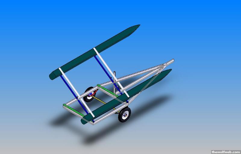

Re: New Trailer? [Re: DavidHarkness] #45823
03/14/05 08:45 PM
03/14/05 08:45 PM
Related to your "building my own trailer"
I designed my own tilt trailer when I was in the market for a tornado. Never bought the boat so I never built the trailer, but designing a trailer is pretty simple. I actually found a book in the public library that walked me through all the "technical" aspects of trailer design. Can't remember the title now, but modelling it in solidworks was easy enough:
