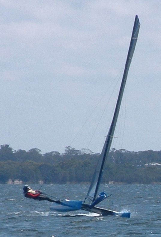

Going back to the subject of sail twist with the fat top sail, I just found this recent photo of Gary on Altered.
What does everyone think? Right or wrong? Could he make this leech stand up? Would it be possible to over sheet it? Gary should be able to tell us from the mainsheet blocks, whether he has it sheeted in or not here.

Hard to tell without seeing telltales. I reckon it's under-sheeted, but I'm a n00b to cat sailing...

Hi Tim,
As usual, a great photo of Gary styling on an awesome boat.
I think that he looks pretty much sheeted in max there, looking at the blocks. Most cat mainsails are designed with a certain amount of twist built into them, so if your leech stands up all the way to the top, you are in effect oversheeting the bottom 2/3 of the sail. I`m certainly no expert here, but from what I understand, twist is good, not only to depower the sail, but aerodynamically as well. Something about the wind higher up flowing faster than lower down, or at a different direction, whatever. Maybe the aeronautical engineer`s who visit these forums can explain it.
Looking at modern windsurfer rigs, the sail is designed to have quite a lot of twist, so much so that when you look at the sail on the beach, the leech is floppy, this depowers the rig before you have even sheeted in, but also has the effect of creating a large amount of twist. Now why would they do that if they could rather rig a smaller sail and have the leech stand up straight, it would still depower in the gusts due to the flexible mast. The answer must be that a large sail with a twisted off head is faster than a smaller sail with a straight leech. Perhaps in cat-sailing this is all different, maybe too much twist will hurt your pointing ability, but if your speed is much better you might still be first to the weather mark.
Just my opinion, so all those who have a degree in aircraft or sail design, feel free to straighten me out.

Mmmm, very interesting. The theory I have running around in my mind right now is that as the boat pitches and accelerates/decellerates over/through waves causing the sail to move back and forth through the wind, the apparent wind moves forward and aft very quickly, say through 10-20 degrees for every wave that is encountered.
So you need to be able to change the sheeting angle of your sail to obtain the maximum thrust from this ocsillating apparent wind. As the boat pitches backwards the apparent wind shifts aft a bit and as the boat pitches forward the apparent wind shifts forward a bit.
Changing the sheeting angle is very difficult, or impossible, to do fast enough on many boats. So another technique needs to be developed to allow the sail to operate efficiently at all these different angles of attack very quickly. Dinghies do it by pumping and "bouncing" the crews body weight through waves, although it is illegal, as this moves the rig towards the wind and counteracts the apparent wind moving aft as the boat/sail is pitching aft.
Cats don't tend to operate the main much upwind so a different technique has evolved, big head mainsails with the right amount of twist, not too much, not too little. With the right amount of twist, the sail will "on average" operate more efficiently as different sections of sail at different heights change between being highly efficient and then inefficient. So while one section at the top may be operating poorly, a section at the bottom may be operating highly efficiently. Then when the boat pitches the other way the top will start operating highly efficiently while the bottom operate poorly. But on average, a correctly twisted sail will operate better than an over-twisted or under-twisted sail. This all depends on the conditions ofcourse, if there are no waves, more of the sail can be in the best position more of the time.
The first principle to get straight is that the apparent wind oscillates/rotates across the sail as the boat moves through waves. A cross section of a sail works best (produces best thrust) at one angle of attack. Twisted sails have many angles of attack to what is referred to as the steady wind direction. All of these sections up and down the sail at sometime during the oscillation of the apparent wind, due to pitching, will be at their most efficient angle of attack to produce thrust. This means that the centre of thrust is actually moving up and down the sail with each pitch. Over time, this thrust will add up to be more than is produced buy a sail that is setup with too much or too little twist since both these scenarios have a section of sail that will rarely operate at its most efficient angle of attack.
This might explain why it is a common indication of a correctly twisted main that the top leech telltale should be flowing about 50% of the time. The top section of sail is only operating at its best angle of attack to produce thrust about <50% of the time (telltales will stream slightly either side of best angle of attack though). While the top section is operating poorly, the other sections of sail are operating efficiently. Imagine the apparent wind angle as it moves up and down your sail. It will tend to slowly move forward as you go down the sail and will tend to move aft as you go up the sail.
I might be a nerd and crunch some numbers later to see how much the apparent wind will rotate at the head of a pitching sail. That will give an indication of whether or not my theory is correct.
How this relates to square head mains may be that the sail area is distributed more evenly up and down the sail so the instantaneous thrust is pretty much the same during the tiny oscillations.
Be careful with my terminology, I have used rotate, move and oscillate interchangeably with reference to the apparent wind angle throughout the post depending on the scenario I'm trying to explain.
Excuse my long sentences, I wanted to get it out quickly before I forgot it.
Can you actually get a degree in sail design? I know it's a craft where you can be an apprentice and do a masters test when done as apprentice. But can you go on and do a degree on saildesign?
As for wind shear, it depends on what kind of wind you have, stable or unstable. My literature suggest it can be quite pronounced (25deg) even in the height-range of catamaran masts (I have never experienced it so pronounced). It can also be as small as 2degrees at your masttop. (Ref: David Houghton and Frank Bethewaite). What you are thinking about is probably how friction between wind and earts surface, and earths rotation (coreolis effect) wil influence the wind. Short version is that becouse of friction between the wind and the surface, and becouse the earth rotate wind further up will have a different direction than closer to the surface. As earth rotates in the same direction all the time, you will need less twist to compensate on one tack than the other.
My experience is that twist is beneficial in some conditions, but should be avoided in others. When overpowered (as Gary looks to be in the picture), twist is good to shed power and eliminate form drag. Twist is also beneficial when powering trough waves or accelerating. In flat water, looking for power, I feel faster with less twist. This will increase power (again, depending on wind shear), but also increase form drag from the sail.
Sloop rigs need to twist their mainsail to compensate for the jibs influence on the wind. On our Tornado main we have used 8 degrees of twist, and I think it's a bit too much (might be a problem with cloth stretch and luff curve). I have also heard that 11degrees of twist are designed into Tornado mains. For a uni rig, I would expect less twist designed into the sail. But how it's trimmed on the water is what decides how fast it is (unless it is out of the ballpark).
When trimming windsurfer sails, it's critical in my experience to have the correct mast for the sail. I trim downhaul until the leech just goes slack when looking for power with it. In stronger winds, I put on more downhaul to keep the sail manageable. With the wrong mast, your leech will go slack to early, or overpower you completely
The main 'brakes' you can put on when sailing cats are form drag from the sails. If you go out in 0-1m/s winds, wind shear will probably be pronounced , so you need twist to power up the top and keep the telltales flying. You have probably also heard that in weak winds you need deep sails to make the boat go. So, how do you induce twist while keeping the sails full? You let out on the mainsheet. That way you will have a full sail and decent twist. If you have tried this, you know that you will not go well to windward and be slow. If you crank on the downhaul and sheet in (still fly the leech telltales 50% of the time) to flatten the main, top will twist off while the lower part of the leech still stands. What you really have done, is remove a large part of your sails form drag as the wind dont have to move over that deep curvature (and probably detach from the surface underways) but instead follow the much more efficient shallow curvature. If the wind increases, you can trim your sail deeper with less twist as the increased power generated by the sail is larger then the added form drag.
Sorry for the rambling.. I just find this stuff very interesting.

Firstly Altered picture, I was sheeted hard at the time, basicaly as much as I can pull on with 6 to 1 from trapeze. Twist is all from downhaul or cunningham, Glenn advised me I was not using enough, so I upped to 12 to 1 and can now give it heaps. Basicaly I sheet in hard then adjust downhaul so that I am pointing at the hieght I want and travelling at the speed I want. The twist in this photo gives better VMG than when I was sailing with less twist causing me to point higher. When I got this sail I underestimated how much and how early I needed to start downhauling. I am now back to being happy with my upwind speed in stronger breezes, although I do still need to check it against some faster cats.
