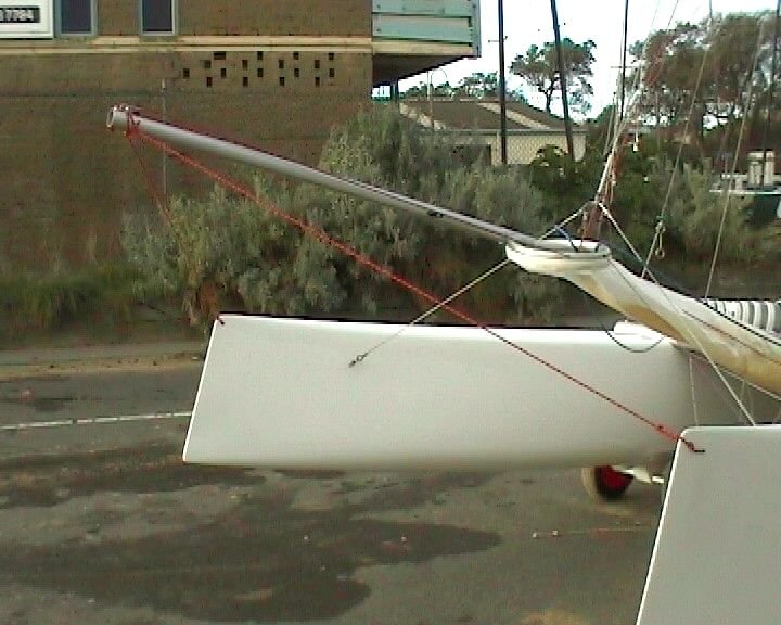

The spin does look lower than the other NF18s. Some boats use a compression strut that runs from the point of bridle/forestay attachment to the spin pole. See attachment. I guess this would allow for more spin shapes that still fit within class rules?

Another pic of the strut. The infusion looks like a very cool boat.

I wondered when someone was going to figure out how to get the spinnaker pole lower. That's a neat attachment of the bridle wires...not on the upper edge of the deck but down the inside of the hull.
Those someones where Martin Fisher and Greg Goodall when it comes down to F18's. They figured it out in 2003/2004 with their Capricorn F18; see picture.
Sorry mates, that feature is not new. Actually I the idea is alot older then that as well as the KL catamarans had it back in the 90's already.

We now have a Landy kite on the Capricorn which is longer in the luff than the Goodall.
Our pole is about 6 inches lower at the bridle than this one. Because it is so low, we added another bridle (spectra) from the pole to the bridle chainplates just like the Tornadoes.
Yesterday I raced a Marathon and set the Capricorn up with my Tornado kite. Pole tip was level with the bow and had to raise the halyard pully slightly. Looked mean. Some serious depth down wind too....
