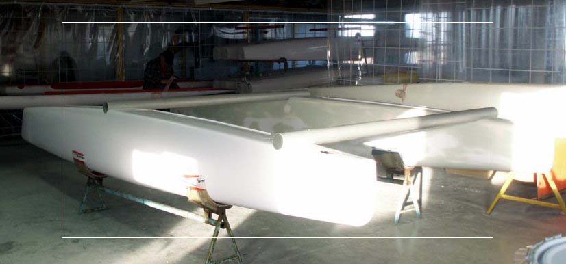

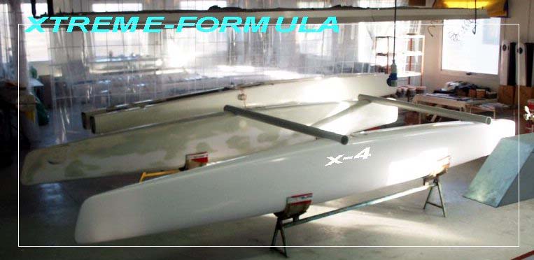

The first BIMARE 4-X is actually near completion.
The first testsail is expected in two weeks (the photos below were taken on January 25).
The proto is fitted with 100 mm diameter round beams.
Two different masts will be evaluated (both with a 157 x 74 section): a softer version weighting 2,030 gr/ml and a stiffer version scaling up at 2,250 gr/ml.

Actually, don't worry. I can do these in Ulead......
Doesn't look as though it's got much rocker, does it? Interesting shape though, be nice if it goes as quick as it looks.....

it looks upside down.

I reckon that this one looks quick on flat water, but in the lumpy stuff, they may want more rocker. This is where the Tiger has always done better than the Capricorn and previous Nacras. Hence mega-rocker on the Infusion.
