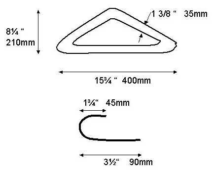

And here are the dimensions.

Be sure you have the room for a Mossie-style snuffer mouth. My bridle angles do not have the room under them without lowering the spin pole too far. I guess the Mossies have a higher bridle joint. Note the dimensions on Tim's post.
