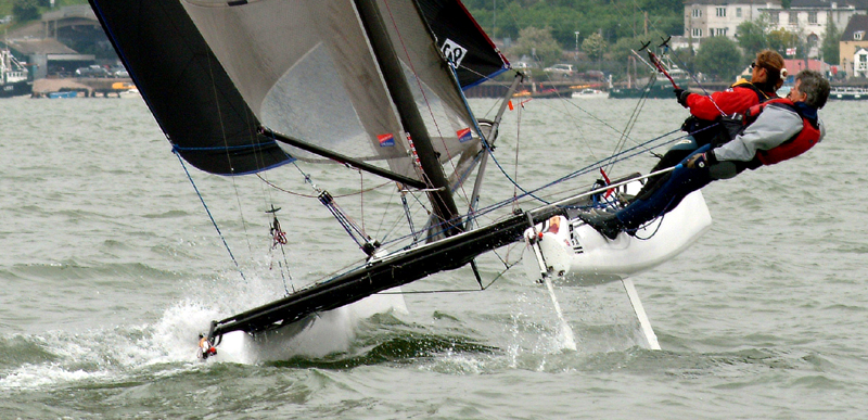

I make no apologies for showing off this pic of Anne and I out practicing last weekend with the new spin. I like this pic so much that I'm having a 3ft long framed version for our dining room wall.........
It was a brilliant day for sailing and we really got to grips with the shape of the new kite. Also Anne seems to have finally overcome her 'fear of flying' and thoroughly enjoyed the 'screaming' broad reaches! <img src="http://www.catsailor.com/forums/images/graemlins/grin.gif" alt="" />
Next step: get Anne to trapeze lower and with her feet closer together!!

John,
Nice pic. ANd good job getting the other 1/2 out to play.
One question. Is it a trick of the light, but it looks like the foot of the Kite is VERY full and there is a hell of a lot of "return" in it, almost like it needs sheeting a little further back ?

Simon, I think it might just be the angle of the photo....

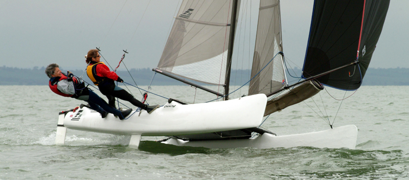

Here's the reverse view:
I suspect that some of it is that Anne doesn't have enough 'grunt' to be able to really sheet the kite enough for reaching. We've also been playing around with luff length/hoist height and since this photo was taken we've taken another couple of inches of slack out of the luff which changed the flying shape quite a bit.
Grant Piggott built this kite for me based on the latest T spins. It's very different to the Landy spins that I've been using but seems to have loads of power and be quite stable.

John, re. the "grunt" required to sheet the spin, from the second photo it looks like the sheet is running directly from a single block at the shroud to her hand. If that is the case, you could mount another auto ratchet block on the forward beam, one for each side, that is how we do it on the Inter 20's and we have lots of girls crewing them, all with enough grunt to trim in all but extream conditions. I ran double auto ratchets (one on the shroud, one on the beam) on each side, so with every jibe they would release and not hang up the lazy sheet. I usually had my 10 yr. old son trimming, or I could do it with one hand, on a 260' I-20 chute.

No Timbo, the sheet runs through a harken ball block at the shroud, forward to a carboratchet on the main beam and then out to the crew. Anne is just a 4' 11" wimp! <img src="http://www.catsailor.com/forums/images/graemlins/grin.gif" alt="" />
We've actually discussed putting a second autoratchet in place of the harken ball block, so I guess that's what we'll be doing.

Ahh; always the grunt thing when reaching!
Still looks from this pic that the sheeting angle is quite high. How would you compare the kite's of Landy and Grant (gran built my last 2 kites for the 17 BTW)

Yes, the double auto ratchets make a big difference when the wind is up. When you are setting the spring tension, make sure you put the beam block on heavy tension and the shroud one on light, so on light days you will only be clicking one block, not two and when you release all pressure, the beam will release, even though there is still tension from it to the shroud block, otherwise it won't freewheel when you release the sheet and the gybe will be ruined....not that I've ever done that.... ;^0
