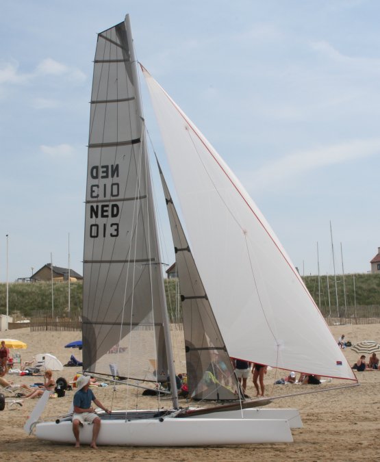

Here another picture [Re: Wouter] #77903
06/19/06 02:54 PM
06/19/06 02:54 PM
Wouter Offline OP
Wouter  Offline OP
Summary :
Blade F16 build by VectorWork Marine and imported by www.catamaranparts.nl
Mainsail and jib by Glenn Ashby of www.ashbysails.com.
Mainsail was cut to best suit a 135 kg combined crew weight
Spinnaker by Andrew Landenberger of http://www.landenberger-sailing.com/

That kite looks like it's got a looong luff--true? Is it speedy?
My kite is getting a lot of holes in it since it's from '03, so I've got to get a new one soon.
That is true. it doesn't have a much margin at all. We really needed to make the bowlines small as possible else the luff would be slack.
Is it speedy?
I want to do more testing, but the first test was succesful, it was easy and fast then.
I'm on the same trajectory. I don't have to many holes in it but the cut is not entirely correct leading to high sheet loads that my 58 kg crew doesn't really appreciate. Neither do I when singlehanding. The Landenberger spi is definately better in the respect and so I'm seriously considering a new spi as well. That is why I was so interested in testing this spi.
For now I'm still looking to order a Landenberger spi. I liked his spi design for the Stealths, it was really good there and I like his Blade spi design as well. This gives me more assureances that he can make a proper spi for my custom Taipan F16.
But hopefully I get to test it a few more times in different conditions before I order.
However I will ask for a few more centimeters of luff margin.

From the photo's it look like the Blades Spinnaker pole is way longer than what the F16 Box rule allows, has any one run a tape measure along them as it will really affect the luff length and hence the type of cut you can have on the sail and ultimately the performance as the sail will become more and more like a screacher rather than a spinnaker.
Re: Here another picture [Re: waynemarlow] #77911
06/20/06 04:27 AM
06/20/06 04:27 AM
Wouter Offline OP
Wouter  Offline OP
From the photo's it look like the Blades Spinnaker pole is way longer than what the F16 Box rule allows, has any one run a tape measure along them ...
Ohh no, not that discussion again.
I can assure everybody that the poles lengths are full compliant with F16 rules. The Dutch buying group has been over this one several times.
These poles may well appear longer as the earlier F16 boats like the Taipans (and also my own boat) as they only used 3.25 mtr long poles. They were all allowed 3.50 mtr but the way Goodall cuts his spinnakers makes it better to have the tack out at 3.25 mtr then at 3.50 meter. On the Taipan is also better to have 3.25 mtr as that will maintain a good balance on the helm. The newer boats of course could adjust the hull design to make full use of the F16 rules and they did.
But to keep you guys happy I will measure the pole length of this particular boat tonight. I have to go to the beach anyway.

Its not the length ( as all good girls would say ) of the pole but how much it sticks out the front of the hull, most newer designs seem to be getting the main beam further and further back in the hull which makes the pole length irrelavent according to the box rules.

The pole length is 3,5 mtr's and because of the angeled nose it looks longer in front of the boat but that is only the look. The pole is in front of the nose about 825 mm.
We measured it during assembly.

I was about to reply to you last post but I see that you have discovered the fault in your own line of thinking.
Indeed, an important parameter is how far the luff of the spi is in front of the mast. By ruling on a max pole length this measurement is always the same and so too performance. The same measurement together with the gate high measurement (also a fixed length) fixed the luff length of the spi which is the only other important parameter of spi performance. Therefor these two rules are very effective in forcing all spinnakers to the same performance. That is unless a builder decides to use a shorter pole then allowed by the class rules. But that is a private decision.
I'm also very happy that we have done away with that complex pole length rule that F18 rules and Texel/ISAF use. That was both a performance equalizing nightmere as well as impossible to explain to most owners/builders.
