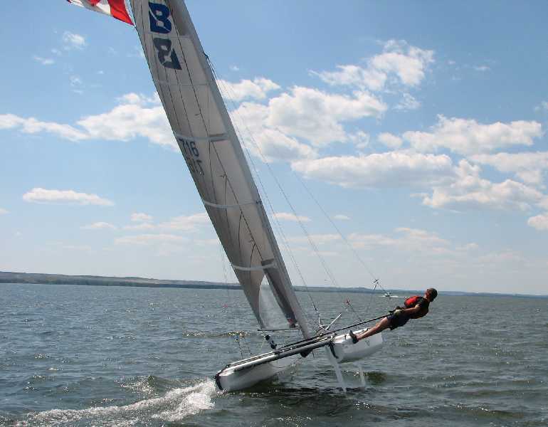

I saw the camera boat so I thought I would go Hollywood.

Very nice! I take it you are pleased with your new toy?
How did the first blast under spin go?

I am "pleased as punch". The first spin runs were a hoot. The day started out still, but at 2:30pm the wind came in at about 8kts with a lot of puffs and shifts. I tried to contain myself and keep her deep but did go hunting for the power a couple of times. Got the hull up but didn't start hiking or trapping downwind. Baby steps.

You know Bruce, I had the old style mainsail, now I have the same one you have. I noticed this new mainsail loves to be block to block, even in lighter stuff.
I am considering running less rake.
HMMMM! anyone else got any suggestions? maybe this should merit a new thread?
OH and pictures are SWEET! got any high resolution images, I want to make a new wallpaper for my pc. <img src="http://www.catsailor.com/forums/images/graemlins/grin.gif" alt="" />

Very nice, Bruce.
I've stood my mast up a bit to get rid of some weather helm. I cannot get my blocks that close (in the pics) anymore. The boat feels well balanced and it hasn't seemed to hurt the pointing ability. I am still tyring to figure it out, though.

I'm on the third hole from the bottom, and have a little more weather helm than I'd like. I don't think I can get my blocks that close either, and I've got an extra snap shackle on there.
I'm going to try standing the mast up a little more, and I'll measure it with the trapeze to compare.
