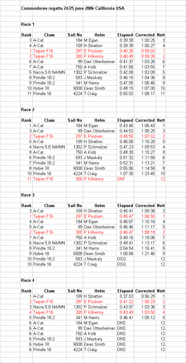

The results are at www.catamaranracing.org/results/commodores_06.htm - There's no internal link yet, we're a little behind on updates ...

Just to keep everybody informed, here are the results ordered to elapsed time.
Lets chalk this one up as another example of where the F16's hang with the A's around the course.
Doc (Eric) and Paul are doing very good stuff over there in California !

As if those tall customized (to skipper weight) carbon masts, extremely high aspect mainsails (long luffs), glued-in carbon beams, stiff full carbon hulls, angled daggerboards and 35 to 75 kg less overall weight don't account for any unfairness on their part !
I dont think this paragraph is fair nor reasonable.
Wouter you were instrumental in limiting or banning all these in the F16.. The exception is the weight clause.
Sounds like your initiatives are the ones you are upset about..
